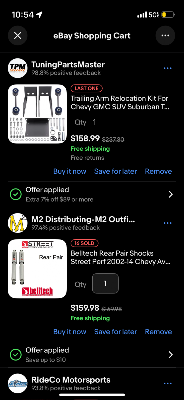

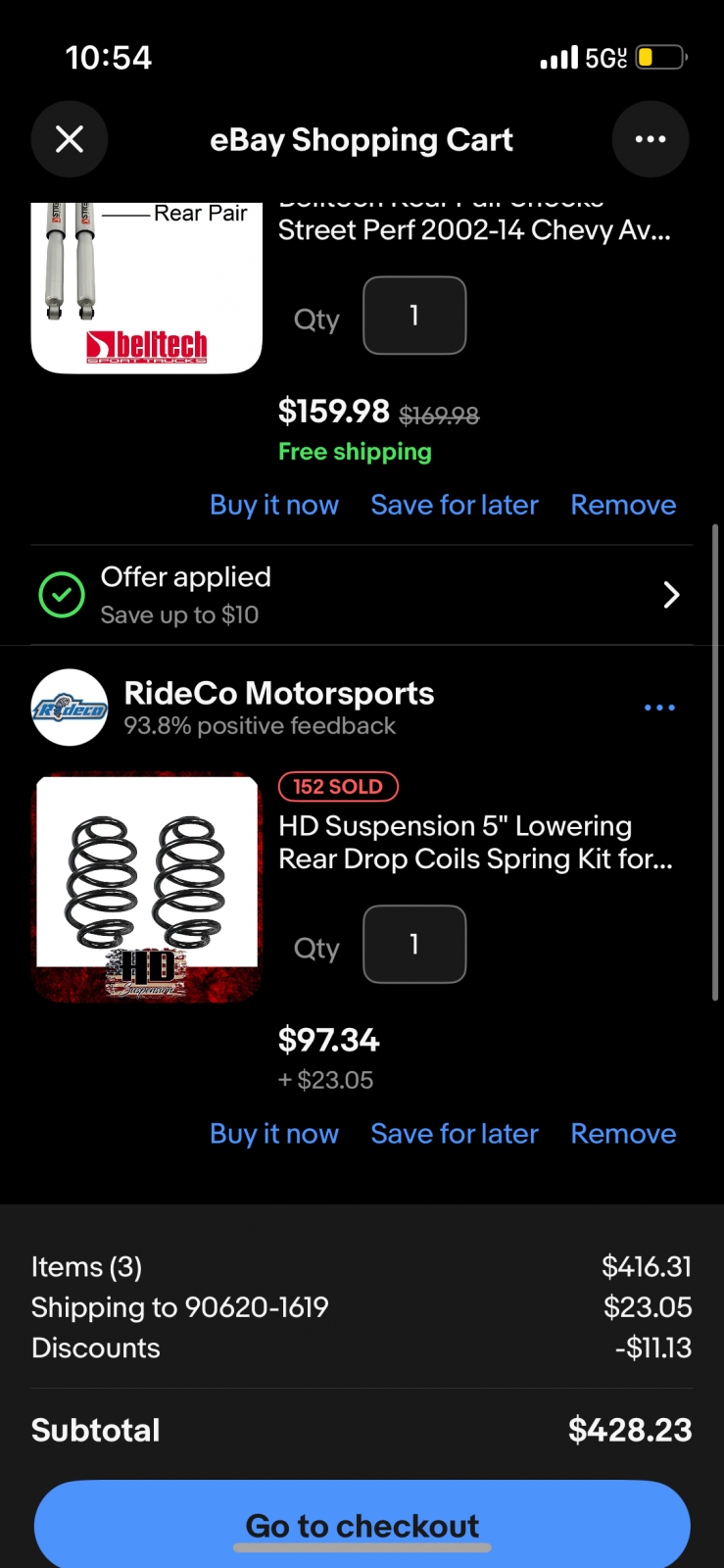

Hello I am looking to drop the rear (along with front) I am wondering would these parts work together before I purchase please help.

While I have no direct experience with those brands I am assuming they will be fine.
The only issue I see is those rear sway bar end links are straight instead of offset like the DJM links so depending on the amount of rear drop and length of those end links you may have interference with the sway bar hitting the panhard bar mount that hangs down from the frame on the passenger side.
The other thing is I don't see any shock relocation brackets in those listing. Might want to add those to the list so you don't bottom out the shocks, again depending on how much drop those springs actually give.
I'm also not sure what some of those extra parts are for in the trailing arm relocation listing, like the square plate in the middle between all the bolts.
An actual link to the parts would have been better than pics.
