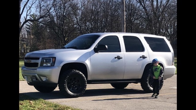

Don’t really have any good pics. But this is how it sits right now.
