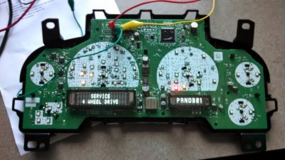

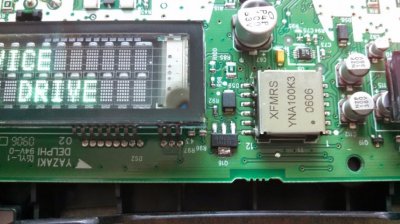

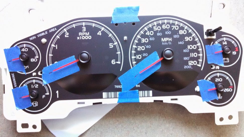

Just wanted to update to say that I fixed mine. Ended up replacing the MOSFET (Q16). The solder wasn't the problem on my cluster.
Part was less than $1.
