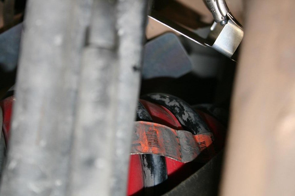

I tow a 28' TT fully loaded about 8k lbs. After a lot of research I went with a pair of Airlift 1000s like Max suggested. They were only 65 bucks with tax and shipping from Amazon. The install took less than an hour and I didn't have a lift to use either, just jacked up the rear end. I ran the air lines to a T and put the "valve stem" in the rear bumper. Now anytime I tow, I just hook my tiny portable compressor up to the cigarette lighter jack in the back and pump 'em up to 35 psi. No more sag and the ride is pretty good. I'll let out a little air to level it out if necessary. When I'm done I let the air down to 5 to 10 psi and the ride is back to normal. It even compensates for the soggy stocker Bilsteins that are wearing out and I'm going to replace soon.

Here's the pics I promised. Not sure if I uploaded them properly, so hopefully they show up. 1st pic: left side airbag in coil. 2nd pic: air line tee. I ran the line over to the left side to avoid the exhaust pipe. 3rd pic: Right side bag and heat shield. 4th pic: air fill fitting from inside bumper. 5th pic: air fill fitting.
I got my kit from Amazon, about $65 incl tax and shipping. That was the best price I could find, but you may be able to search for something cheaper. Also here's the link for the airlift website which has a vid in the middle of the page showing the install of the bag. http://www.airliftcompany.com/al1000.html They just don't show running the lines.Hope it all helps. Let me know if you have more questions.
