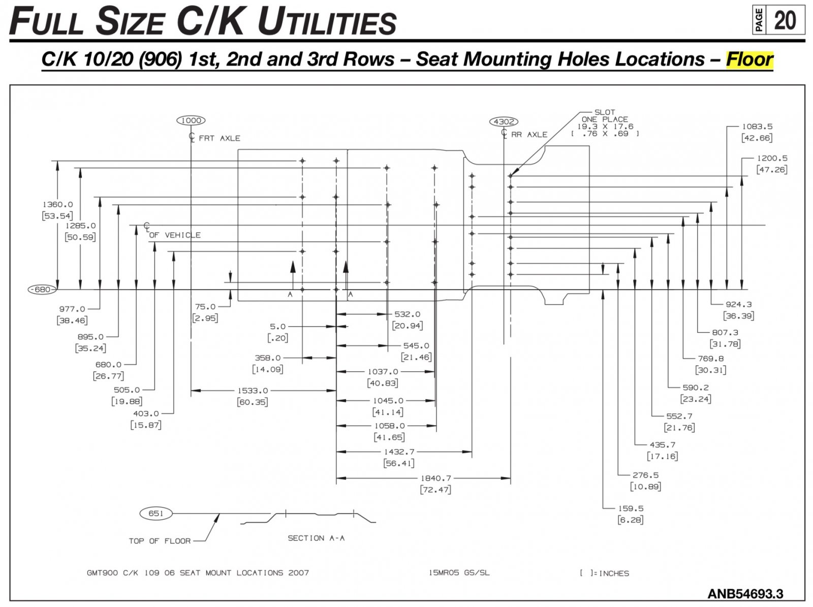

Does the NBS seat fit in an NNBS Suburban/Yukon XL without modification? If modification is needed - what would it take? Would the seat belts work?
I don't have an NBS handy or else I'd just measure myself. The NNBS floor pan dimensions are here, on page 20: https://www.gmupfitter.com/files/media/photo/442/2013_LD_Util_071713.pdf . I searched and could not find the same drawing for the NBS.
If someone has an NBS handy, could you please take some quick photos or measurements of the seat mount, and of the seat belt buckles on the outer seats?
