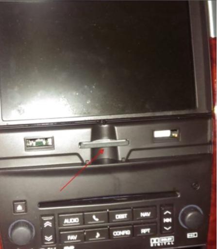

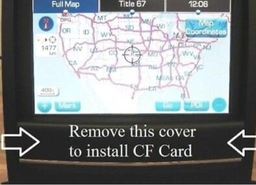

This will dial in a 2011-14 Escalade SuperNav CF card update procedure.
https://www.cadillacforums.com/threads/nav-cf-card-location.249868/
