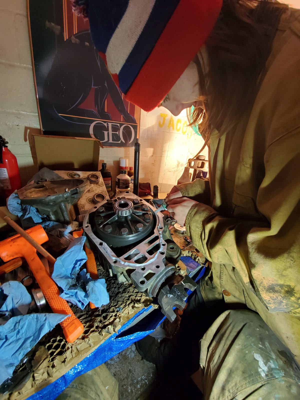

As I stated eariler we started the project with the 6 inch lift and 35 inch tires so we started with the gearing. 4.56 Richmond gears were installed in the front and rear diffs with a Detroit Trutrac to replace that nasty G80.

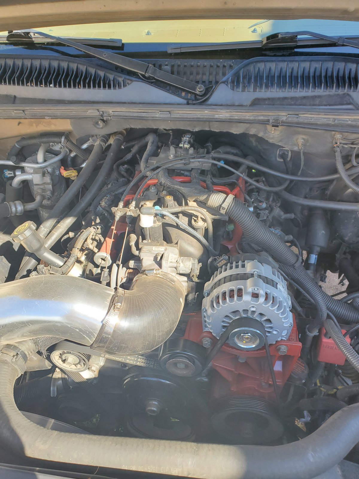

Once the engine was in we added a few upgrades such as Hedman headers (wrapped), a cold air intake, efan upgrade and injectors.

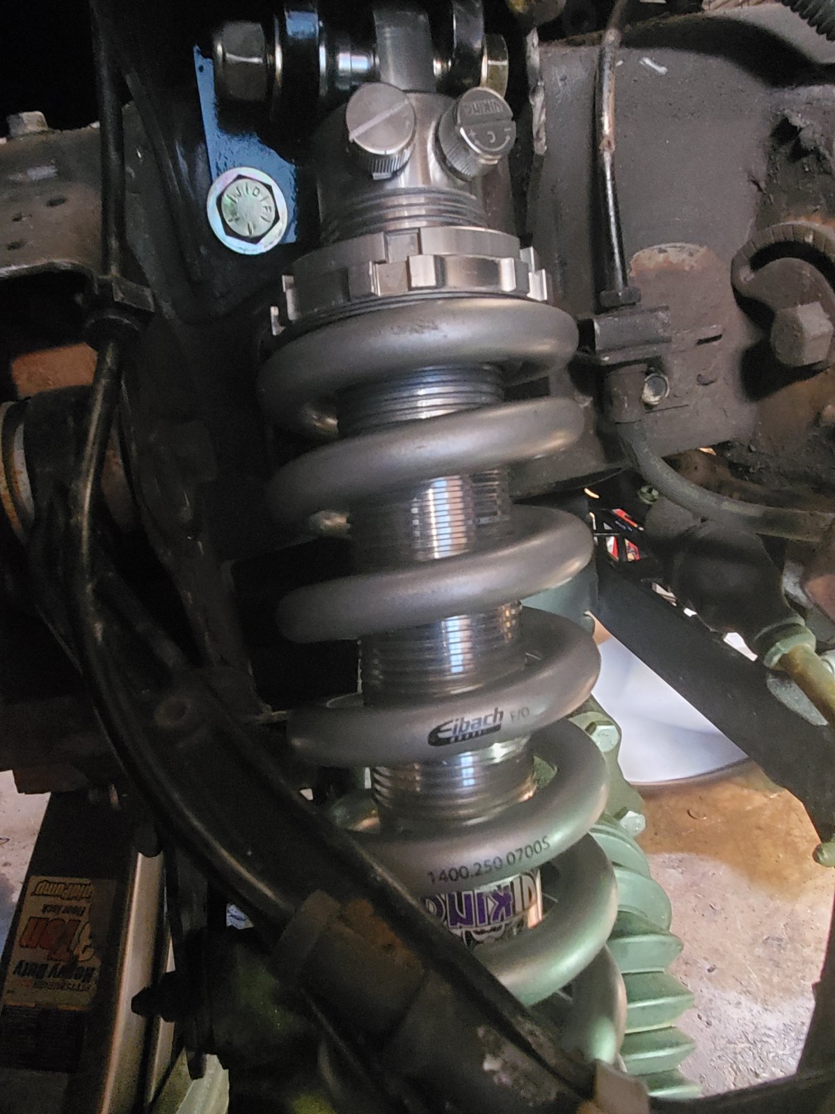

We chose to do Atomics torsion bar to coilover conversion for lifted trucks. Really wasn't to bad except for 1 really PITA bolt on the driver side. Handling is seriously amazing. I shoot up these colorado passes like I was in a car.

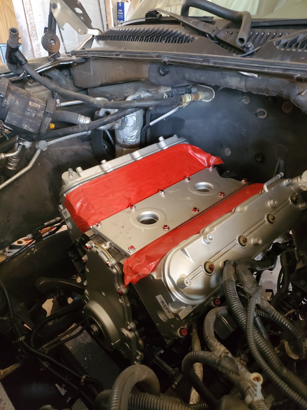

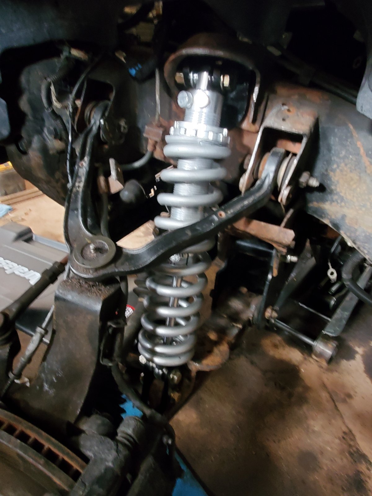

Here is a few more pics and tons more to post.
My son applying gear rtv to the front diff after the 4.56 gear rebuild.
Added a couple pics of the coilovers and the 6.0L finally installed.

Nice work...that sure beats my heads replacement for quarantine work!
Did you correct the sides and orientation of the valve covers later on?
Absolutely! Haha. I just threw the covers on to avoid any debris/dirt not realizing i threw them on the wrong way.

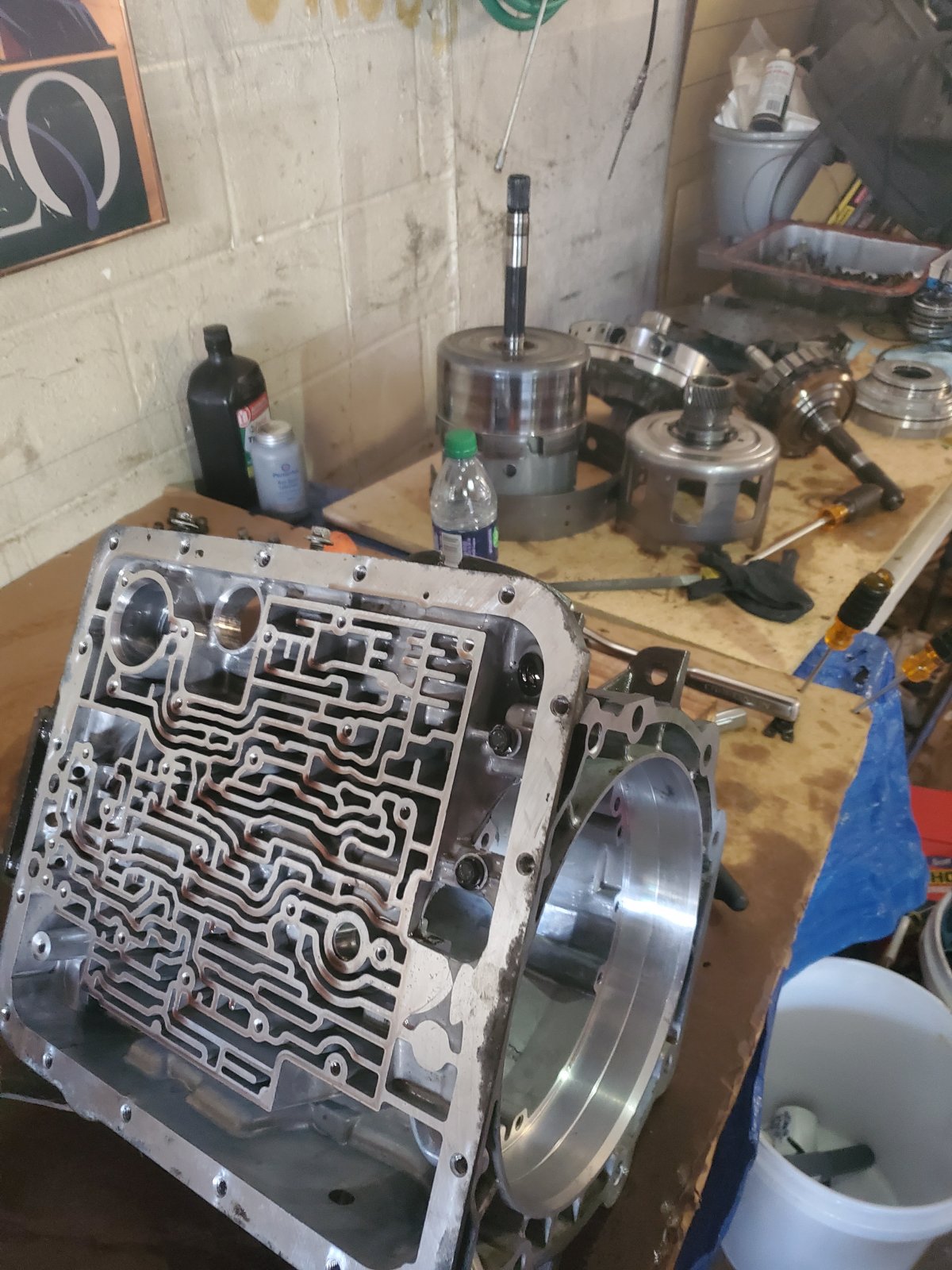

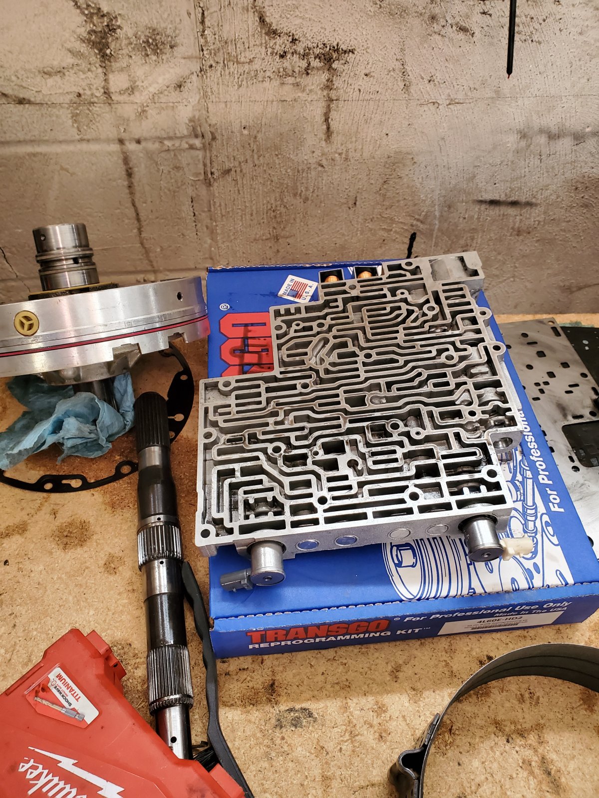

Here we are with the rebuild of the 4l60e. The 3-4 clutches were toast. Garage still stinks from the burnt fluid. This is what happens when you dont gear for larger tires.. Not a hard job but you gotta have a very nice pair of snap ring plyers. Had a hell of a time with the harbor freight model. Since this was my first trans rebuild we used multiple youtube videos but primarily used Transmission Bench with his walk thru. PATIENCE is all I can say when rebuilding.
So far we have hit a few local trails, drove to Moab, hit some trails there, then went north to Yellowstone and a few trips to the Denver Airport. All I can say is I wish I would have done this sooner. The shifts are instant and not neck breaking. Love the downshifts when climbing mountains, no hesitation hitting that passing gear.

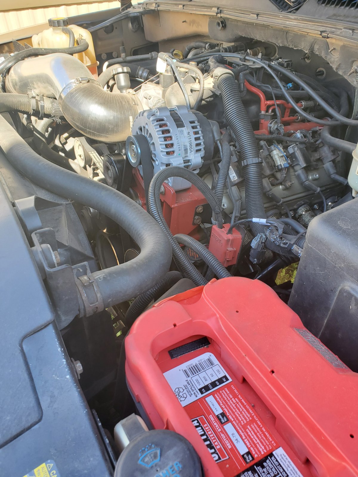

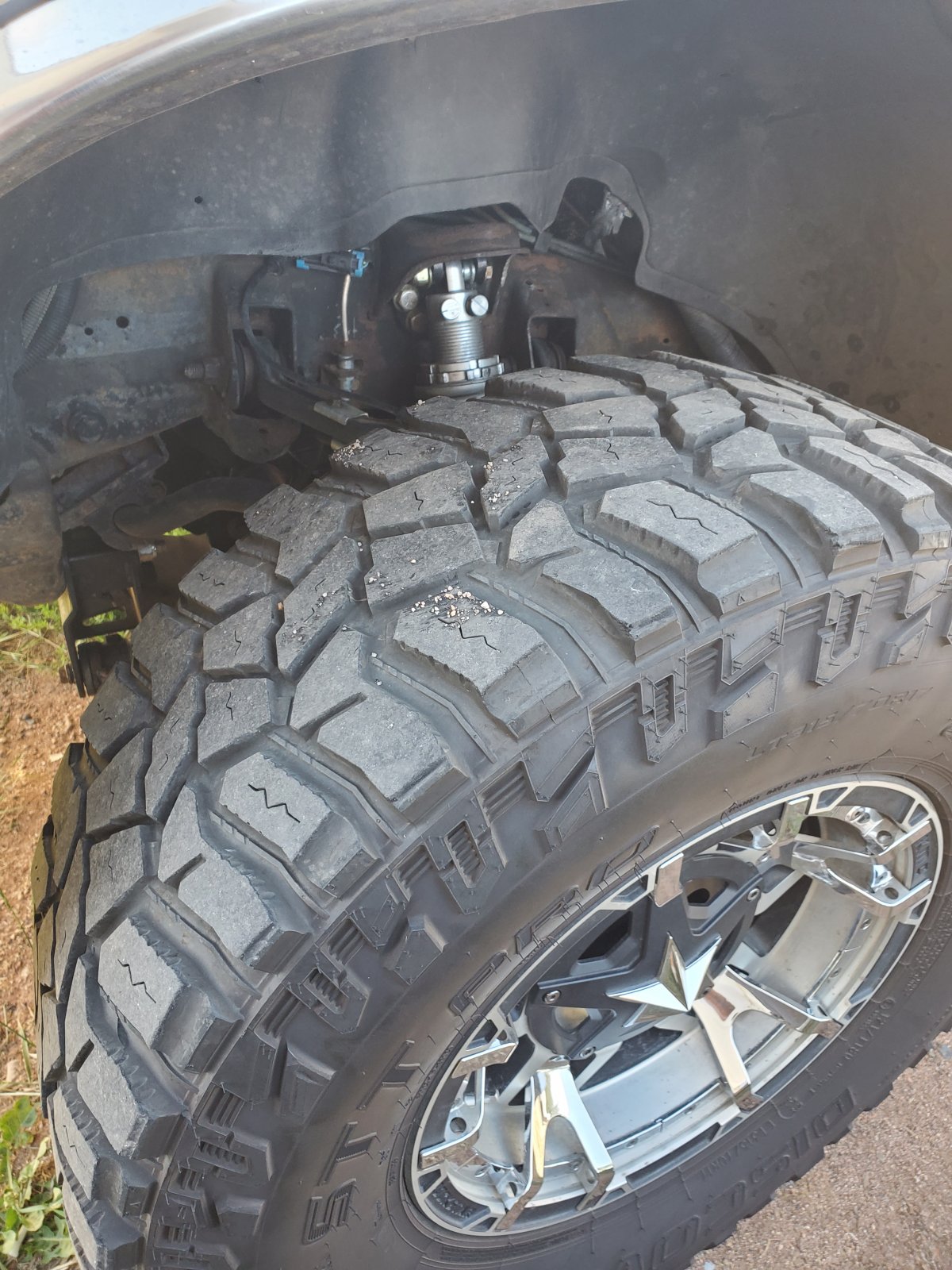

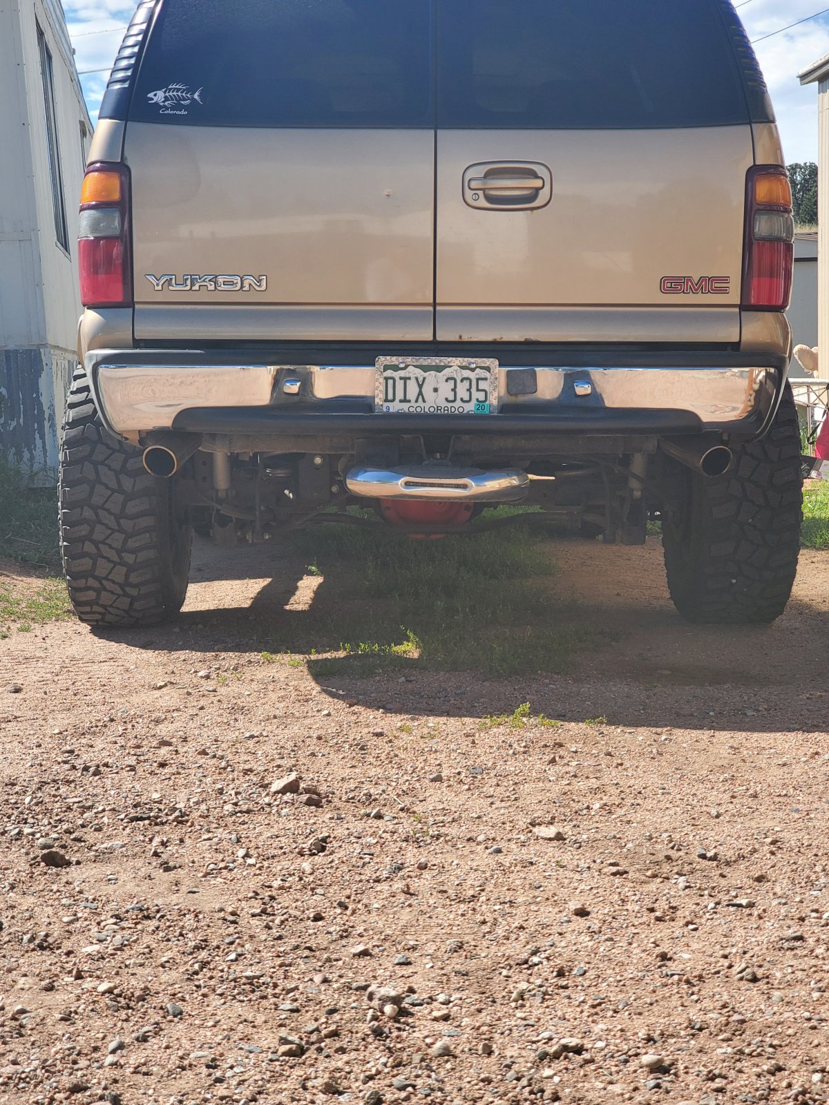

Here is a few more pics of the engine. Still need to wrap the metal on the cold air intake and run some new conduit for the wires. Im in the process of painting the cover for the engine so ill post that once finished. Throwing in some random pics of Goldies rear end and the rim/tire coilovers.
