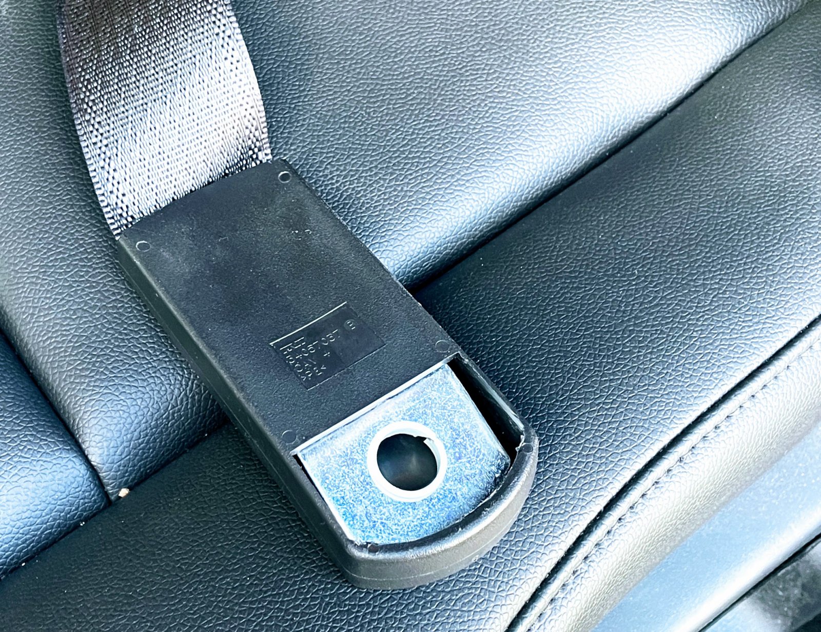

All I have really done so far is bolt down the 2nd row seats that came with it. I cleared out the holes scraping away the silicone filled bottom mounting holes. I fished up one of the bolts using dental floss because the muffler was in the way of my reach. The rest of the bolts went in easily. However, I am having difficulty locating mounting bolts for the 2nd row lap/shoulder seat belts to the side walls. Perhaps I shall have to go to the Chevy dealer to purchase expensive oem seat belt bolts.
IMO, this is a case where proper OE bolts and any associated hardware (washers, spacers) are a must. Generic fasteners likely won't have the correct flange, shank/shoulder configuration, and bending resistance.

Those bolts are 11609886 or M12 x 1.75 x 40.
I purchased some other bolts to try but they had the wrong threads. I am going to see what hex bolts are available at local hardware stores that might stick out a little further so that I can still wrench them in. Thank you so much for the original bolt size!

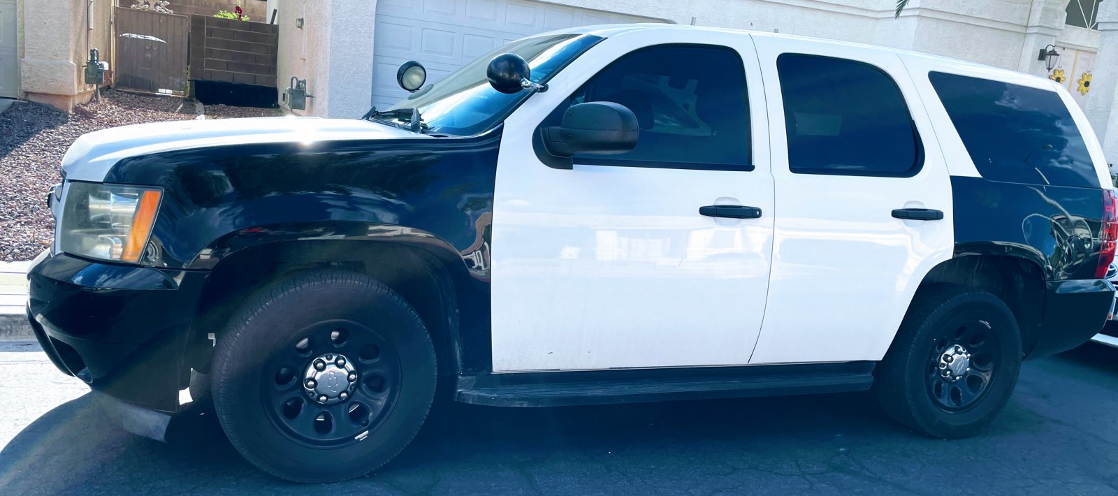

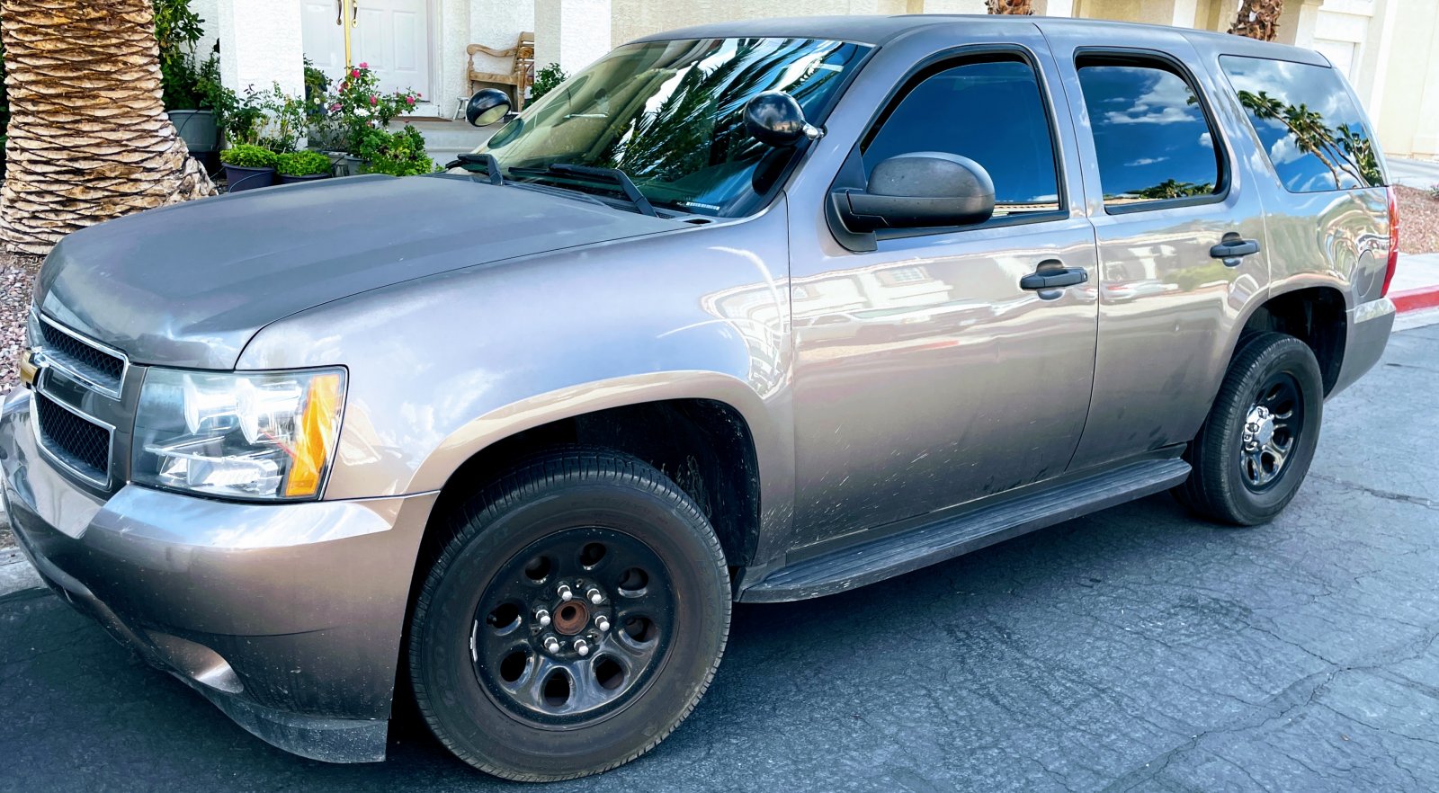

Thanks for the info. The wife is pressuring me to remove the spotlights. We shall have to see who wins. Usually I give in. However, I also own a 2011 Tahoe PPV that still has the spotlights and black and white paint to retain that OG police cruiser look. However, my 2011 Tahoe PPV has 107,000 miles on it, so I will probably put it up for sale since I prefer fewer miles and subtle civilian friendly looks of my newer 2013 Tahoe PPV.

Are you sure that the black is paint and not a wrap over white paint?
I am not sure if it is a wrap or not.
