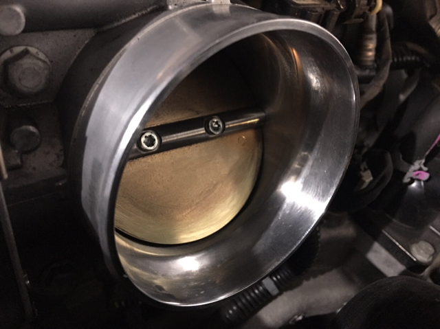

I paired the tune with a AFE CAI, that really opened up the engine quite a bit plus the sound coming from the intake is amazing. Even with the tune and CAI the truck felt a bit sluggish during part throttle and mid range power, it was better don’t get me wrong but I still had to almost floor it to even have it to shift down. Thats when I went a bit further into porting and polishing the TB. Upon doing that I noticed there is a big step in the TB right before the valve opening, that step is there to decrease the air speed coming in and keep fuel economy up. Once I eliminated that and polished the TB opening into a continuous surface the throttle characteristics of the truck changed a lot. This by far has been one of the best mods to date and it only cost me $40 for the grinding stones. The throttle responds more like a car and less like a tow truck. The kick-down is now actually responsive, finally.

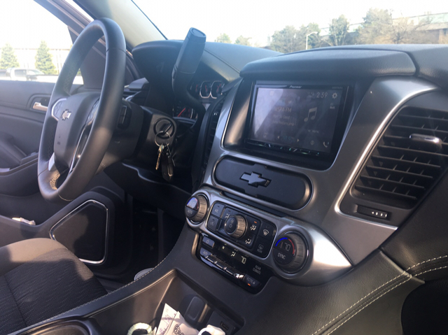

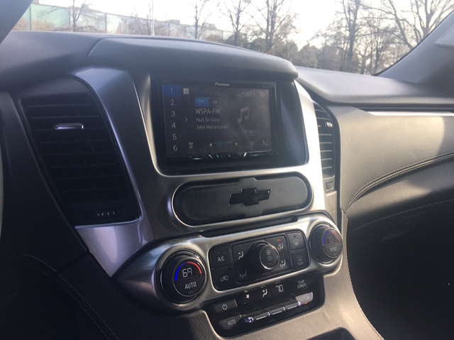

The LS radio sucks big time so I ended up installing a Pioneer touch screen with Carplay. Pretty happy since it cost me all about $500 with specials and that included all the interface harnesses to keep the steering wheel controls and Onstar. With the elimination of the OE radio I now had a big hole where the radio controls used to be so I went ahead and designed a lid with the chevy logo on it and had it 3D printed. Very happy with how it looks, almost like a stock part I’d say.

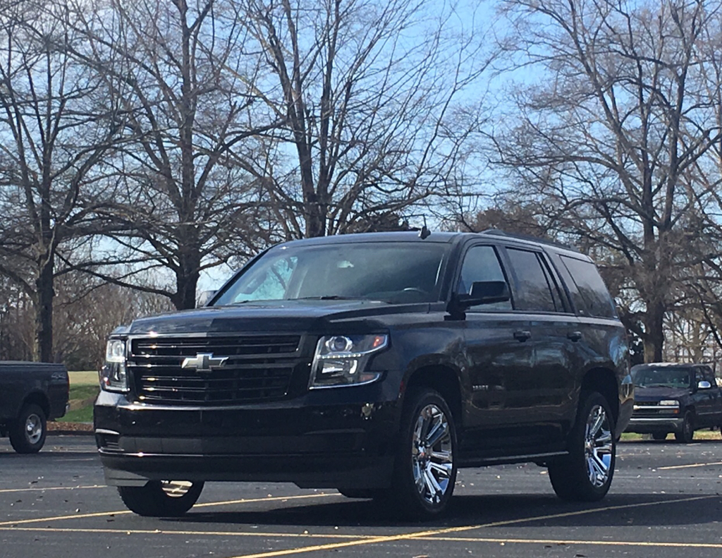

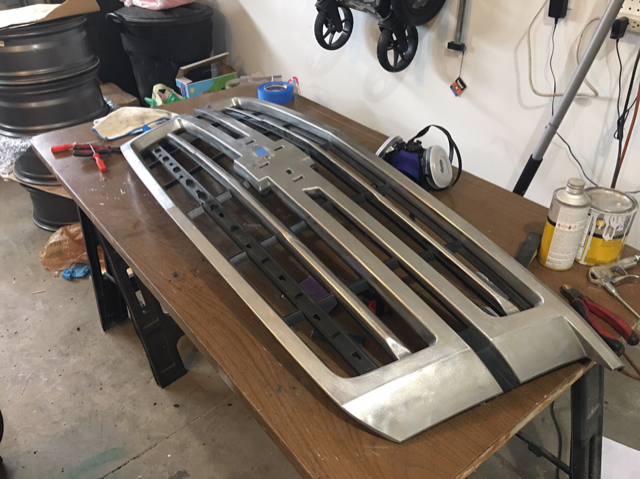

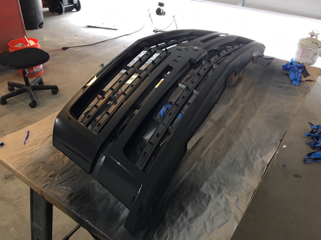

Started out by purchasing a set of 22 GMC style rims paired with a set of Goodyear Eagle AS tires. Next goal was to make the truck stand out from the rest so after visiting the Chevy dealer and seeing the RST models l decided that painting the grille was the best mod for me. I didn’t want to keep the LS grille so I ended up getting a very good deal on Ebay from a guy selling a LTZ grille that had been scratched by another car supposedly. Ended up painting it with Dupont base and clear on top of Epoxy primer for a quality pro finish that will last.
Im very pleased with the results so far...looks sharp and its very fun to drive.

Very nice, tasteful mods.

Super nice. You need some HIDs or really good LED bulbs. That was what I hated about my truck the most - couldn't see at night.
How did you get the grille out without ripping the bumper off? I need to rewrap mine but all the instructions show that I need to take the bumper off and the little tabs on the fenders all rip.

Nice, looks really clean. I especially like the cover you had made for where the radio buttons used to be.
Yeah unfortunately the bumper has to come off. The good thing is that it comes off easy. Once you get the top bolts off and the wheel well bolts out on both sides all that's left is two clips that hold the bumper to the front part of the chassis IIRC.

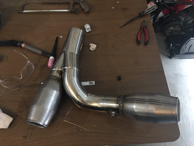

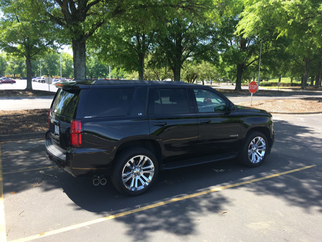

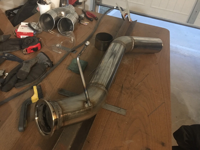

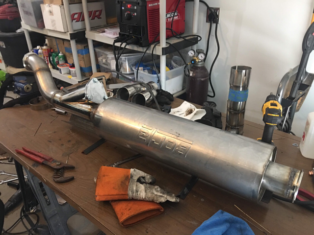

So after 3 months of interrupted welding and fabrication I have been finally able to finish off the custom exhaust For the Tahoe!

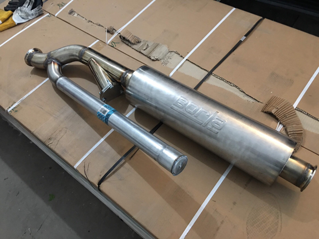

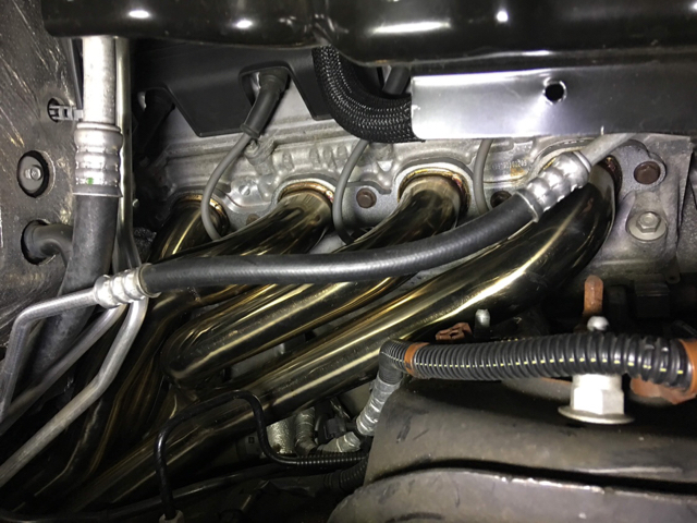

I started off by getting a set of Speed Engineering headers + Y pipe (3” diameter). To keep the exhaust tone down I added a couple of high flow cats to the y pipe. Once the headers were installed I started working on the catback. I decided on getting a 3” Borla specialty muffler similar to the touring muffler offered on the Borla-GM exhaust kit but only much cheaper. The plan was to have a good mellow sounding exhaust with a cutout valve for when a nit more fun was wanted. Once I finished off the mid section I decided on adding v band clamps to the whole exhaust (including headers) so out went the headers again for welding and fab...the wife was not impressed at all by it.
The trickiest part of this all was getting to the right level of volume and tone. With the midsection done I drove the SUV with the exhaust dumped right after the Borla...sounded awesome, zero drone on all rpms but way too loud. Then I added a straight tail pipe and got a good tone but too loud still and a whole lot of drone at 1800 rpms. Thats when I decided to add a Vibrant ultra quiet resonator at the tail pipe. This gave me a way more subtle tone at part throttle and a perfect loud tone at full throttle, the 1800rpm drone was still present though so thats when I decided on adding a 1/4 wave resonator. All of this iterating took me the better part of a month but after it all I am very pleased with the results.
PS still need to buy the cutout valve and finish off that section
