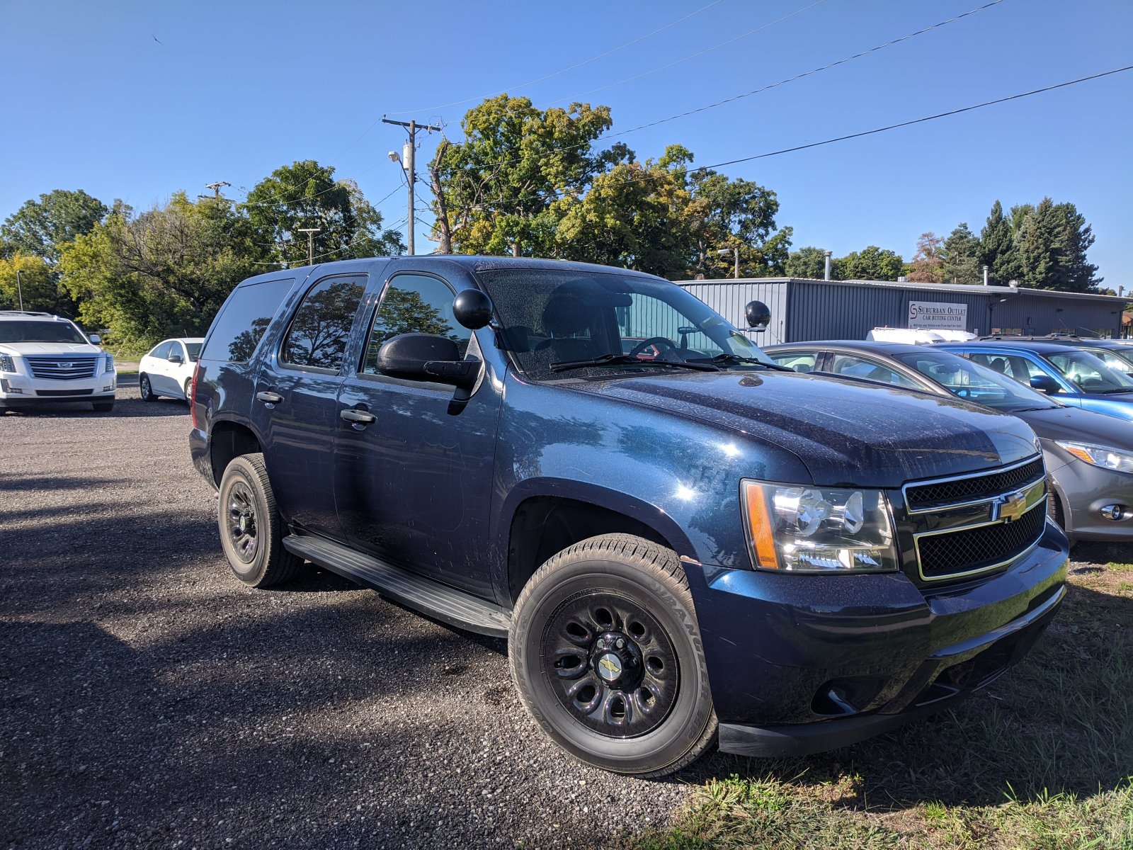

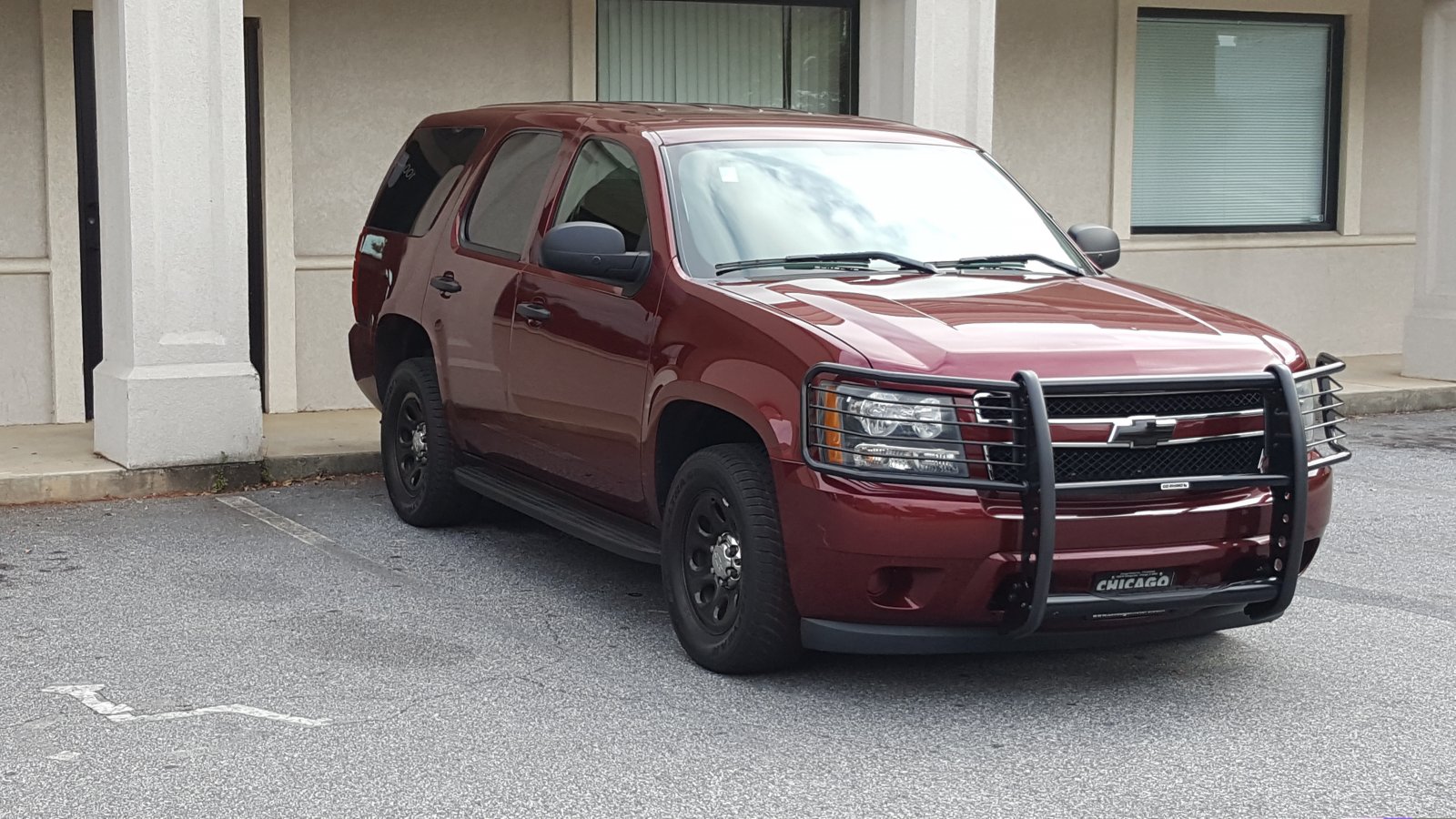

We picked it up fall 2020 from a dealership who had purchased it at auction. it came with no center console and heavily worn cloth seats in front, and leather(ette?) seats in the rear that looked unused.
Here it is the day (before) we got it.

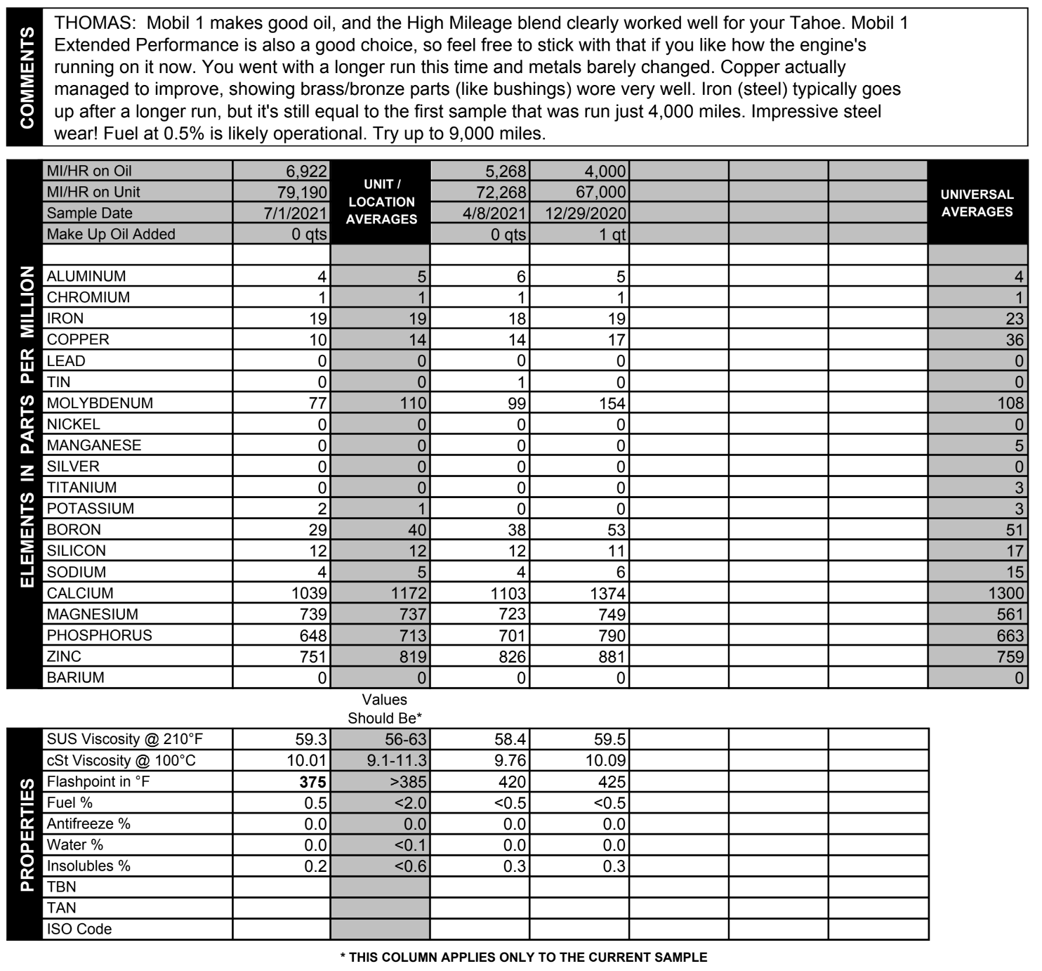

Wow! We had no problems for about 4k, then had the dreaded low oil error. We swapped the oil pressure sender, and filter, with no change. Figured we were in for a new engine, but decided to try an oil change first. I picked Mobil1 High Mileage and the low oil pressure problems have gone away. I've had the oil analyzed by Blackstone Labs and I'm very happy with how the Tahoe is performing. Here's a snap of the most recent oil analysis.

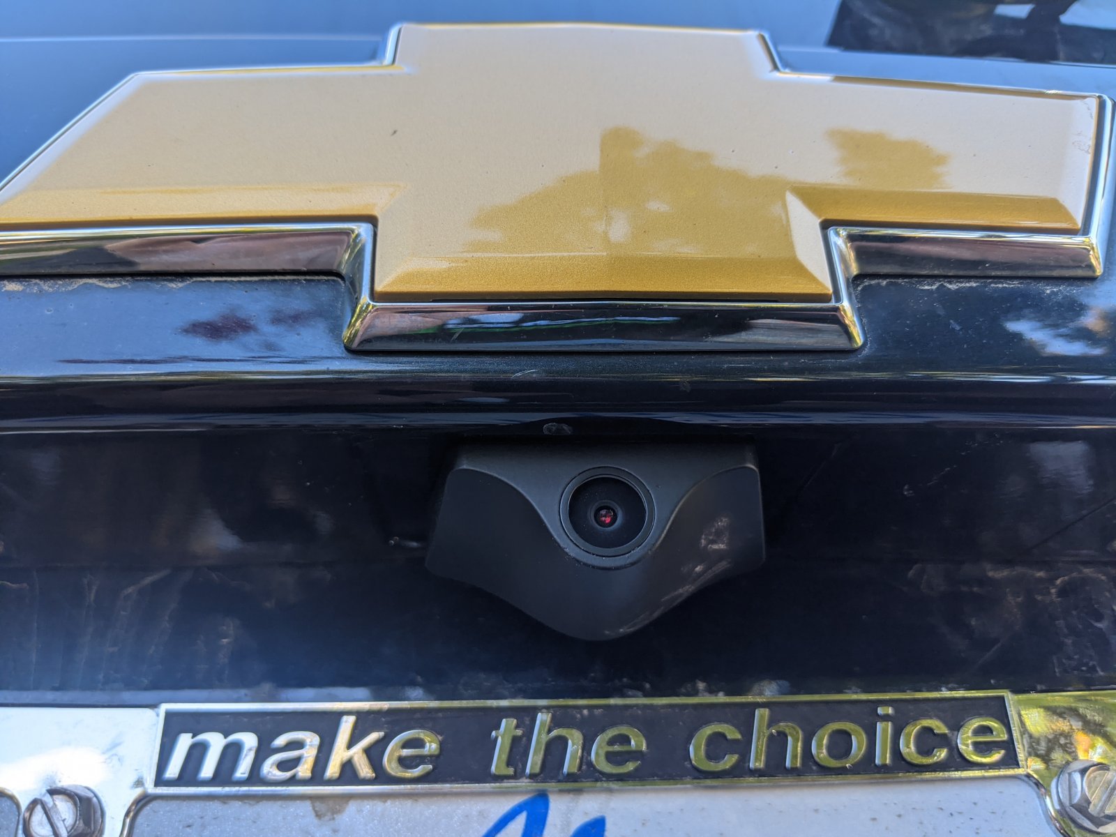

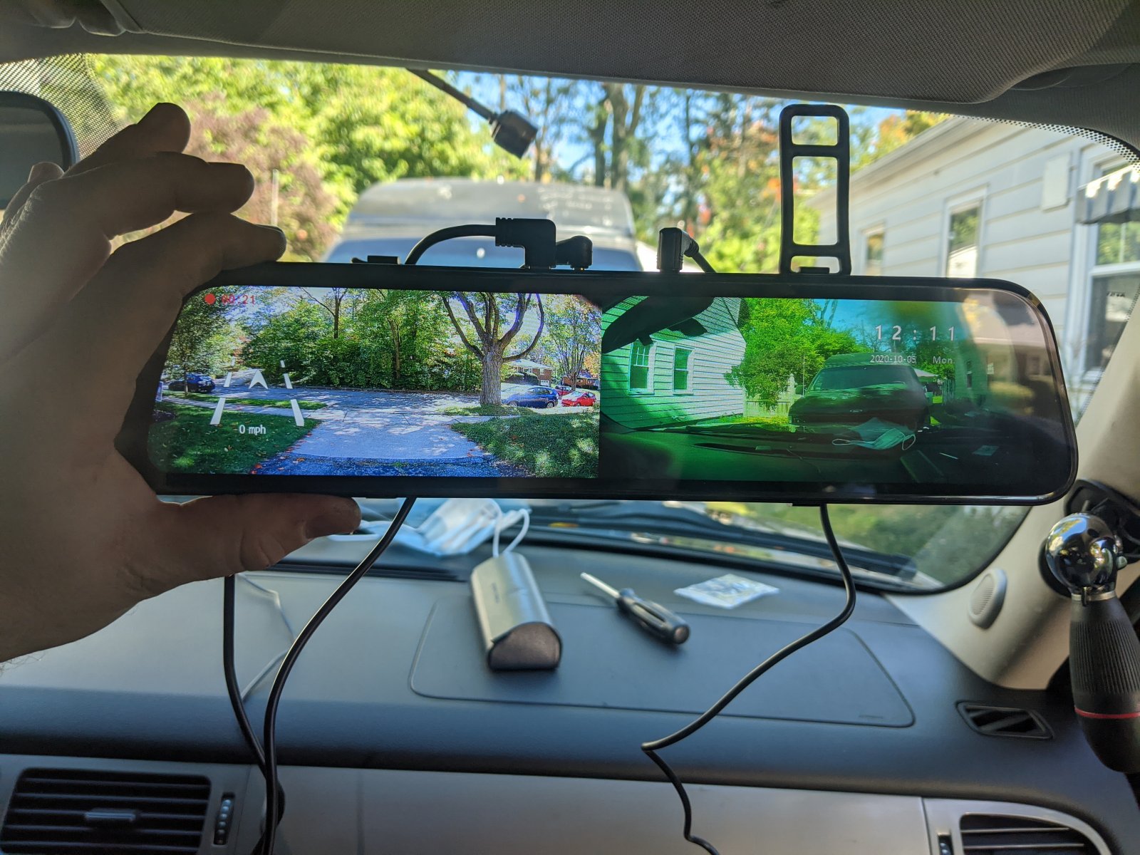

Installed a backup/dash cam.

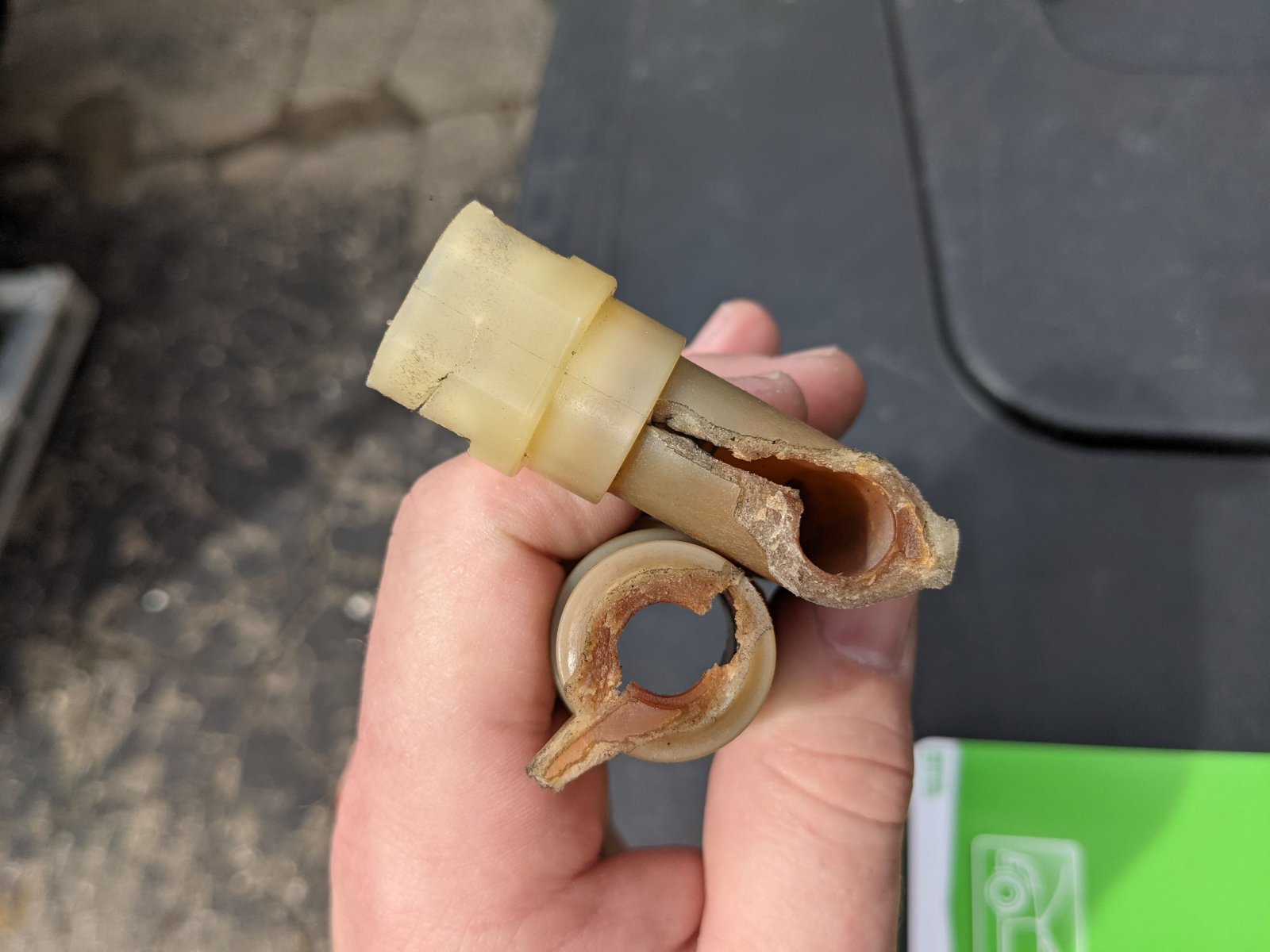

We had the coolant tees break. Thankfully it happened while parked, not while driving. I've replaced them with billet tees, so I shouldn't have problems again.

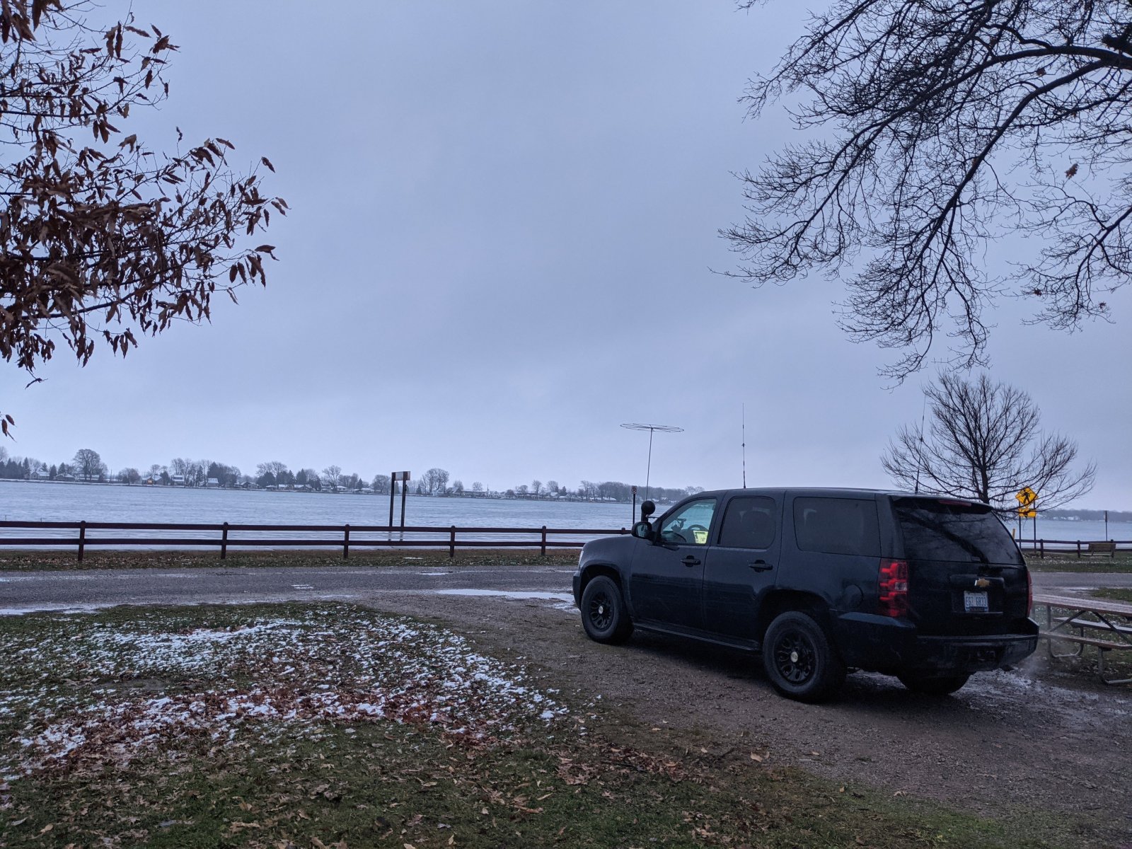

After we got the basic radio install done, we started doing some camping and traveling in the Tahoe.

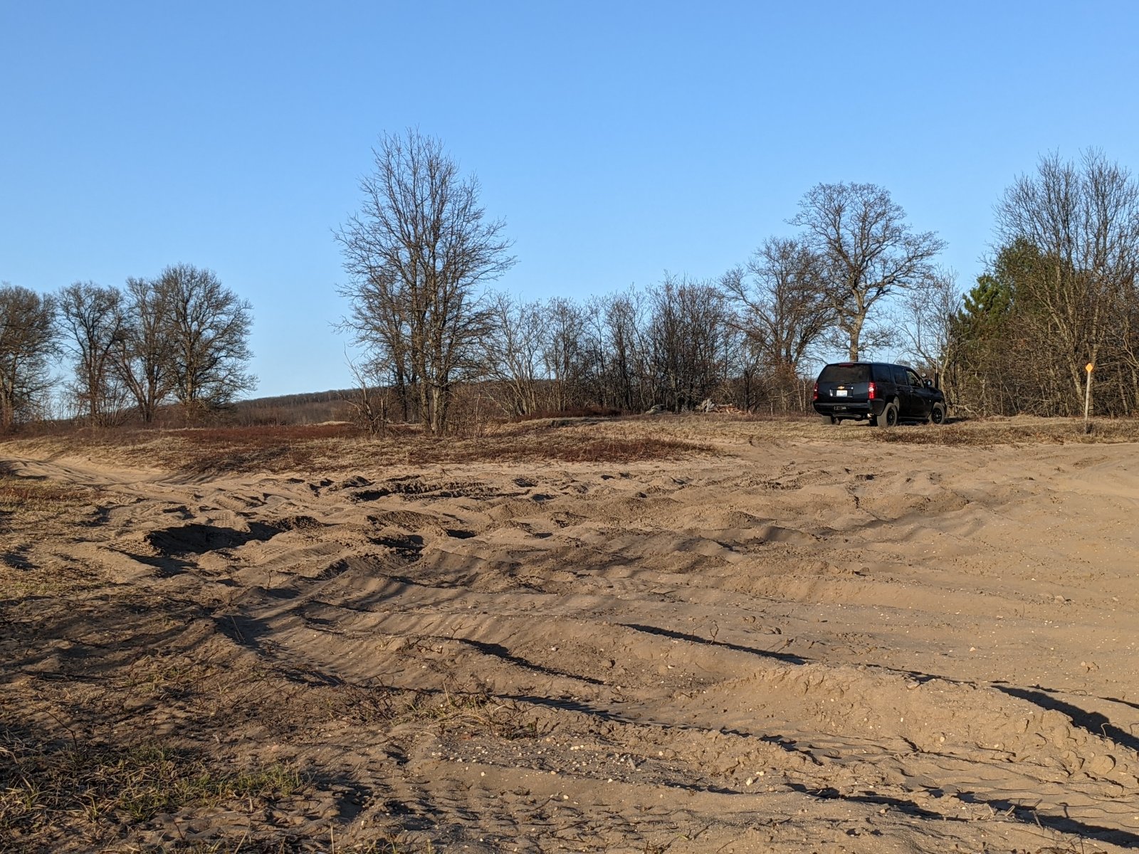

My first use of the 4x4. That mud pit was a little bit deeper than I thought!
We did some camping, and exploring.

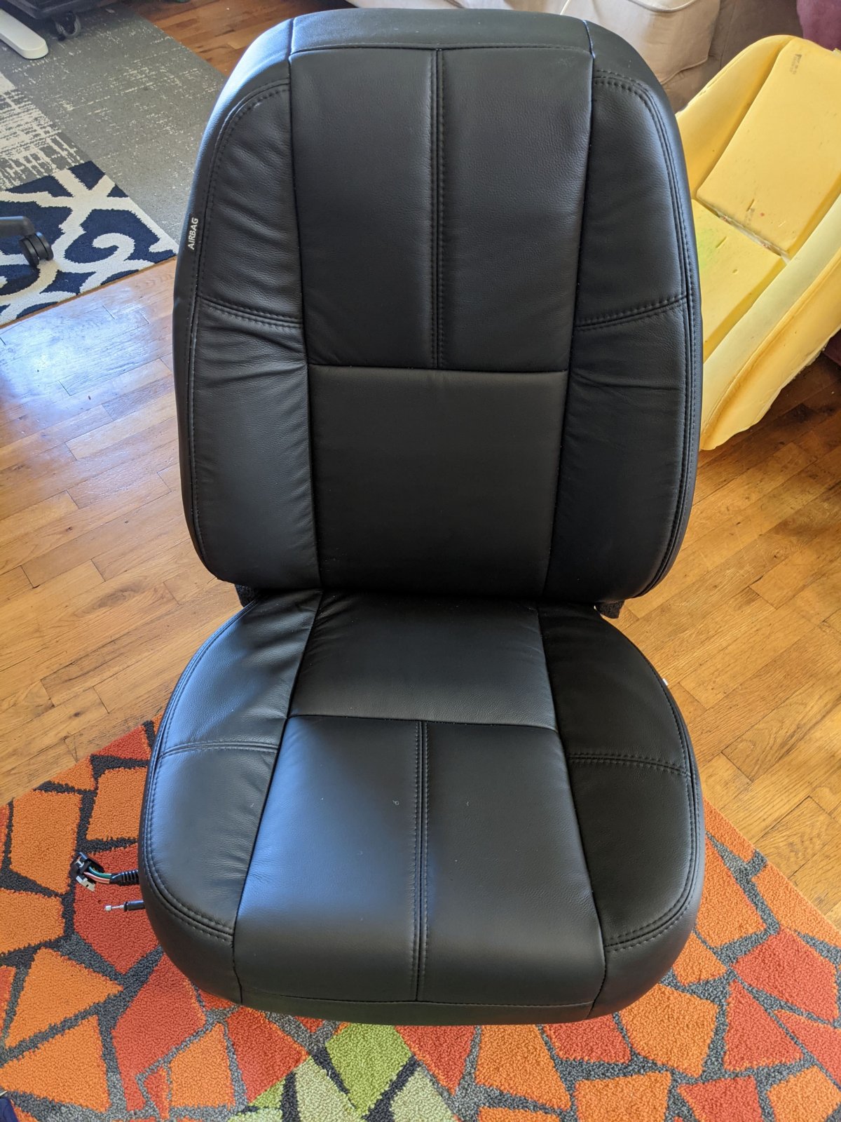

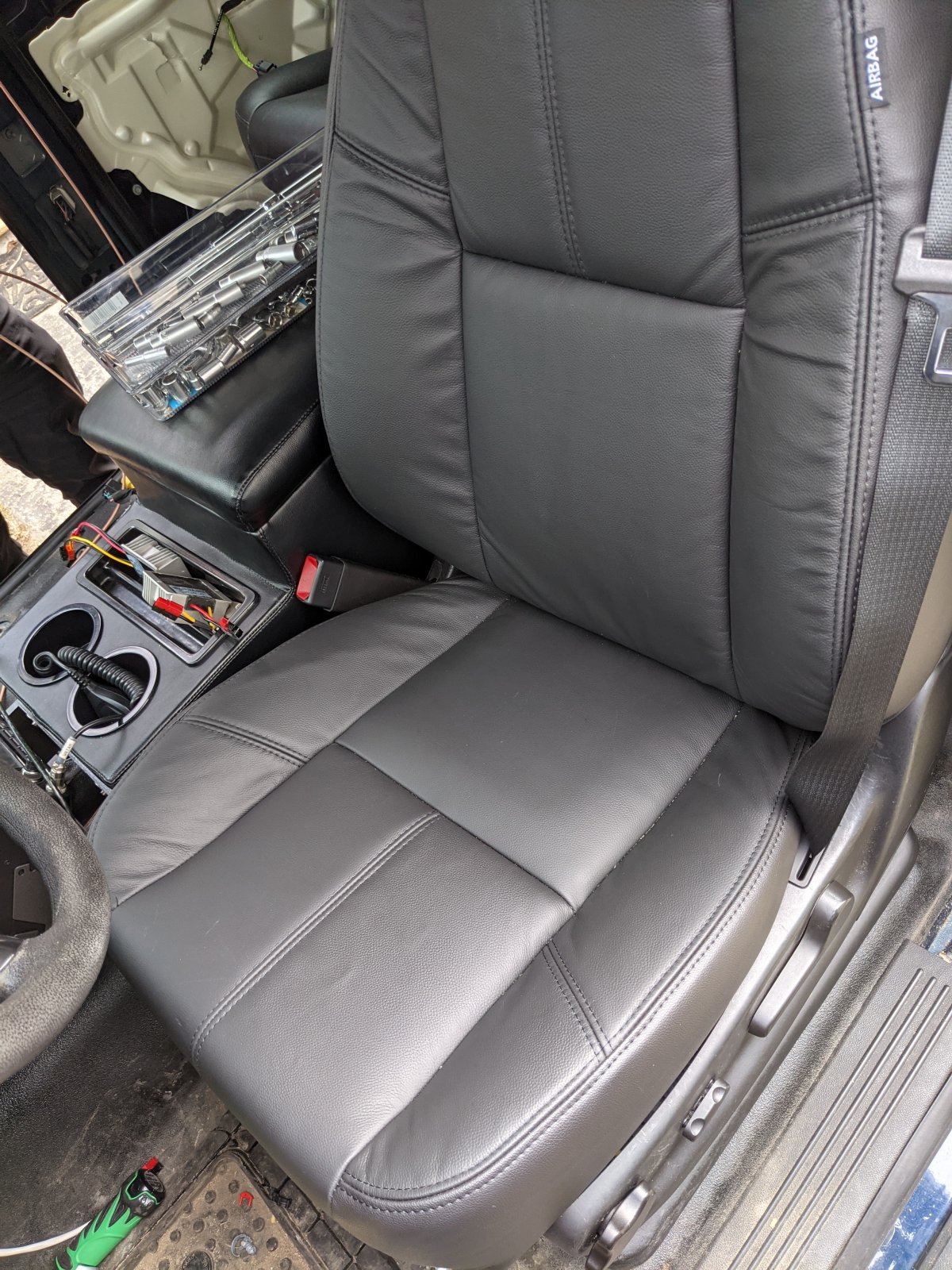

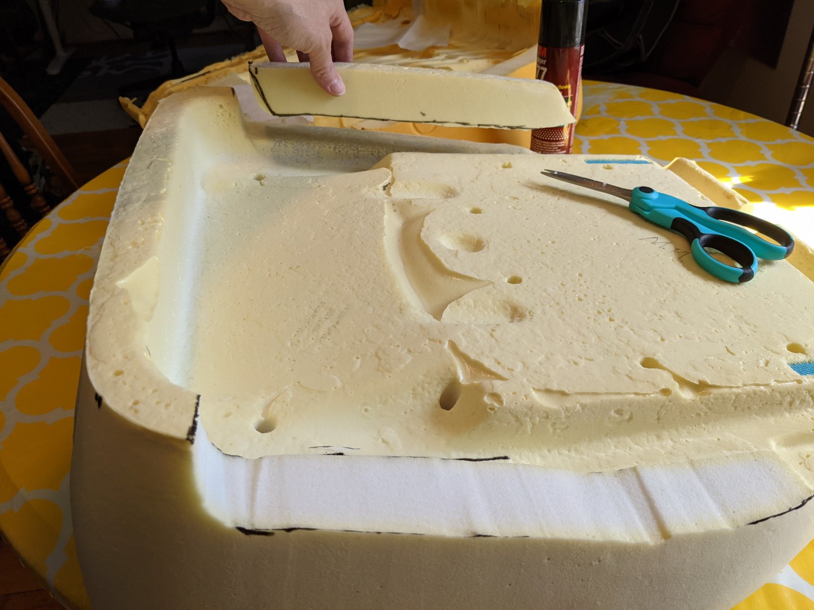

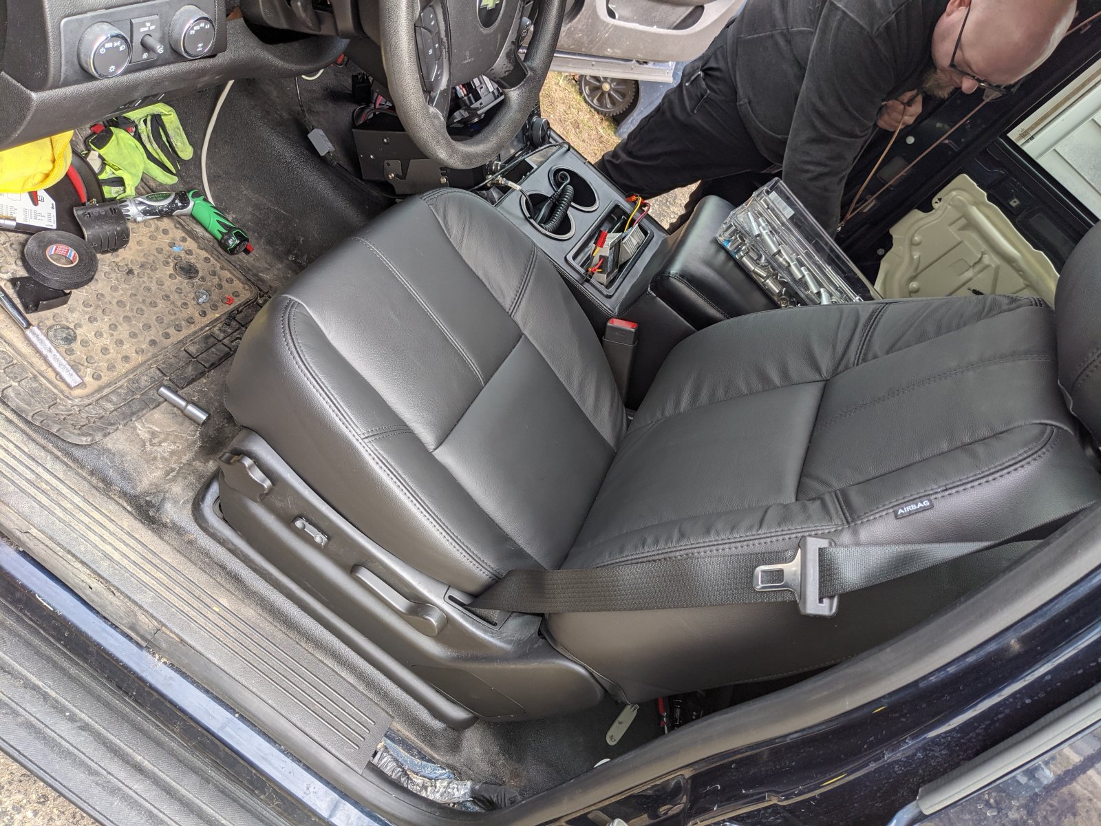

After a couple trips sitting on the smashed foam in the driver seat, we decided that an upgrade was necessary. We decided on The Seat Shops foam, which is sold as denser than stock foam. Some foam mods were necessary though.
After the foam mods, just installing the leather seat upholstery and reinstalling the seats in the Tahoe. While we had the seats out, I replaced the seatbelts too.
I'm real happy with how the seats feel now.

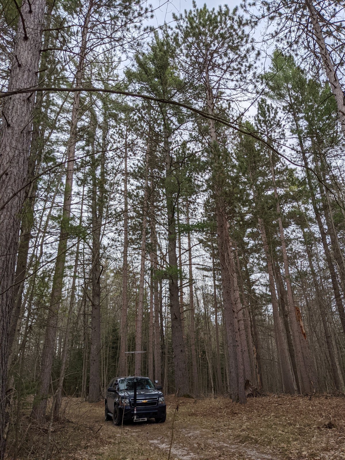

More exploring!

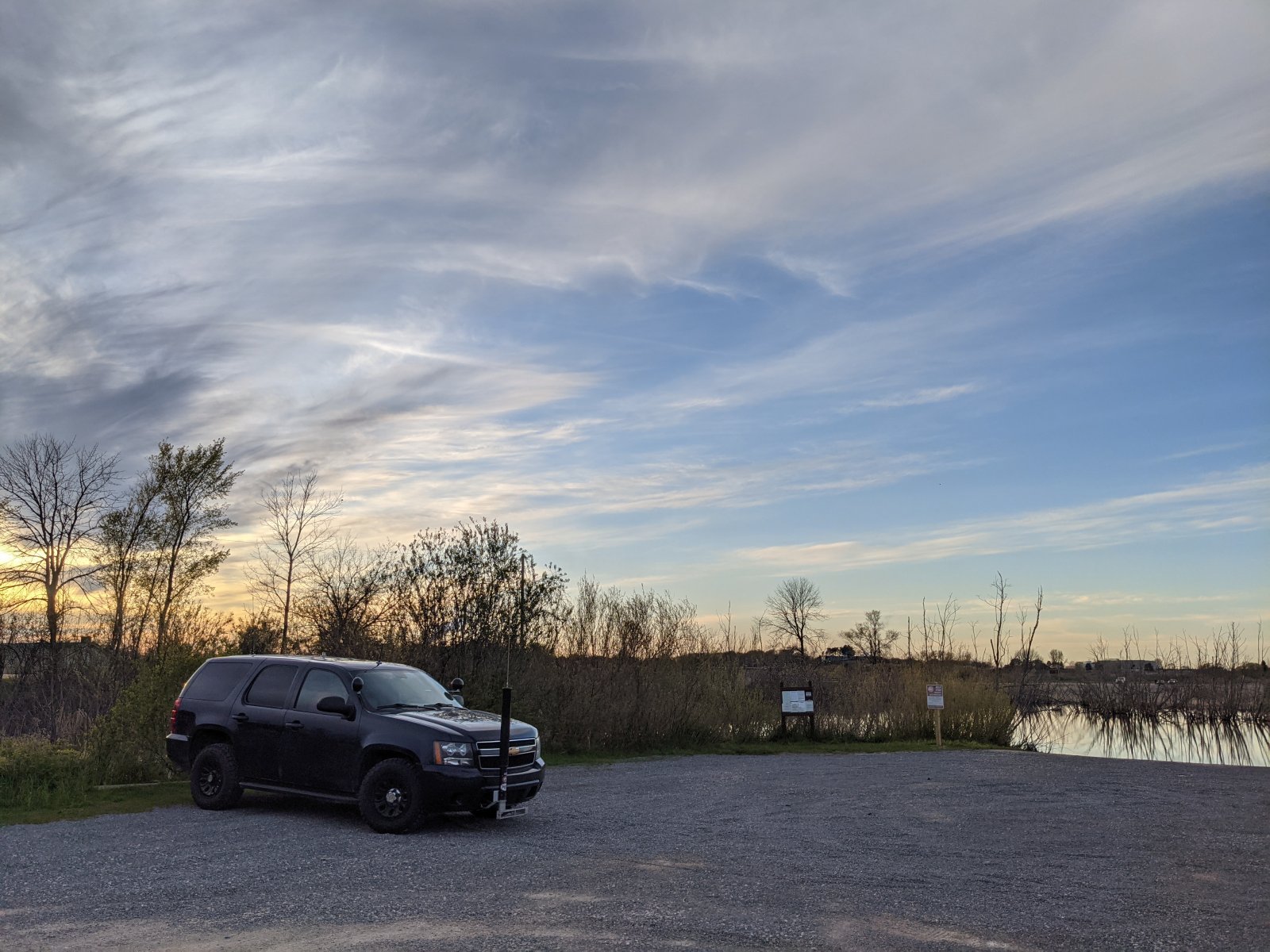

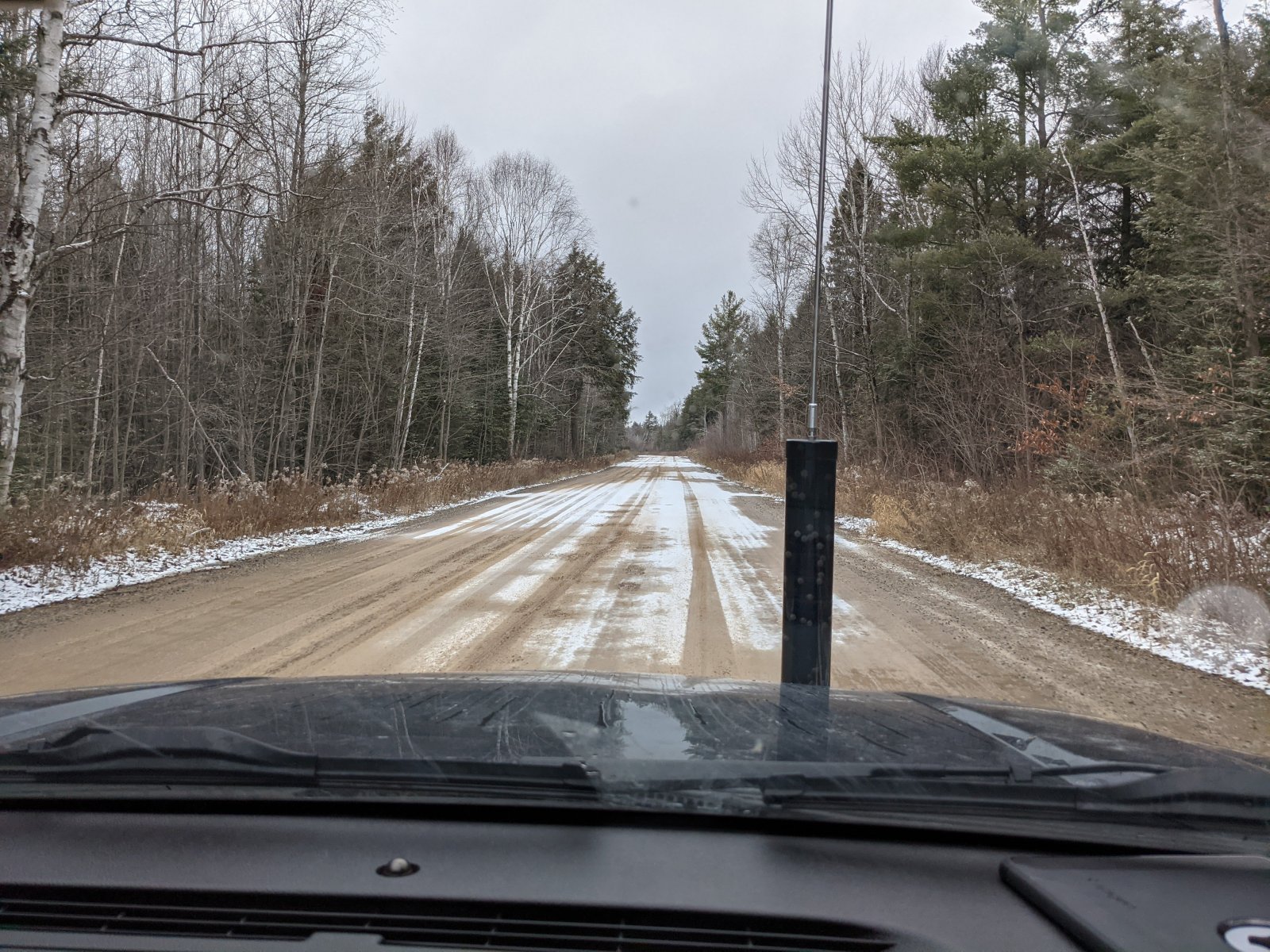

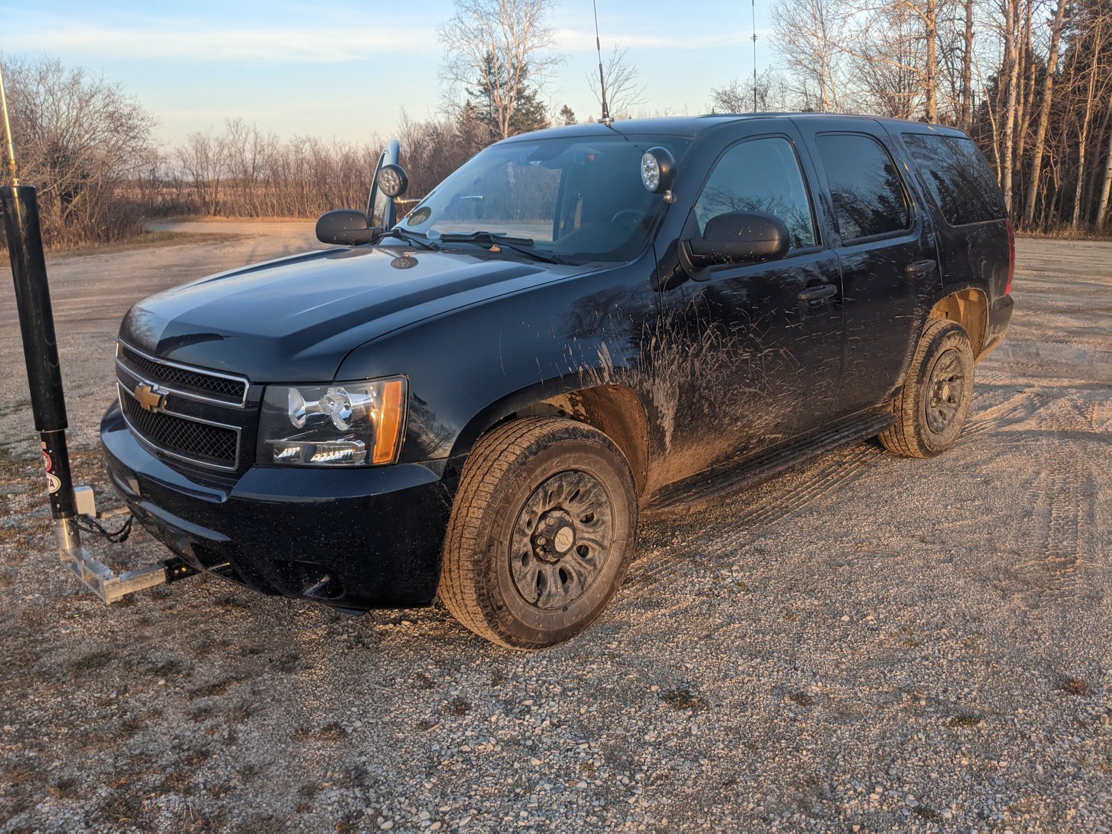

During this trip, I found that the front receiver mounted antenna is the low point on approach. Thankfully no damage done.

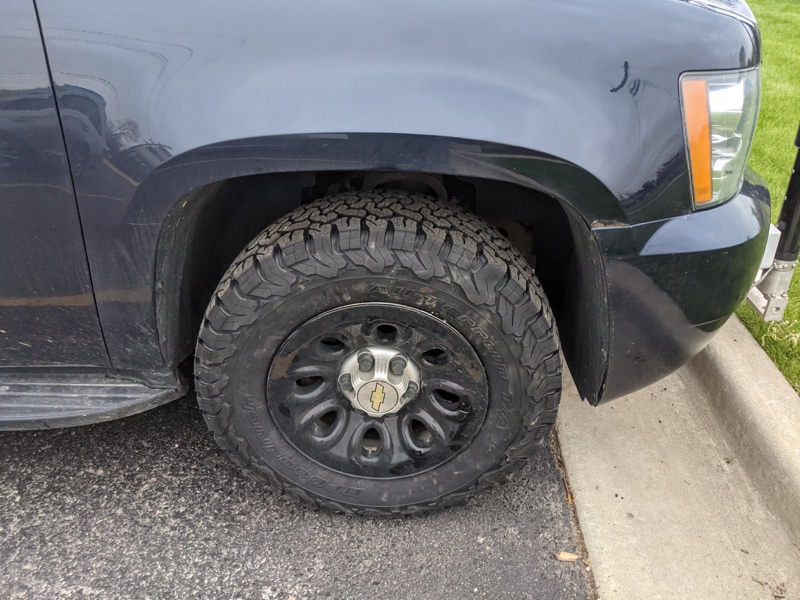

This trip convinced me we needed more aggressive tires. The street tires worked shockingly well, but I felt it was time for a change.
Enter the BFG KO2 tires. These tires are great!!

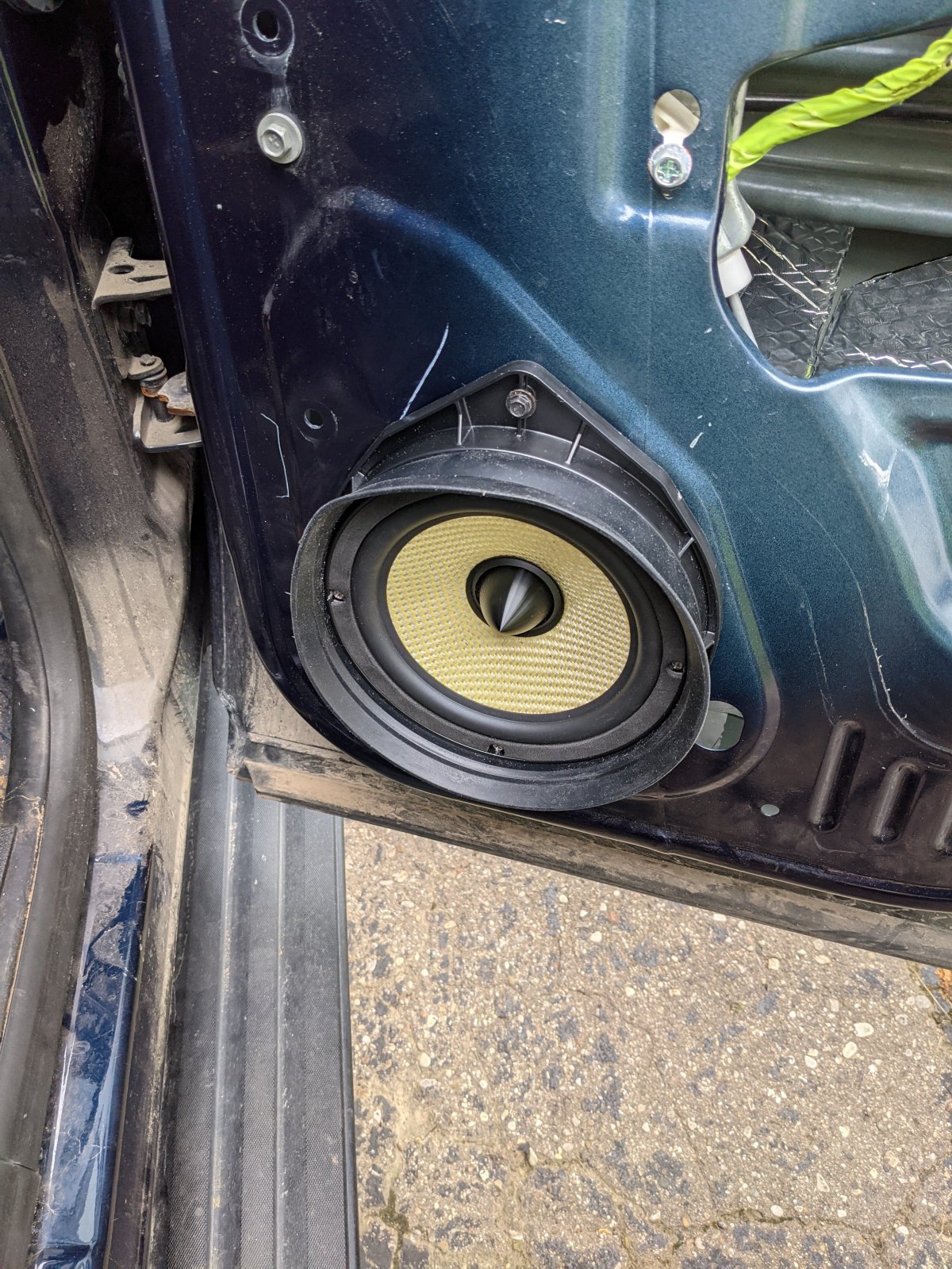

The stereo in our SSV had been modified by the factory for police use. I fixed it, and replaced the moisture damaged speakers with fresh speakers, with silicon baffles to protect them from water in the door. This job reminded me why most people who do stereo installs are young. Also threw some sound deadening material in the doors. Makes a nice difference in road noise. Please don't ask how much work it was to install those speakers. They didn't really fit, but... I got it to work.

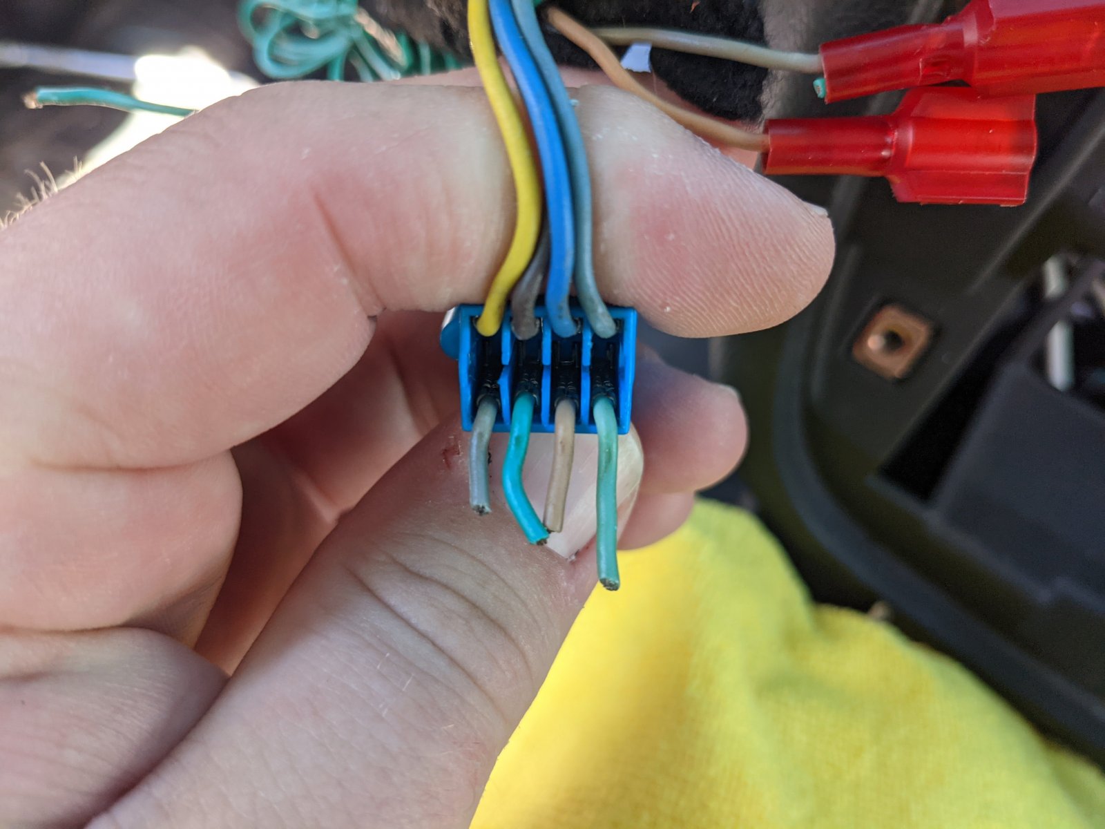

PPV/SSV wiring is.... Unique. The rear speakers were connected to the "front" wires, and the front wires were open. I fixed up the wiring, and got stereo working properly.

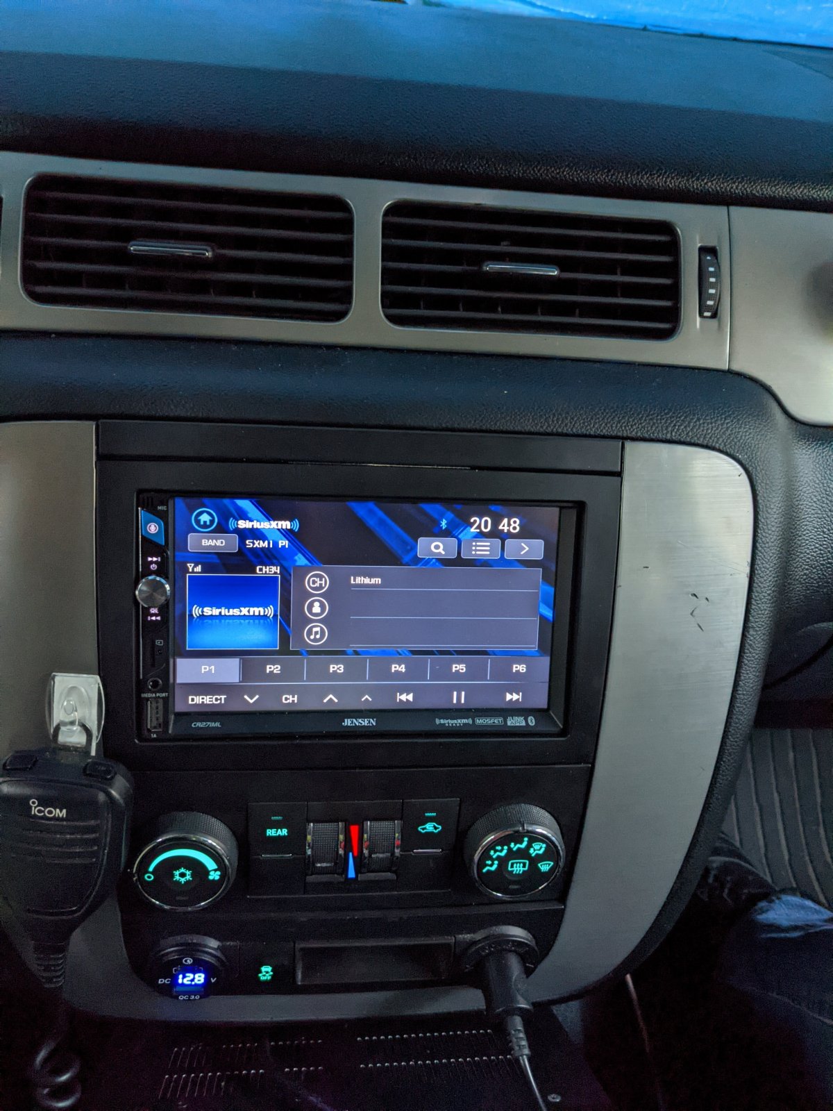

Time for a new head unit! The IC shortage of 2021 made buying a head unit an adventure. I managed to find this one, for a decent price, and it ticked many of my desires. No CD/DVD player, bluetooth phone and music, SXM compatibility. The fact that it sounds pretty good is a nice benefit, and wasn't too expensive.

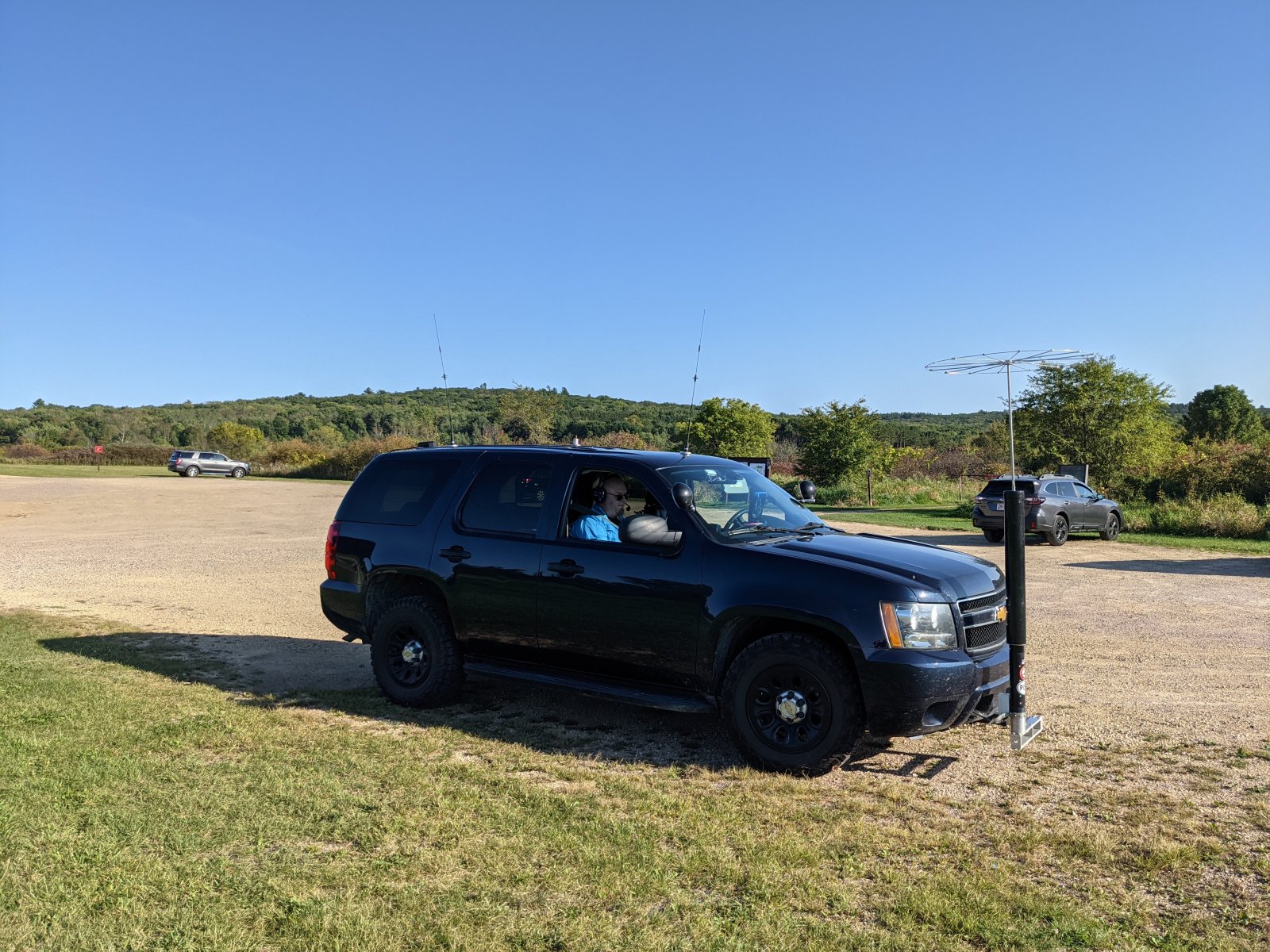

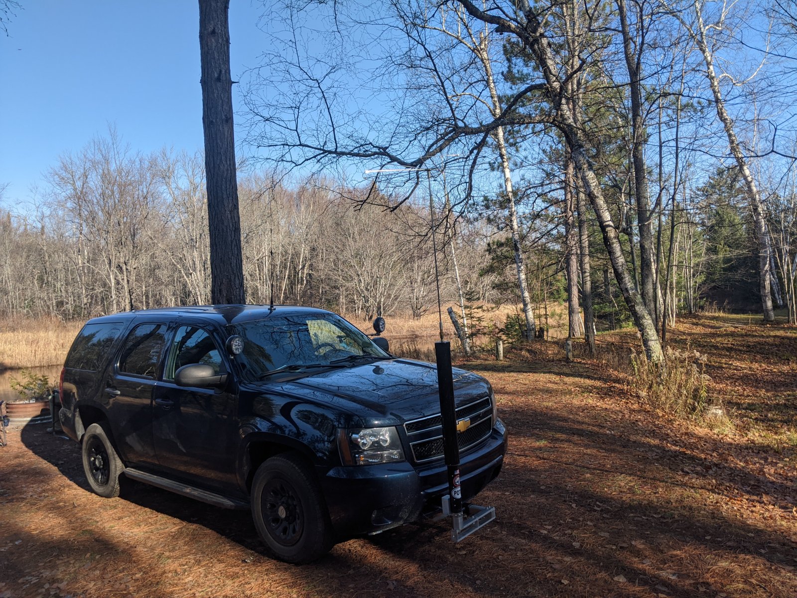

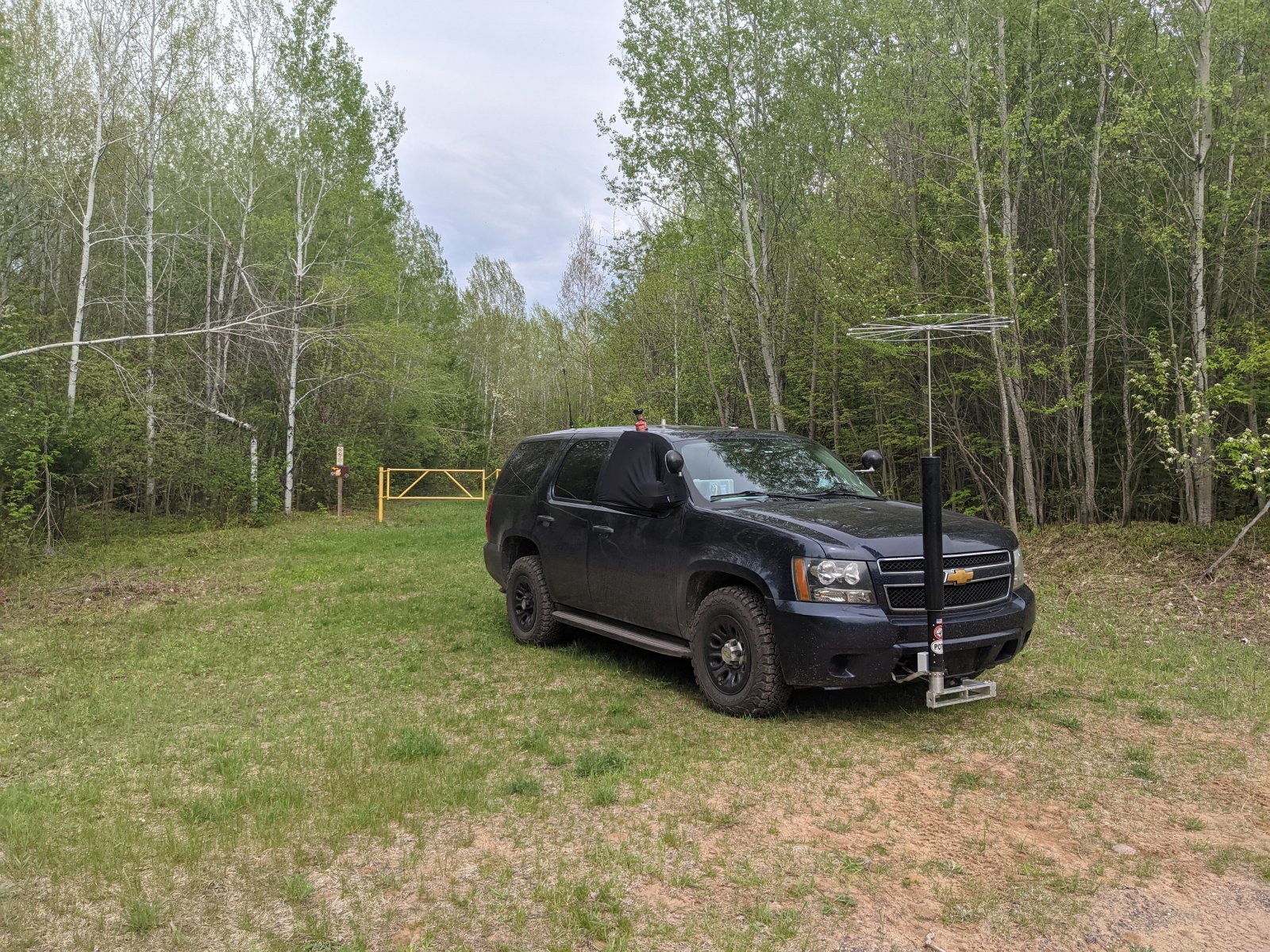

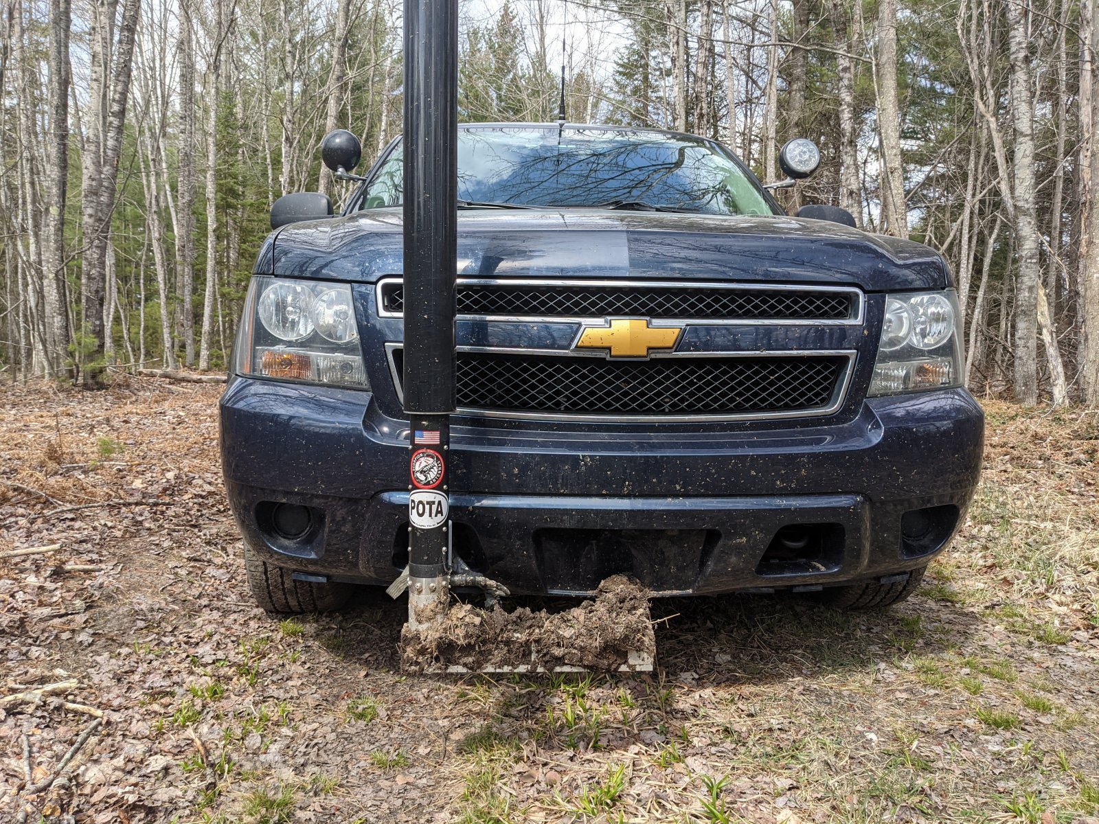

I got the Draw-Tite #65052. Since I wasn't planning on having a lot of weight on it, it's way overkill. Does a nice job of holding my antenna up though.
Also, had to remove the air dam, and coax the bumper to bend enough to let the receiver ride level. A heat gun helped move the bumper out of the way.

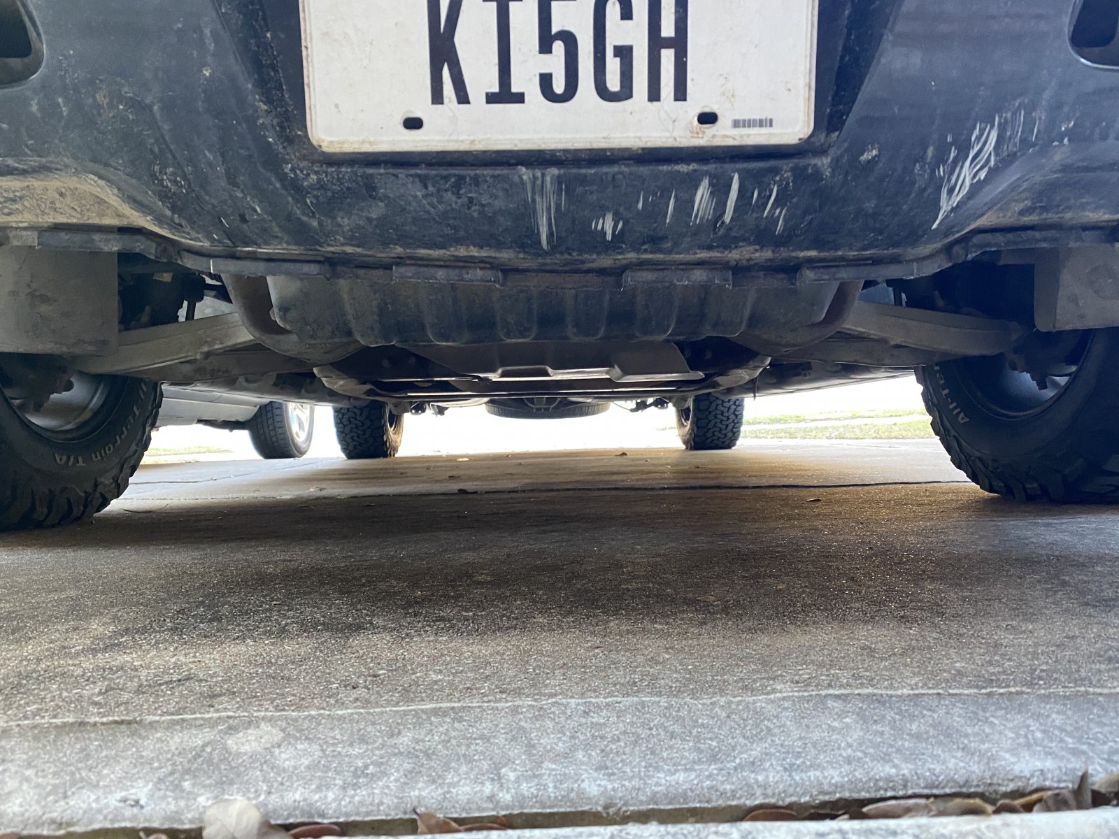

I hear ya on the approach angle. This was before I added the pushbar.

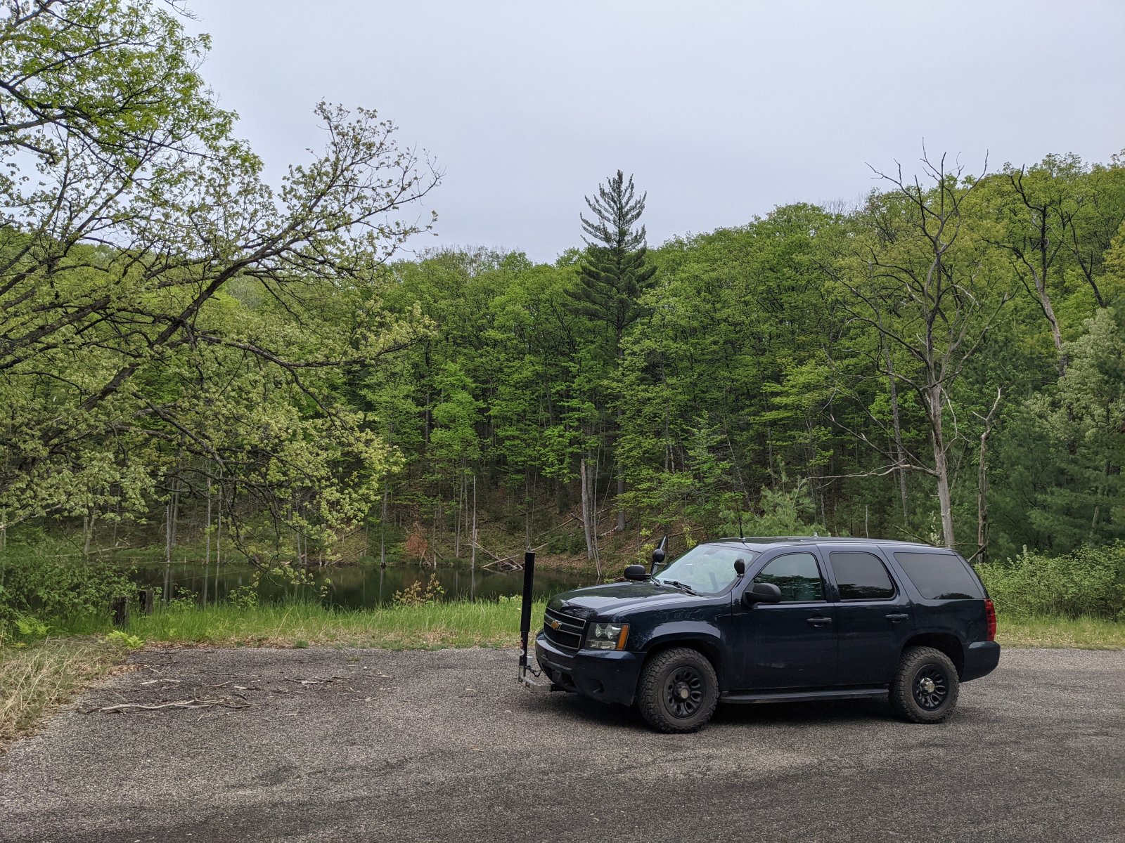

Just saw this post. Like how you mounted the rig. Interesting how you mounted that screwdriver out front vs the back. Do you operate HF mobile with the capacity hat on or do you remove it? Do you do any CW? Front mount could be challenging with this push bar on. Enjoyed the pix
Thanks for the kind words! I have operated mobile with the capacity hat on, though I no longer leave it on most of the time. Most of my operating is stationary from parks. We participate in Parks on the Air. I am decent at CW, but rarely call CQ. Mostly return others CQ, or operate in contests. We run mostly digital out of the truck, though a couple weeks ago I operated sideband for the Wisconsin Parks on the Air event.
I'm thinking I'd weld a tab onto a push bar setup to mount the screwdriver on. I know it would either need to be re-powder coated, or watched carefully for corrosion. It would get the feedpoint a little higher, and thus reduce ground losses a bit. I'd also get some of my front approach angle back.
Current projects include a 500w mobile amp for the rig.
73 de w8tam

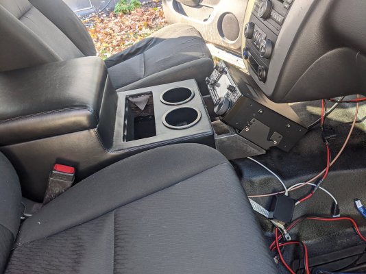

I bought a Jotto floor plate, then built a console.

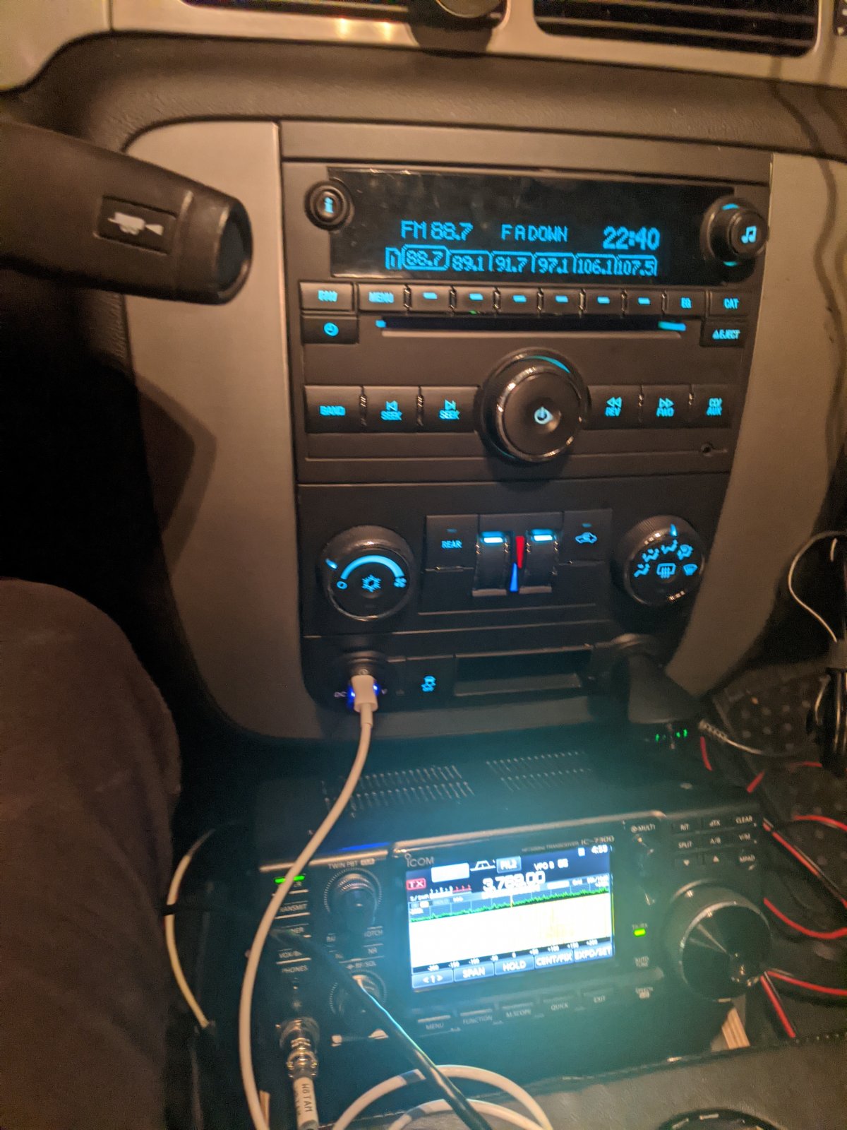

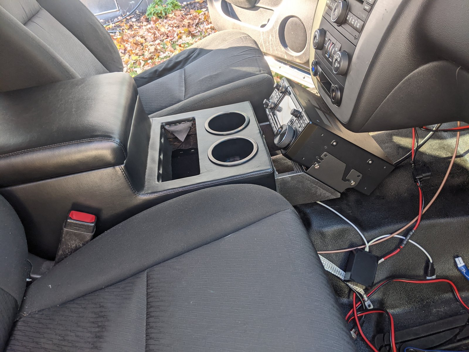

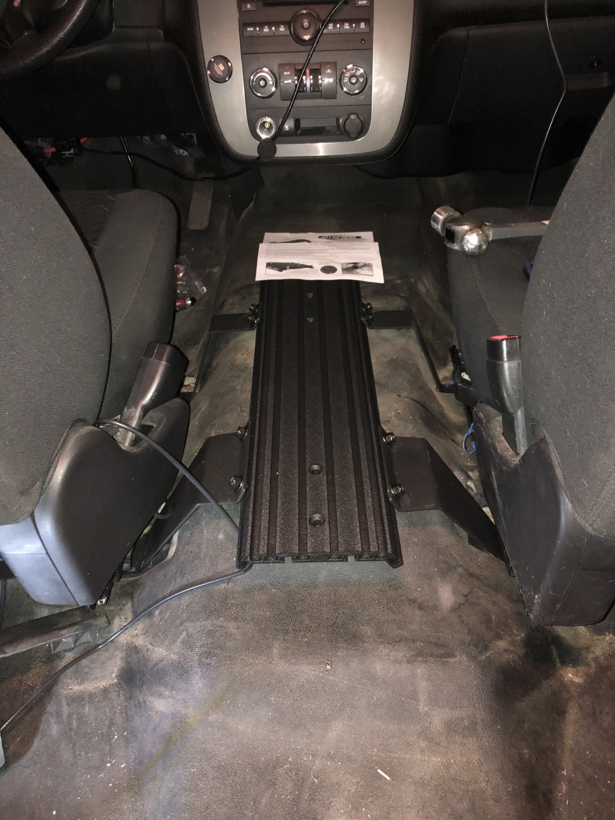

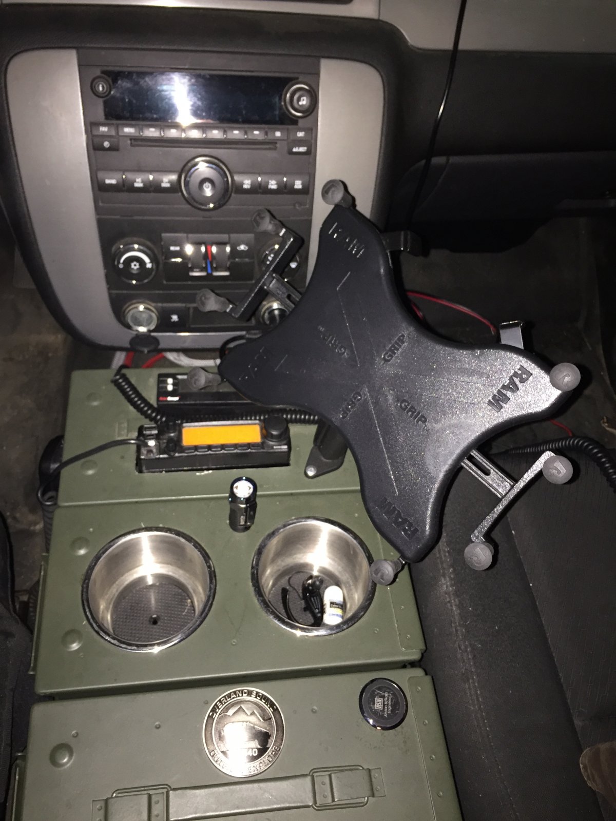

That's the center console I used. I built a little wood bracket that I bolted to the front of the console to hold the ic-7300 at a good angle.
Here's a photo while I was working on the seat install. Shows a decent profile of the Nenno console, and the bracket I built for the IC-7300.
I put in a battery isolator, and installed a second battery. My truck came with only 1 battery. After installing the isolator, I moved the 3 50amp circuits provided in the SSV onto the second battery. I call it the "house" battery, and try to run as much of the accessories off it as I can. That leaves the starting battery untouched by the radios.
I have a voltage booster with a PTT port on it hidden under the console. Boosts the battery voltage up to 14v for transmit, and doesn't cause any RF interference while receiving.
Currently running on the stock 160amp alternator, but I have a Mechman 370amp alternator to go in at some point.
73 de w8tam
