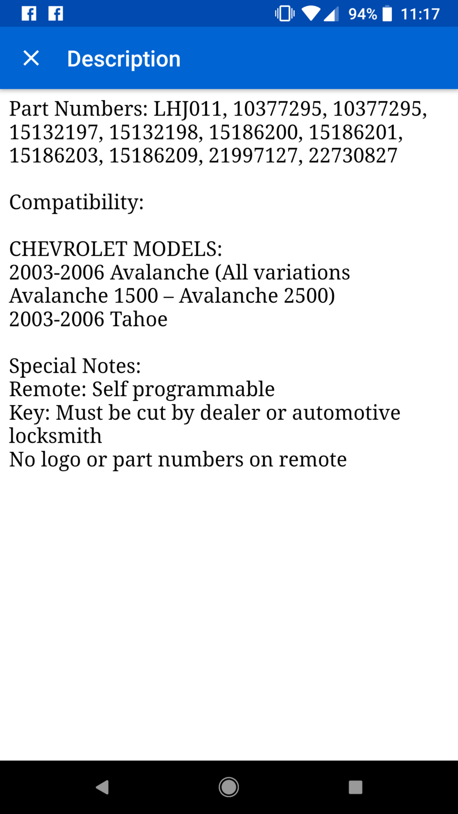

when I check ebay for the key fob I see it says it only fits certain part numbers so I didn't wanna get one and have to deal with returning it

Lhj011 that's it. The key is not chipped and can be cut anywhere. Fob programming takes 2 minutes in your driveway.
As stated above part number LHJ011 if you do a search. Here is what I bought on eBay; programming instructions included
https://www.ebay.com/itm/New-Keyless-Entry-Remote-Key-Fob-for-Tahoe-Silverado-Yukon-Sierra-LHJ011-W-Key/132403013148?ssPageName=STRK:MEBIDX:IT&_trksid=p2057872.m2749.l2649
I had the key cut at Home Depot for free. Had the remote working in 2-mins. Very cut & dry. GM only used the 1 model fob throughout the NBS years.
