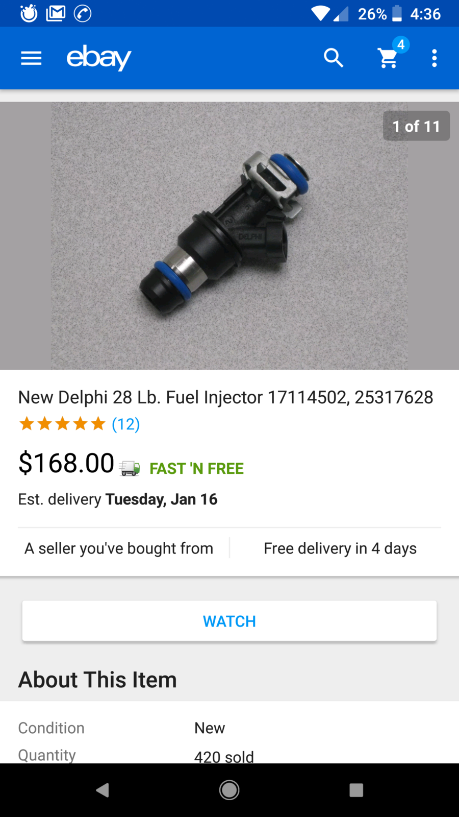

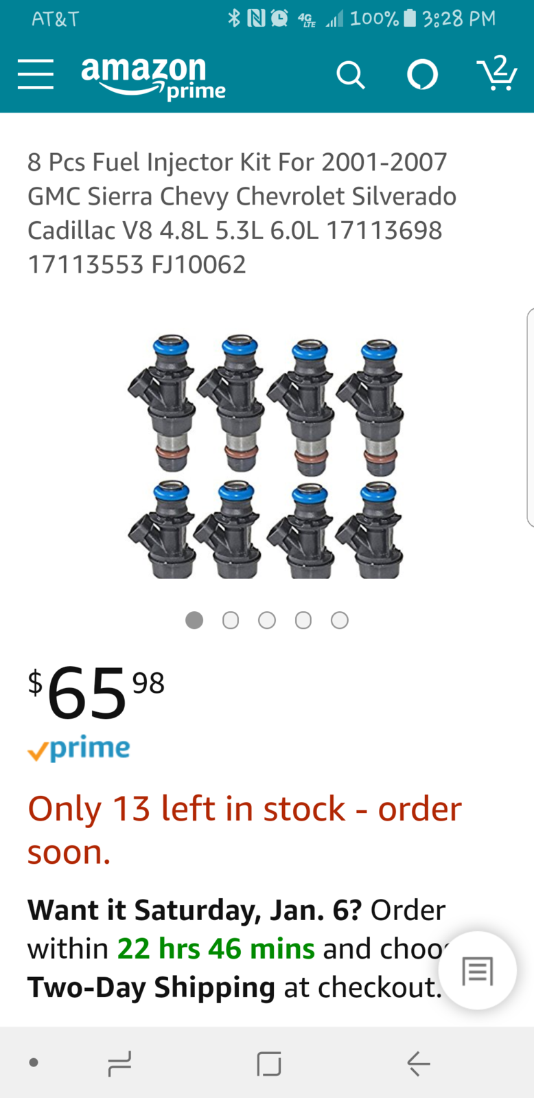

does the brand matter? or should I go with ac Delco or delphi

I' Not really sure. I'd think both are good brands. I'd check out the reviews.
the pic u posted was from a Chinese company selling on Amazon and has no reviews. that's what I meant

yesterday I changed the evap purge valve cause I was getting hard starts after refueling and my chest k engine light for p0171 and p0174 went away. I only did about 20 miles but so far so good. I also found all 8 Delphi injectors for $21 each but if this light stays off I'm gonna return it and get my money back. my next move is to figure out my ****** Mpg so I'm gonna change the oil, plugs and wires, and a new intake and see what happens. right now I only did about 25 miles and I already finished a 1/4 tank
33,185
51,399
Where'd you find the injectors, what brand are they?
