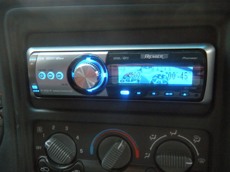

- Pioneer DEH-P8MP (6.5v preouts :) )

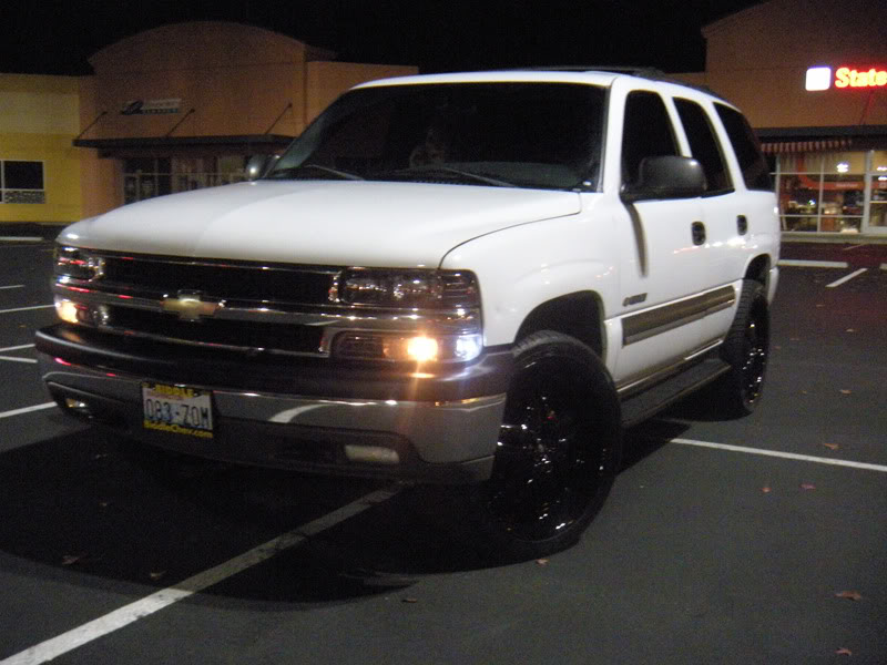

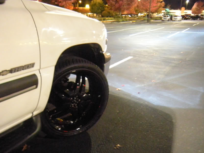

And heres the truck pics with the new rims, picked em up on friday:
---------- Post added at 02:59 PM ---------- Previous post was at 02:57 PM ----------
Couple daytime shots, great washington weather so they are not the best

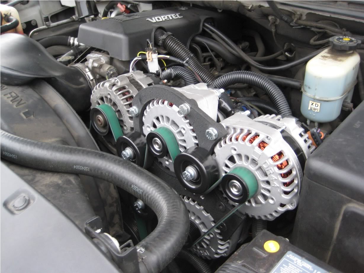

And heres some of the Powermaster alternator me and my buddy put in, if your looking for great alt's with good idle numbers, I highly recommend calling or emailing mechman, his website is www.mechman.com, great customer service and killer alt's

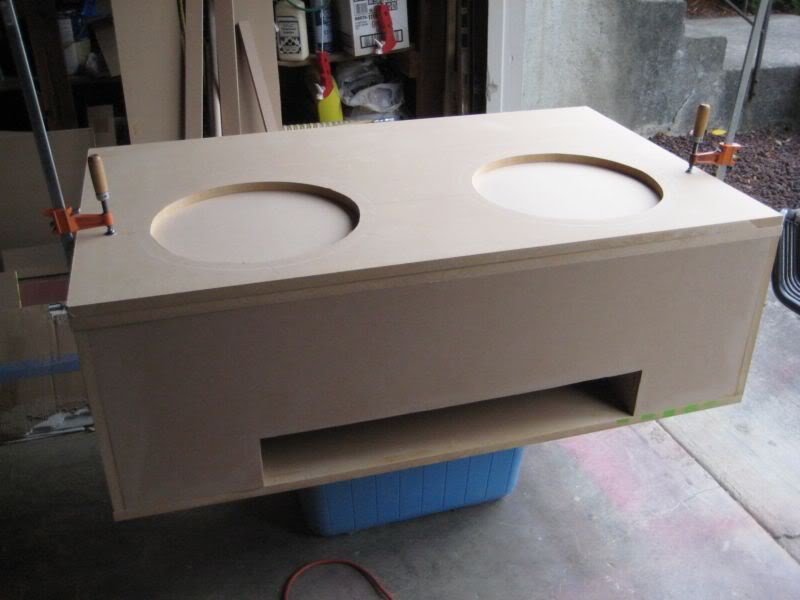

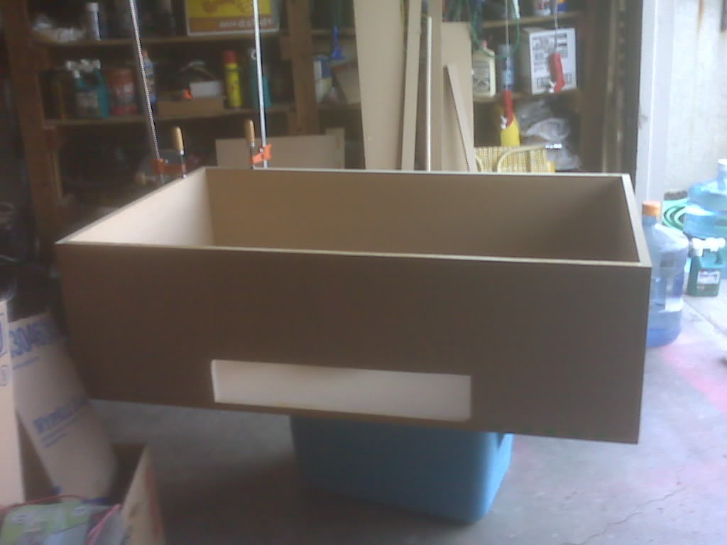

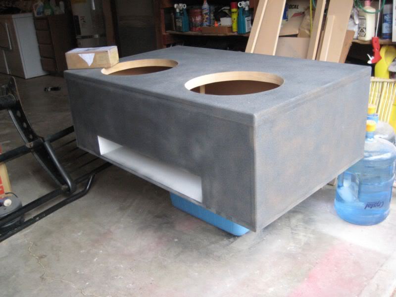

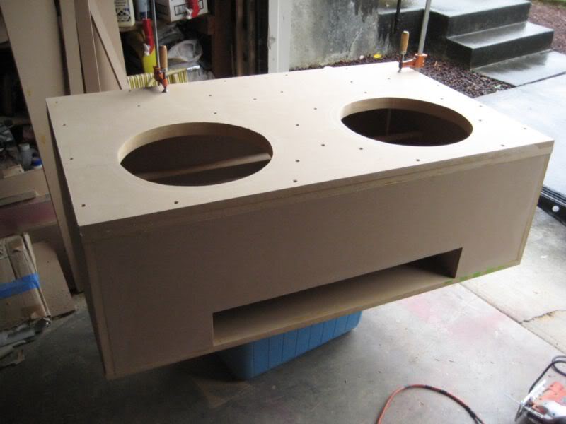

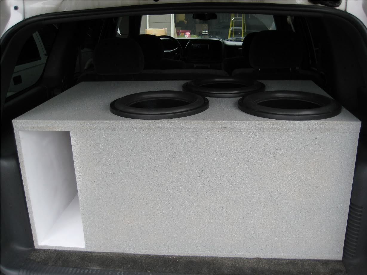

Heres a quick pic of my new box, still touching it up but its pretty much done. I have a third dc lvl 4 15'' coming tomorrow. This will be in this sunday. Box is 14 cubes tuned to 38 hz for a meca comp that is the 26th of this month. It will sit right at the height of the rear seats, I will drop the tuning after the comp.
NoPh33rRaCiNg
NoPh33rRaCiNg
Nov 15, 2009
408
Kent, WA
Got everything up and running today, its pretty loud. Got it on the termlab, managed a 150.1 @ 41hz outlaw meca style. Sub still needs some break in for sure. I deadened the rear hatch the day after i got it on the meter so ill see what it does in 2 weeks when its broken in. Met up with 2 buddies today also and got a vid of his tahoe with 4 15'' memphis mojos off an RD Audio D9(6k+ rms), quad alts, one stock and 3 DC 270 amp alts.
