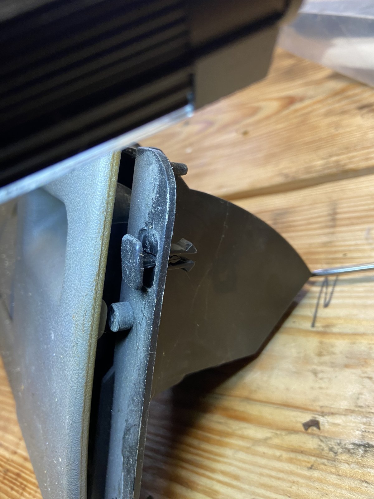

The passenger side door inner panel needs to come off to replace the outer handle. I've tried pulling and prying like all other door panels I've ever removed, but nothing is happening. I only see two screws inside the armrest. What am I missing. When I went out to take the picture above, I realized the bottom of the driver's door was loose. I see the pins and one of them (as well as others) is obviously broken. Are they supposed to be reusable or are they sacrificial?
I don't want to force anything and crack 25 year old plastic panels.

Check YouTube on the door panel, but there are the two armrest screws and the rest is just plastic clips. Pop the triangle piece off that is by the mirror as well.
