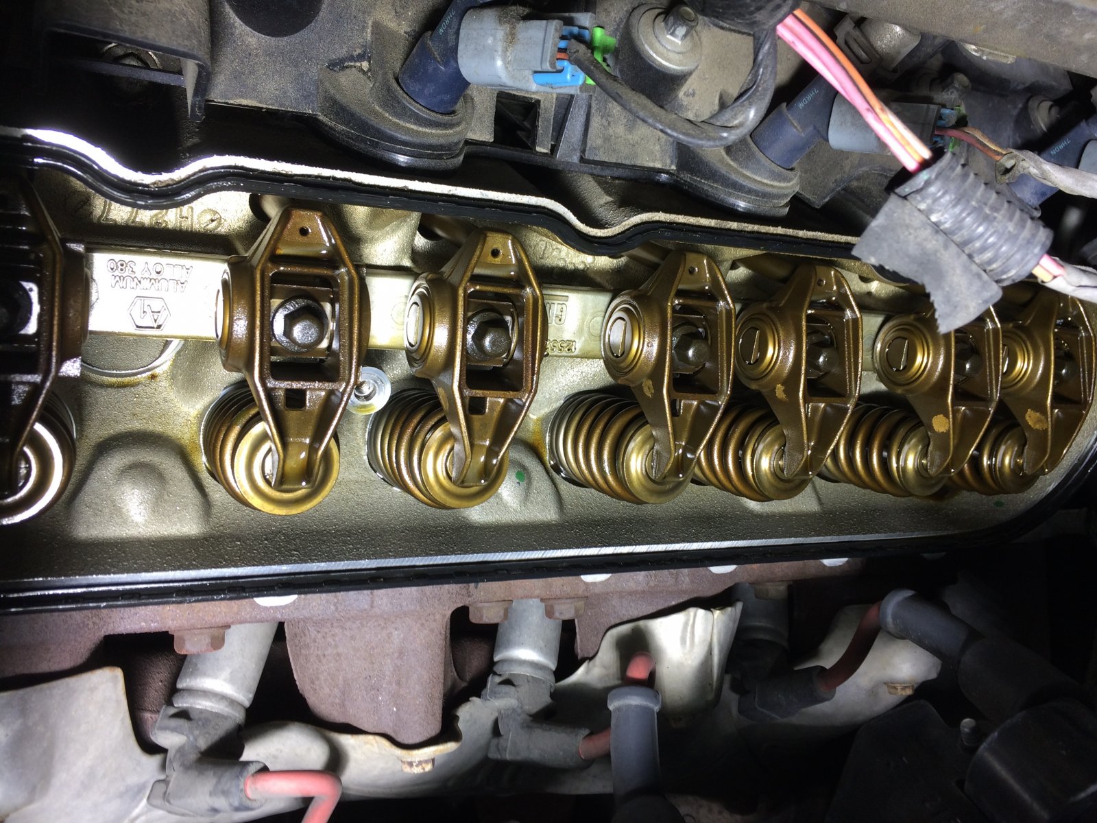

If you've been running good quality synthetic, you shouldn't need anything. They're too easy to use improperly and can do more harm than good. Diluting and thinning out the oil doesn't set right with me. Adding a harsh chemical to abruptly break away chunks of sludge can cause problems worse than the sludge might be causing.
Take an hour of a weekend day to pop off a valve cover. This will tell you just how clean your engine is on the inside and if you need to take any actions. It'll cost you nothing but time but can save you thousands.
Here's mine around 190K after my ownership since 146K and running Pennzoil Platinum with maybe one or two cycles of Mobil1:
No sludge. Just some oil staining on the rockers and springs. An engine flush additive would only dilute and water-down the oil. Not necessary and not worth the risk!
