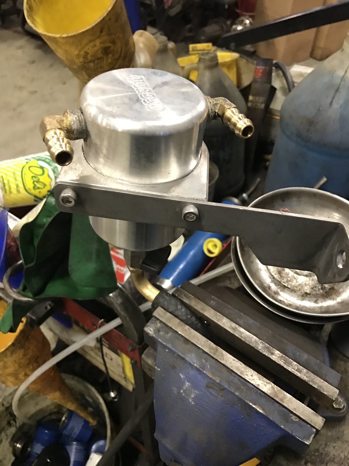

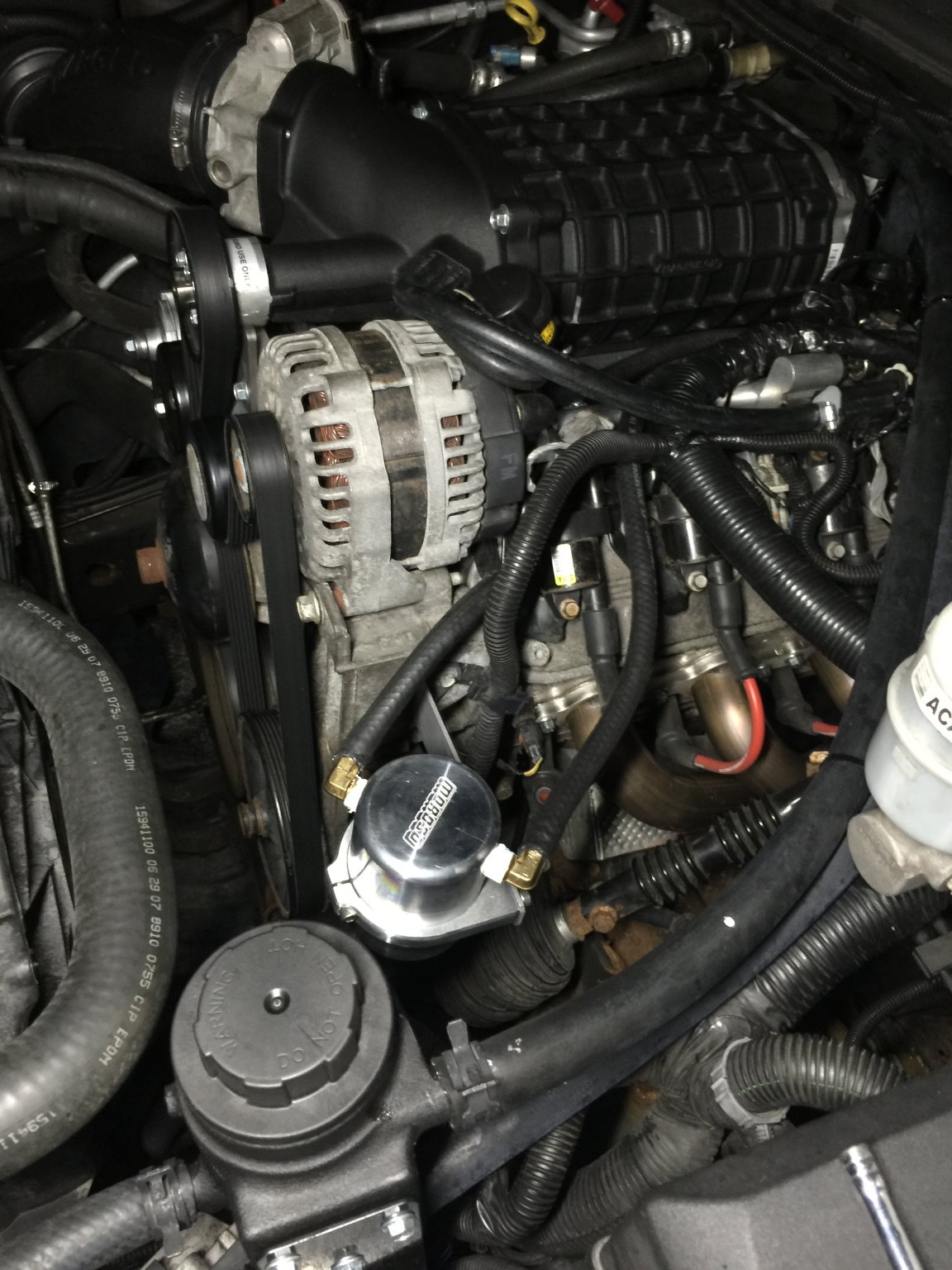

didnt work well with my supercharger. It seemed to cause more of A restriction. Less than 500 miles on it. Originally had teflon tape but oil made it loose and start to unscrew. Ended up using oil resistant bond to hold in place. $125 shipped

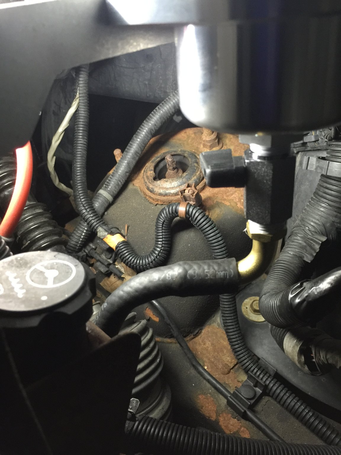

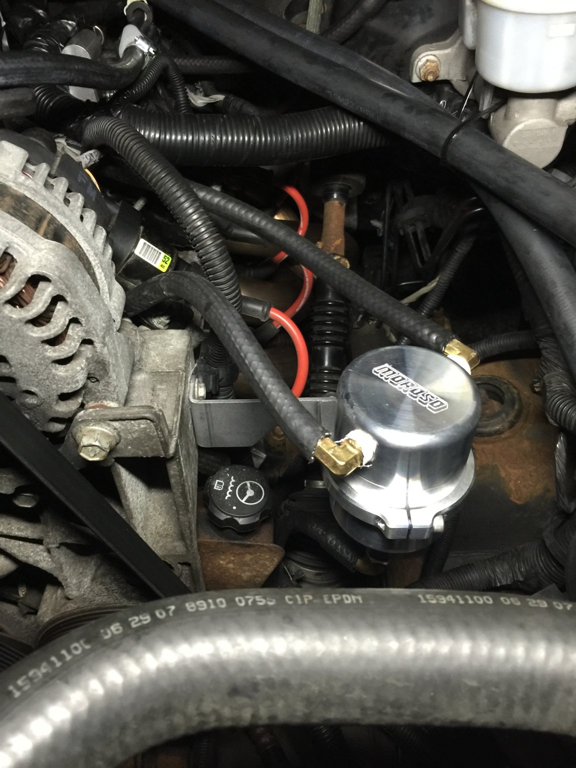

Install was easy. Broke the pvc connector on the intake mani, so i jb welded it back on. I have a oem manifold in the garage.

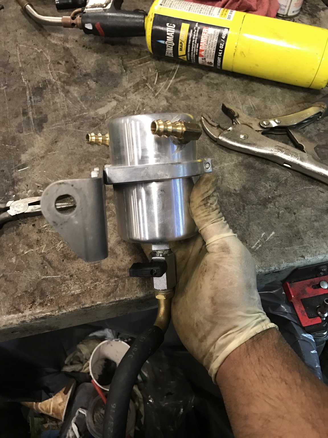

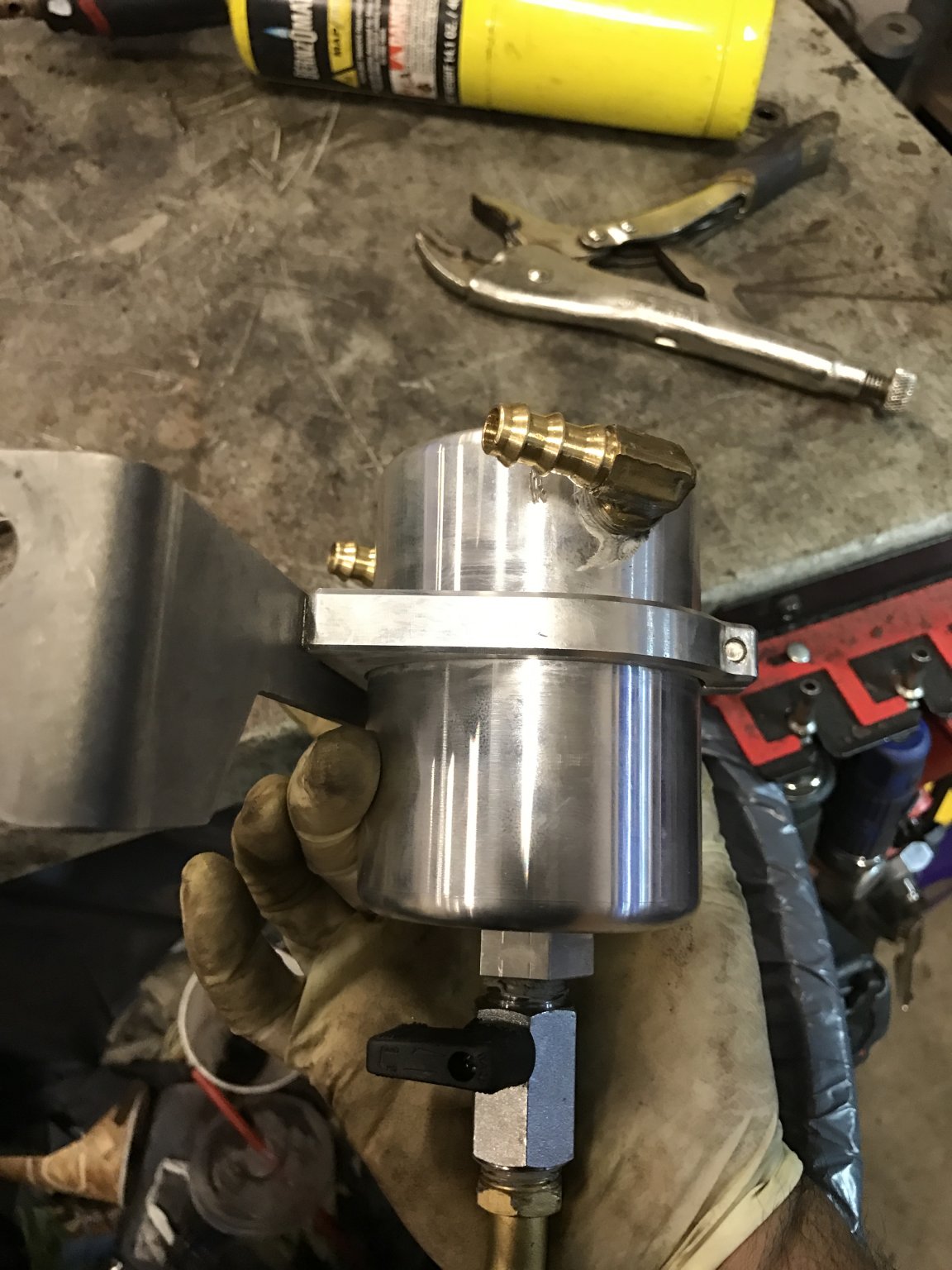

It works. After 2k miles, I drained about 2-3 shot glasses worth of oil out. I put a line on my drain that reaches almost to the middle of the wheel well. Open and let it drain, of course, not on my property.

I routed the drain to the side of the skid plate. I slide an oil pan under it, open the valve and let It drain for awhile. As for the noise yea it sounded like that
