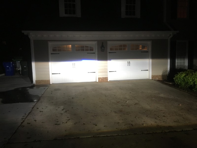

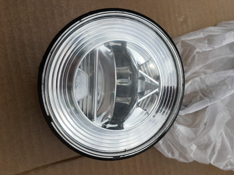

So I got a set of the black xb led fogs and hated the black color on my chrome front end Denali. So I found fast headlights that sold some chrome versions. I worked a deal to separate my fogs and send them the black inserts to be chromed. Took a few weeks to get the turn around due to batch shipments of chrome process. It was a pain to separate but managed it and resealed with butyl. Then clear coated the lenses and installed. The output is significantly better over and drop in led or hid bulb setup! Well worth the money if your serious about light output. Here are some pics of the process.
