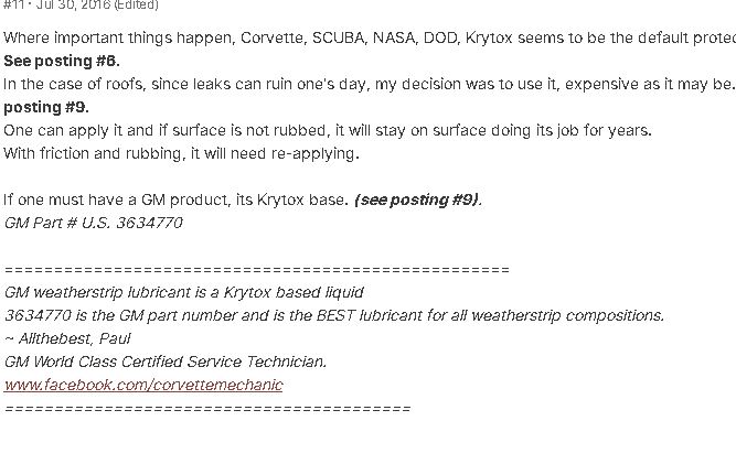

ya that lube is not cheap, not the good stuff anyway, I bought some last year this was like $50
the small 15ml bottle is $25 this 2oz bottle is like 4 of those
gm parts sells some for the corvette targa tops too. it was dumb expensive for like 2oz bottle. but it worked and those cars are plagued with noisy and popping tops when you drive.

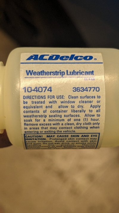

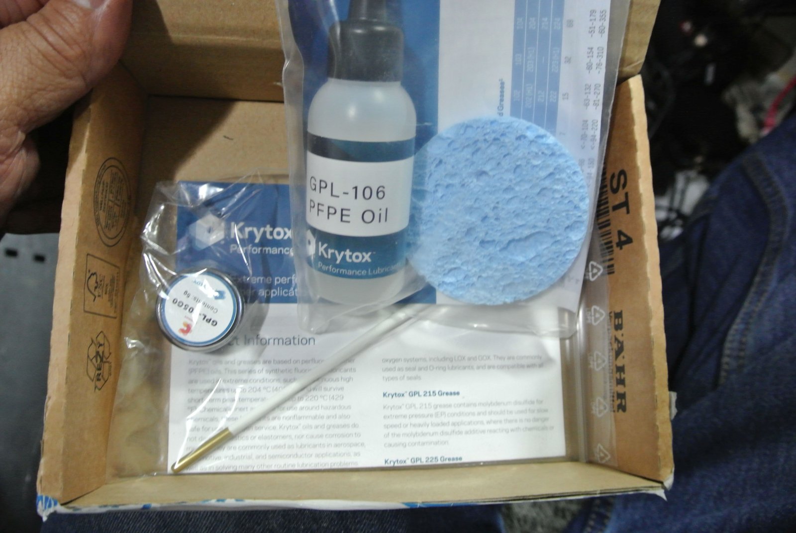

I'm not sure if you can find it anymore, but the oem stuff is pretty good for me. you put it on, let it soak in and then wipe off the excess. since I've been using it my 08 weather stripping feels better than some new gm's I've looked at. but I also have nothing to compare it too. I bought the car, the top drove me crazy and before I sold it, I tried this stuff and it worked.
other brands are probably good too
the oem stuff is gpl-105 pfpe
