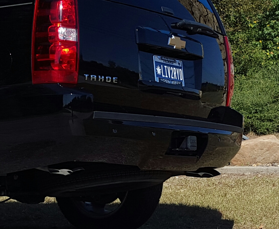

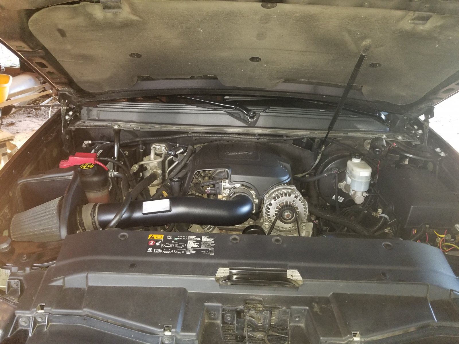

K&N cold air induction and Borla exhaust , dualed out in addition to the tune
