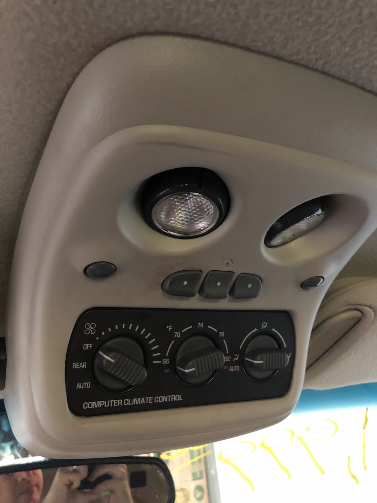

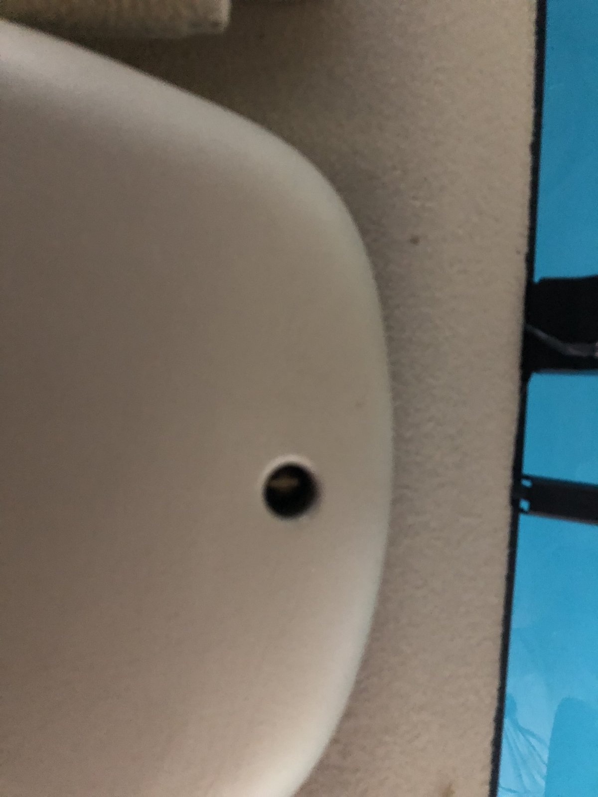

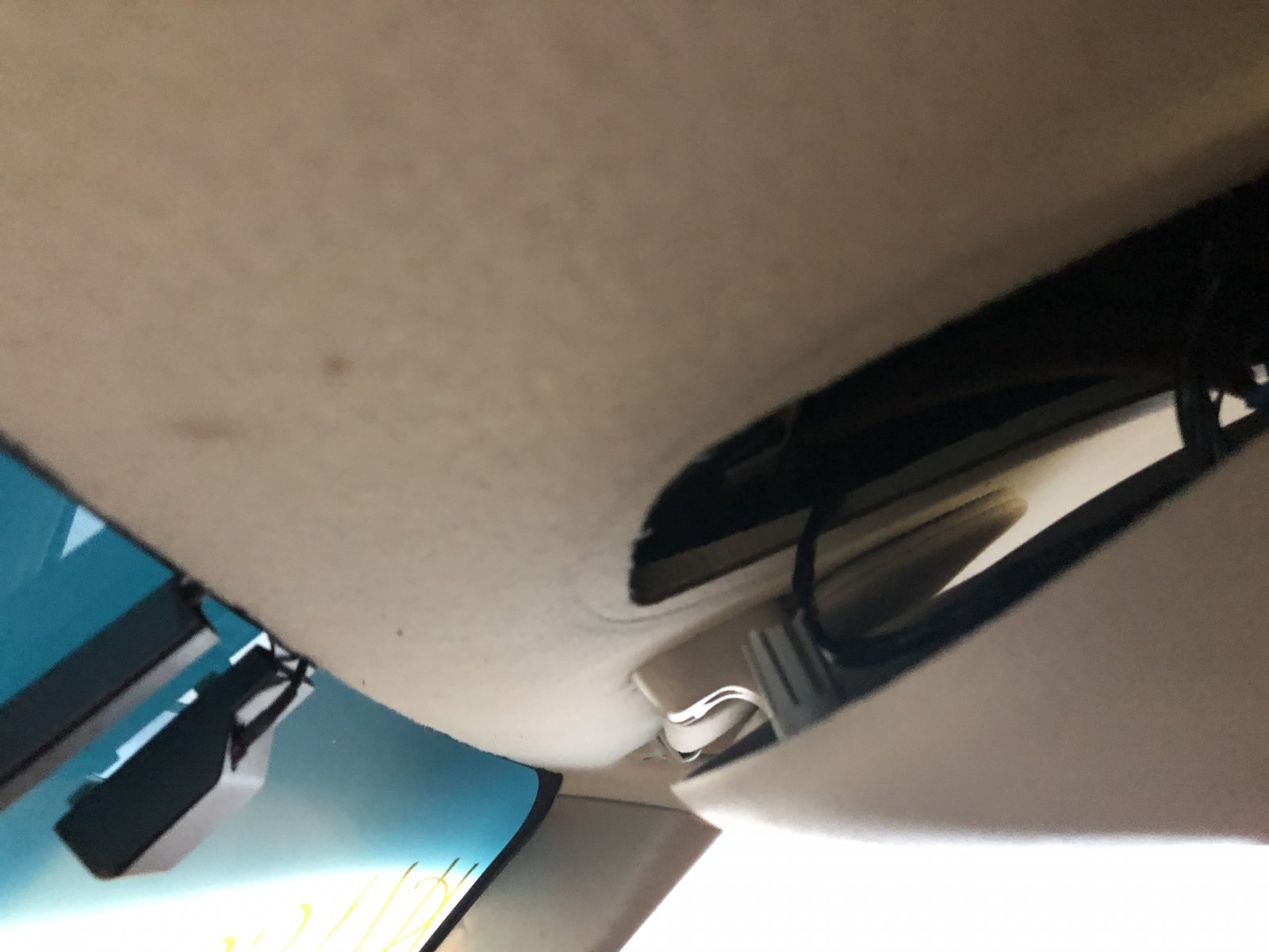

    2002 Tahoe. I have seen some posts alluding to this problem but have yet to see the actual solution. I am missing the screw that goes in the back of the overhead climate module. Any idea what size screw would fit?

    it's probably a typical 7mm screw, no junk drawer or bucket of nuts/bolts laying around? whatever fits will work

    maybe see what fits after the plastic part? without going thru the plastic first

    There was a carpenter screw in mine, got the factory screw from work.

    @NickH2002, #8 x 1" round head sheet metal screw. Goes into a speed clip - type thread. Technically it probably calls for a metric screw but the threads aren't really critical due to the speed clip.

    Worked like a charm. Appreciate the help everyone.
