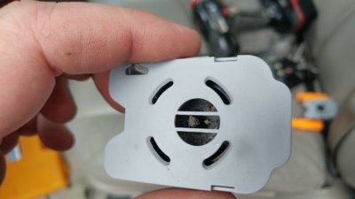

Replaced mine today. Hopefully no more hum. Old one was full of dust and junk.
New one looks slightly different.
Screwed up the a pillar cover though damnit... Hopefully plastic weld putty will hold it in there.
