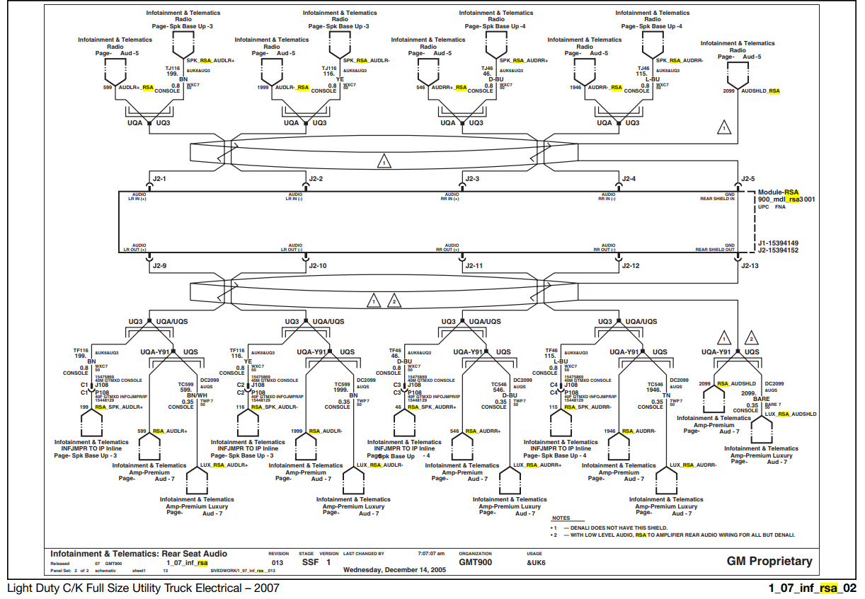

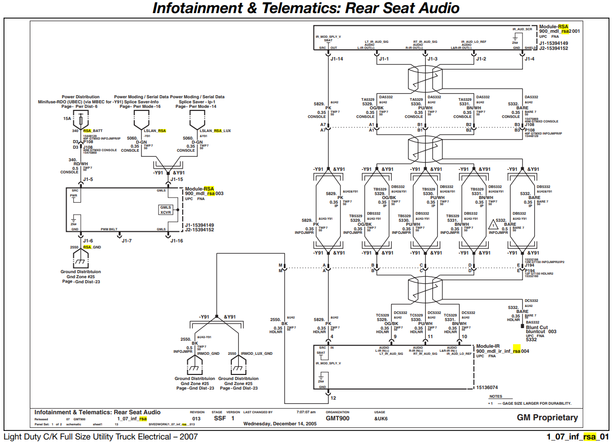

I do not know the pinout but you can probably find it in the GM upfitter guide (full size electrical)

Thank you!
The green plug of the radio control must be bridged from top to bottom to bypass this. Unfortunately, that did not solve the problem and the humming also occurs with the radio unit bridged. So my guess is that the Bose amplifier has a bad ground connection, the amplifier is defective or a speaker is short-circuited.

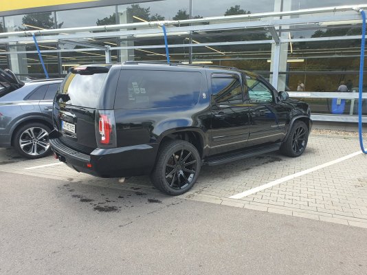

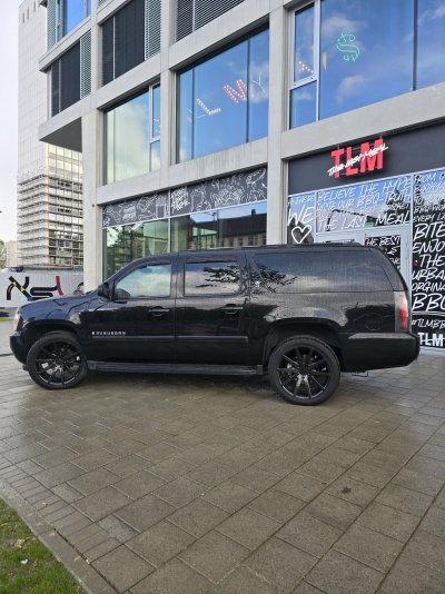

Thank you for the good reception here!
I have attached some pictures. There are a few things that need to be modified in order to be allowed to drive an american car in Germany.
