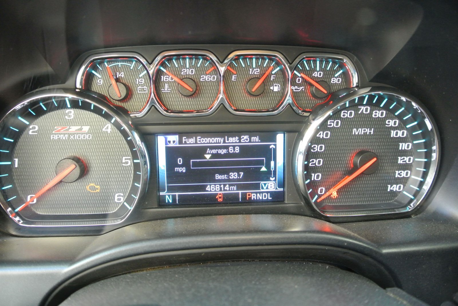

when I bought my Silverado it was lowered 4/6 and got pretty decent gas mileage, then I lifted it up 4.5/4.5 level" and gas mileage got halved, I can still get 14 or so out of it if I just drive like a sane person, and it gets up to 34 apparently if I really baby it. This shows my more "spirited" driving lately, lol
According to the mileage and fuel gauge, you must have just filled up, lol. That's good information, thanks. 34 is amazing; best I've gotten with my Tahoe is 21 on the highway.
30,750
48,438
when it was lowered it got much better I cleared it out after I had it lifted because I couldn't believe the drop, o'well I get to have more fun with it now.
