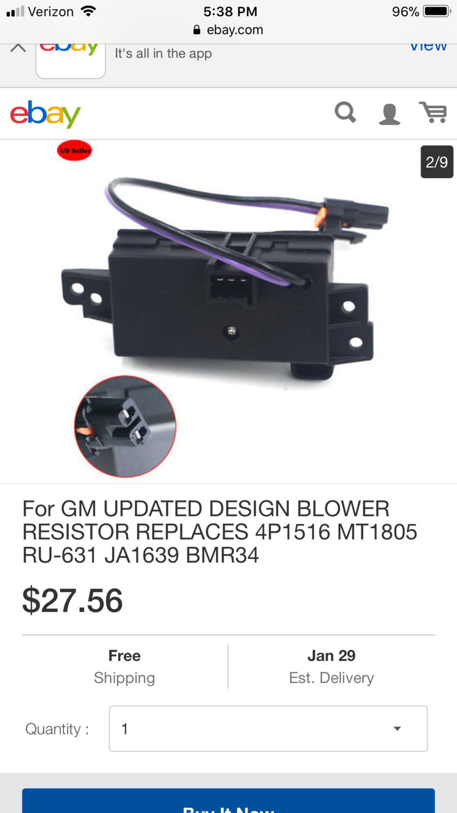

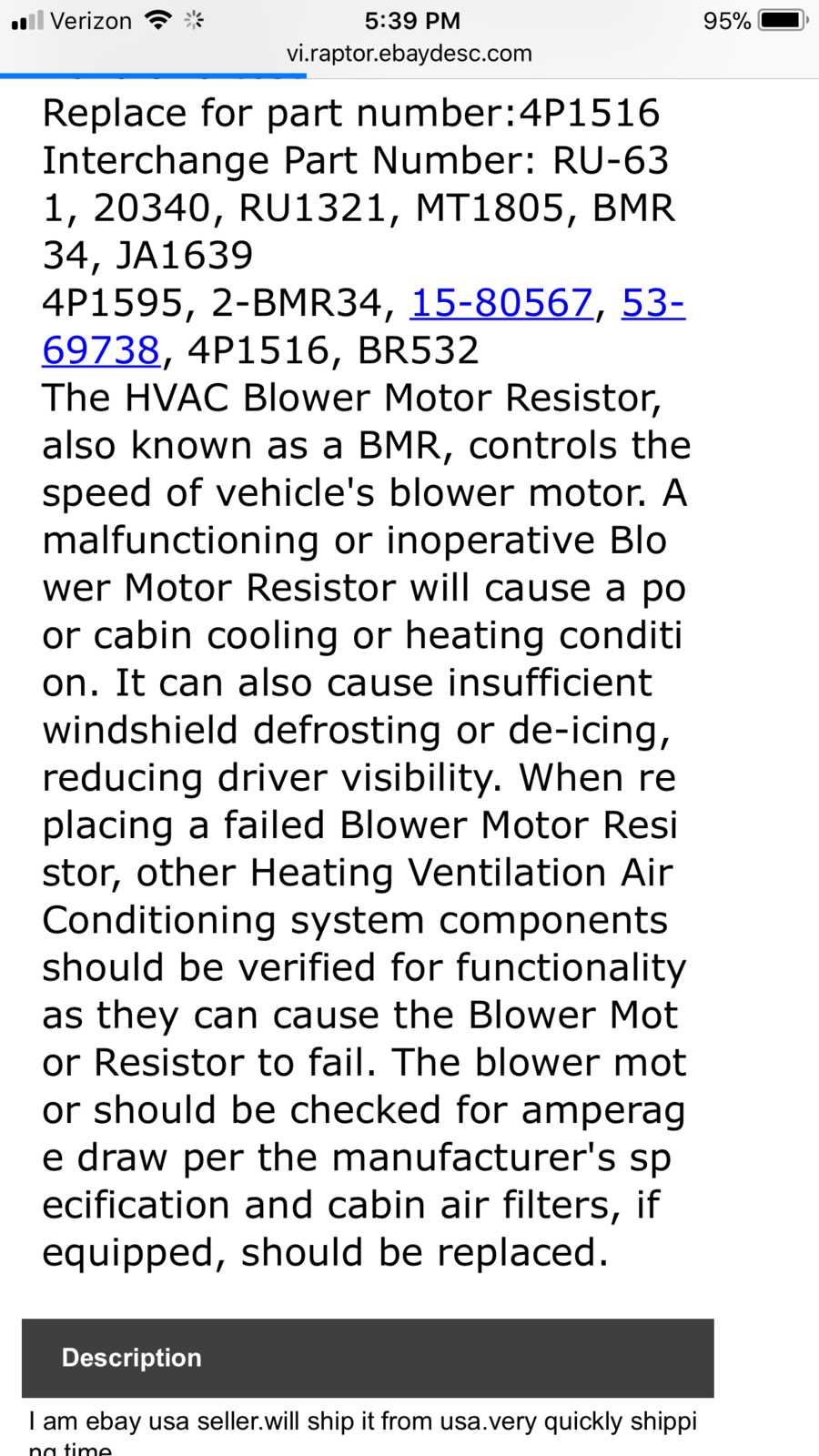

So i have a 3 pin that goes to the resistor. All that I'm seeing forsale is a 5pin. Even called the dealer they said its a 5pin.. WTF????
I definitely only have a 3 pin.
