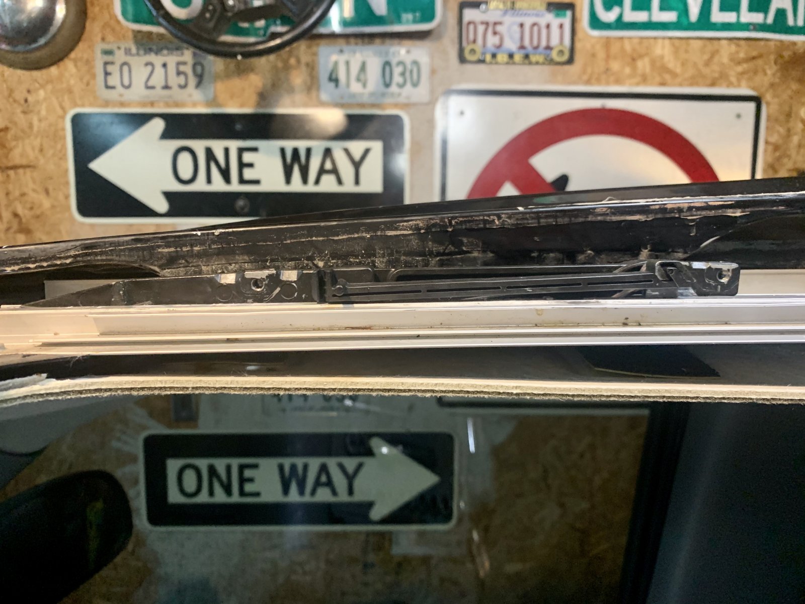

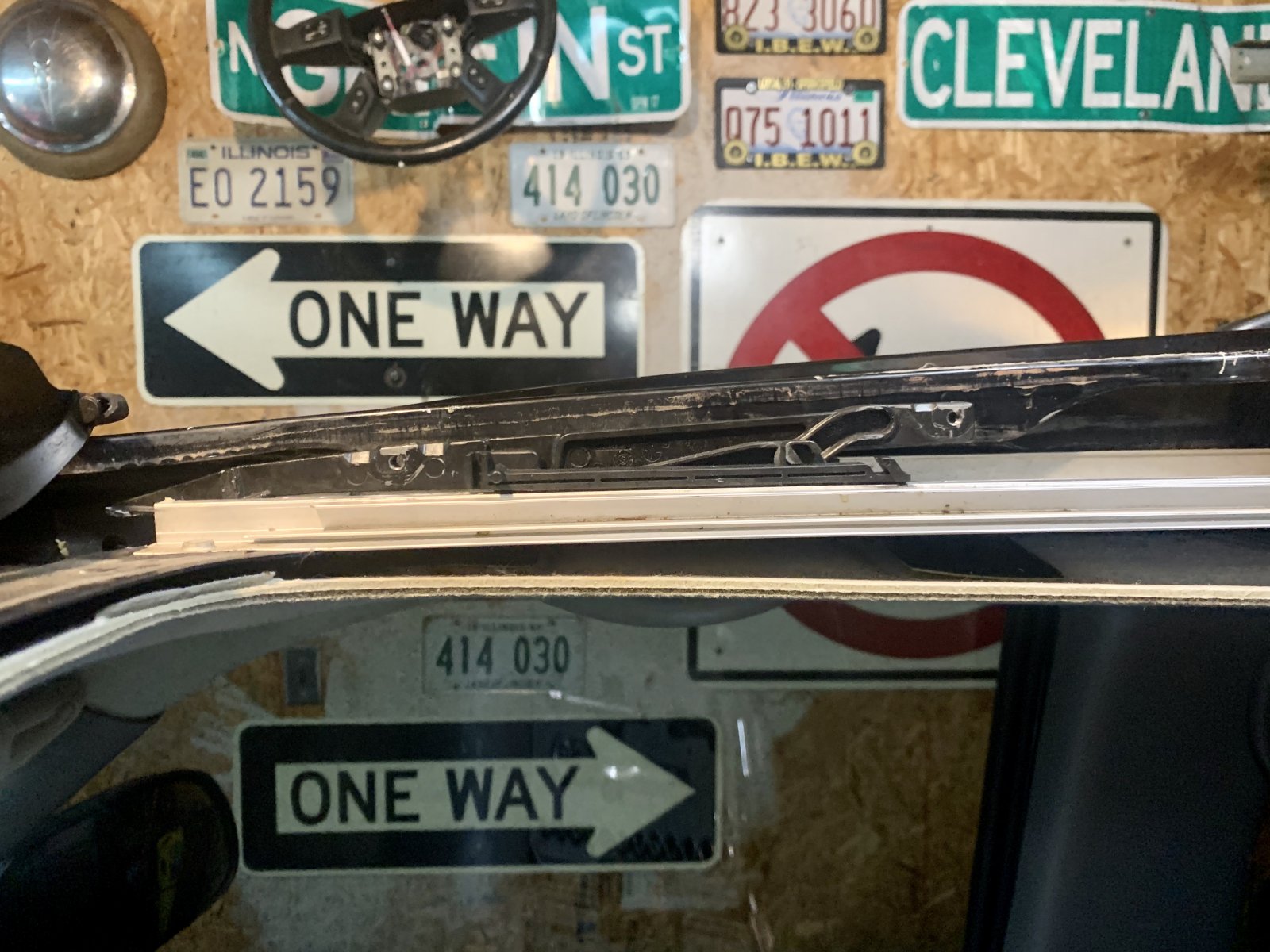

Since I purchased my Yukon the sunroof has never worked. I finally picked up the new track pieces and decided to tackle the job today. It turned out to a lot more of a job that I was expecting. While replacing the broken track pieces I noticed the track that on either side was even with each other. There was a difference of 4” from one side to the other!! My guess is that the plastic track broke and the motor was disconnected and the sunroof forced closed. I ended up having to drop the headliner and pulling the sunroof motor to even the 2 tracks up. The problem is that I’m not sure where they should be sitting exactly. I set them where I thought was right but when I push the button forward to the vent mode it doesn’t seem like it will go all the way up. The very front part of my track measures about 5/8 of an inch from the front. I will attach a pic for reference. If someone wouldn’t mind measuring where theirs sits for me so I can make sure mine is set right I would REALLY appreciate it!!!

It’s a little hard to see but here are pics of the track at normal closed and vent.

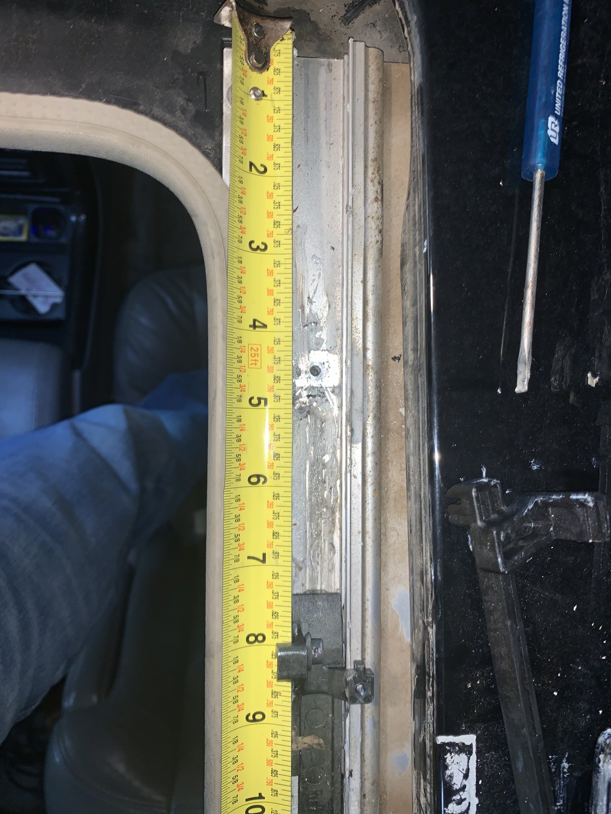

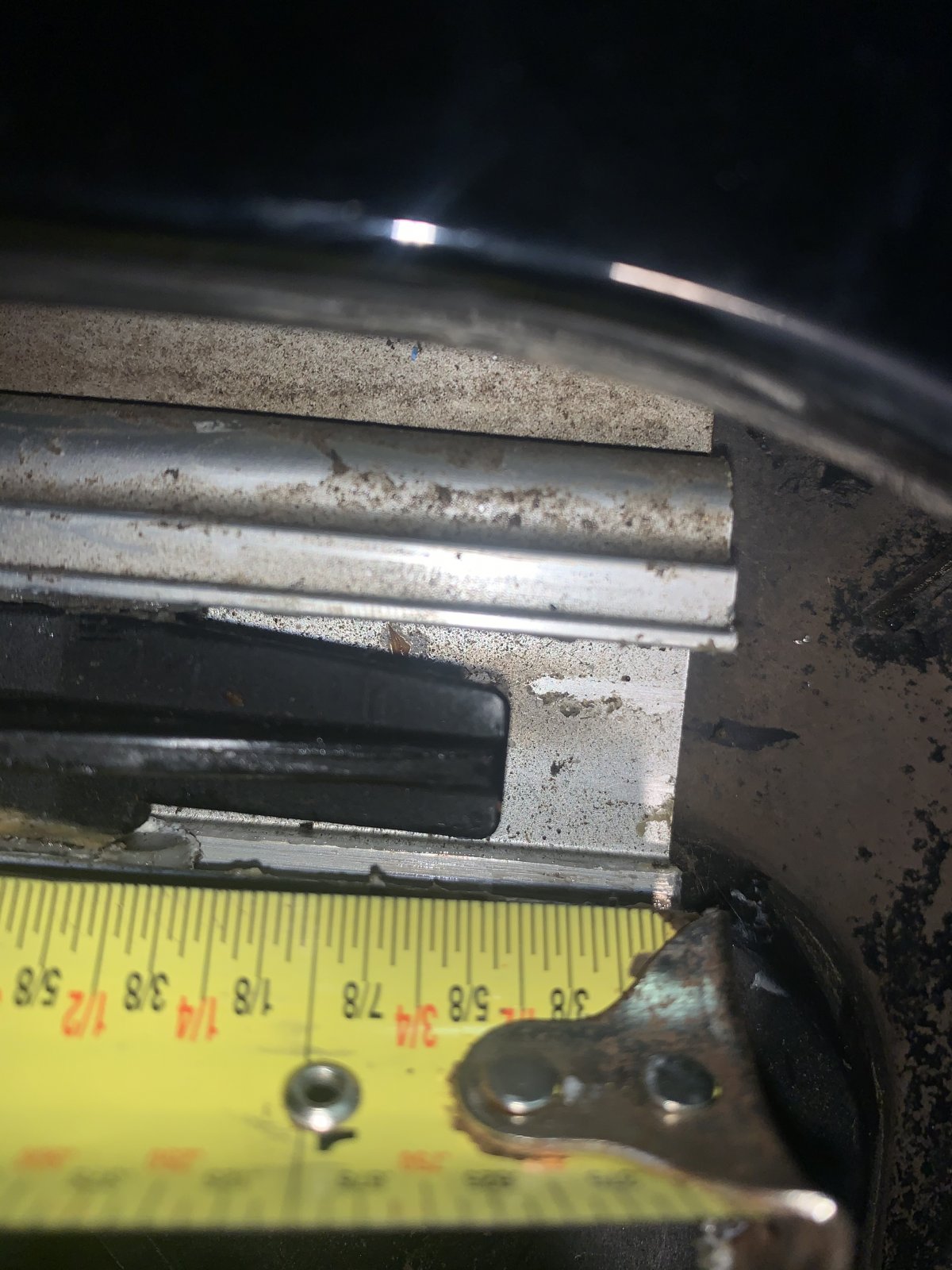

Ok just an update for anyone else that encounters this issue. The main piece that pushes/pulls the sunroof should be sitting between 7 1/4-7 1/2” back from the very front of the track in the normal closed position. I will attach a pic of the piece
