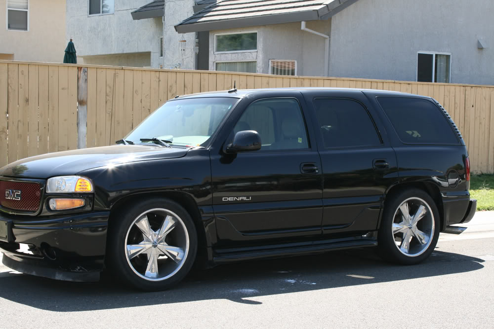

Thats my 3/5 on 305/40/22s
Rubs a LITTLE when the wheel is fully cranked left/right (not enough to cause damage to my truck or tire)
No, you dont have to pull anything out
No, you will not regret 3/5...HOWEVER, almost everyone here who has a 2/3 regrets THAT...and would have rather got 3/5...because a 2/3 usually dont look like anything was done
Welcome to the site, be sure to post more pics
