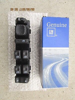

I am having problems, intermittently, with the door lock-bottom rocker switch, of the master door switch assembly on the driver's door. Intermittently, the door lock will not react as should when lock or unlock with my finger. With the key fob, no problems. I was wondering if that switch is available. When I try to look it up at RA, all I get is the complete master switch. I do have power folding mirrors and the adjustable pedals, if that makes a difference. If the switch is not available, by itself, can anyone tell me if the GM assembly is available. Thanks for any help.

What's the last 8 of the vin#

5R221385
Do you know if a replacement like this is "plug and play" or has to be mated with a Tech II

@915_Tahoe, I punched in that GM # at ebay. A genuine gm part came up but when I use the ebay "see if it fits", it says that GM part number does not work. I trust you more than ebay. When I look up at RA, it asks if I have power folding mirrors and I do. It also asks if I have adjustable pedals, which I do, but that is not part of this switch. It is a whole separate button that is mounted in the door panel above this master switch I am looking for. Got any ideas?

@915_Tahoe, I dug deeper and found that the part number you gave me does cross to a Standard Motor Products part #DWS394 and when it gives to options, it only says: with adjustable pedals and with keyless entry.

You have RPO codes:
DL3 (power fold, t/sig.)
JF4 (pedal agj.)

I completely agree. At RA the only options that match the GM part # you gave me, is the adjustable pedals and keyless entry. It does not say anything about power fold mirrors.
Like I said, at ebay, when I use their "see if it fits", it tells me the 15883319 does not fit my 2005 Z71. It is a Genuine GM part number part and has the sticker on it for 15883319.

@915_Tahoe, belay my last. The same seller has the same part listed 3 times. One for a Suburban, one for an Avalanche and one for a Tahoe. When I check the ad for the Tahoe and check the "see if it fits", it says it does. I have no idea why he did not have one ad for all 3 vehicles/trucks. Thanks again.
