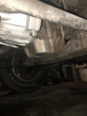

Coolant is good. Compression is an average of about 185 per cylinder. The oil filter is a good idea but like others have said that the underside would be coated in oil. Just to show that I’m not bullshitting here is a picture of the underside of the Tahoe. I honestly think it’s either going out the Pcv (the reason I just spent $65 on a valve cover) or someone is screwing with me at the shop.

And yes that’s a new built transmission. 4L70E. 5 plantary gear sets corvette servo bigger boost valve and a high performance Sonnax output shaft since the last build I blew out the output shaft on launching. I guess too much weight to horsepower
