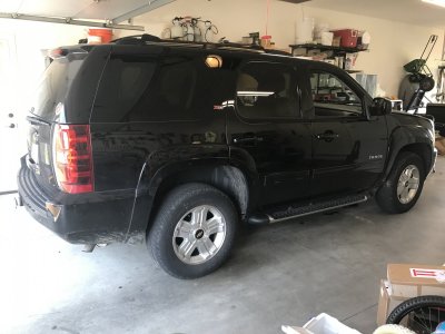

Love the Z71 Tahoes, got any pics?

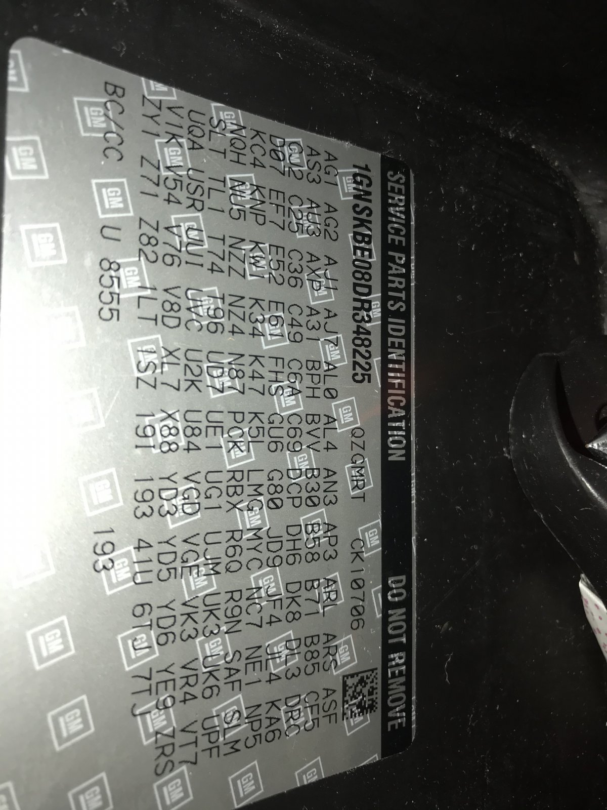

Codes for vehicle and picture! Will work on getting updated in profile.
BA0F614B-4BE3-40CA-9F20-220C6A31EE03.jpeg 42133FD5-1F94-4B8D-BFC9-FBE1A690F32B.jpeg

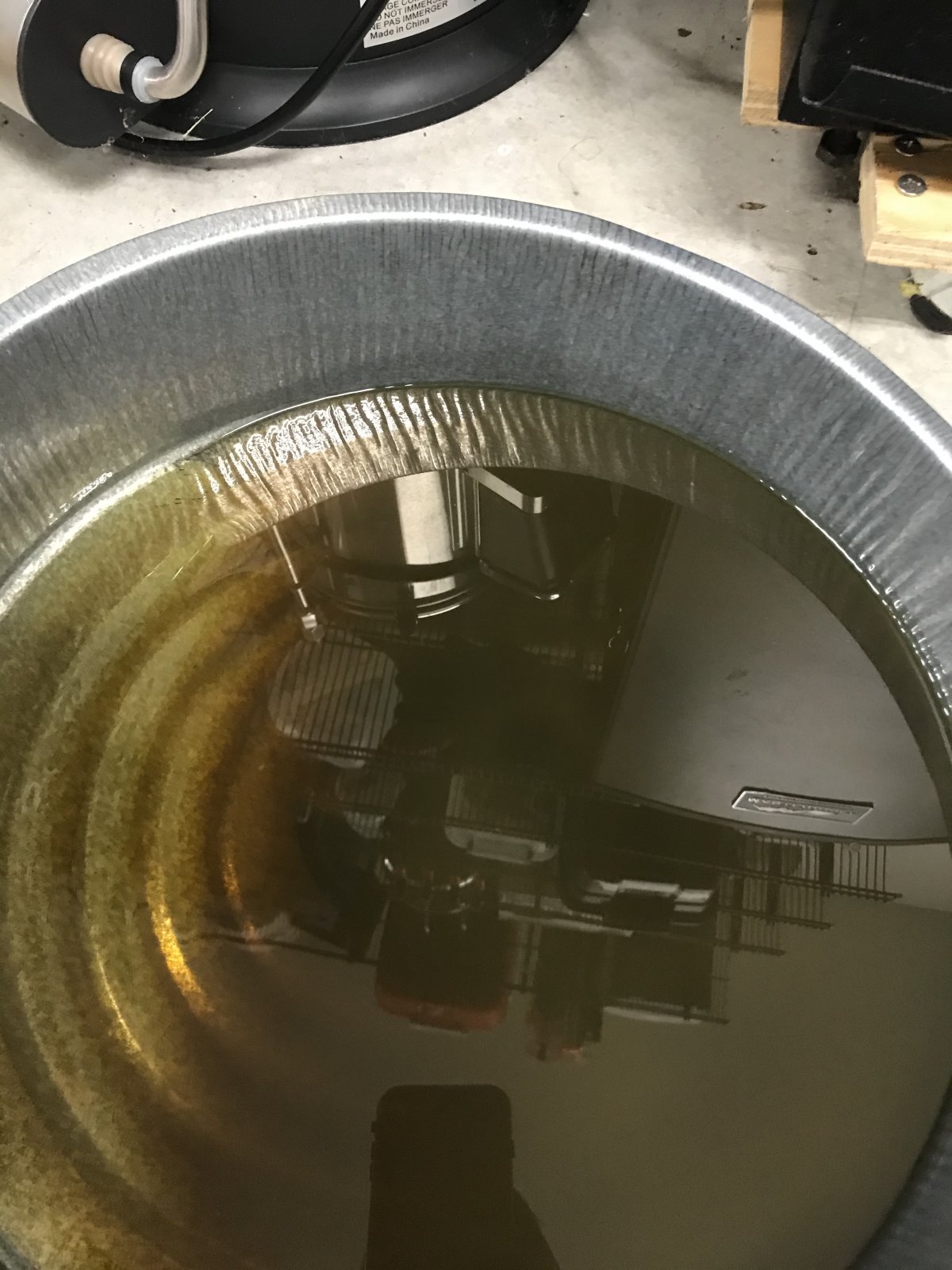

today I did the plugs and wires, and front diff fluid. For the plugs, once I figured out the scheme of things it went fast. Started with #8, came off easy Thanks to online tips for extensions, but getting the new plug in blindly was a challenge. The wire and heat shield were difficult too on #8. The rest were easy. The factory had plenty of lube on the plugs/ wires. So I have a spare set! The biggest problem was hearing/feeling the plug engage with the metal clip in the wire on the new ones. Front diff fluid was changed. Metallic Slug was on the magnetic plug but no shavings. Oil wasn’t black more dark cloudy olive oil. Replaced with amsoil severe gear 80w-90. It took a little less than 2 qts, had 3 on hand.
over the next few days I will update on the rest. All items (sans amsoil) were ordered on RockAuto, they exceeded expectations!
the scariest part of today was when I was on the driver side changing a plug and my wife came out to ask if I needed anything. I just naturally grabbed the wire and heat shield and put it on, forgetting I hadn’t tightened or torqued down the plug. Luckily I noticed the socket wasn’t where it was supposed to be.

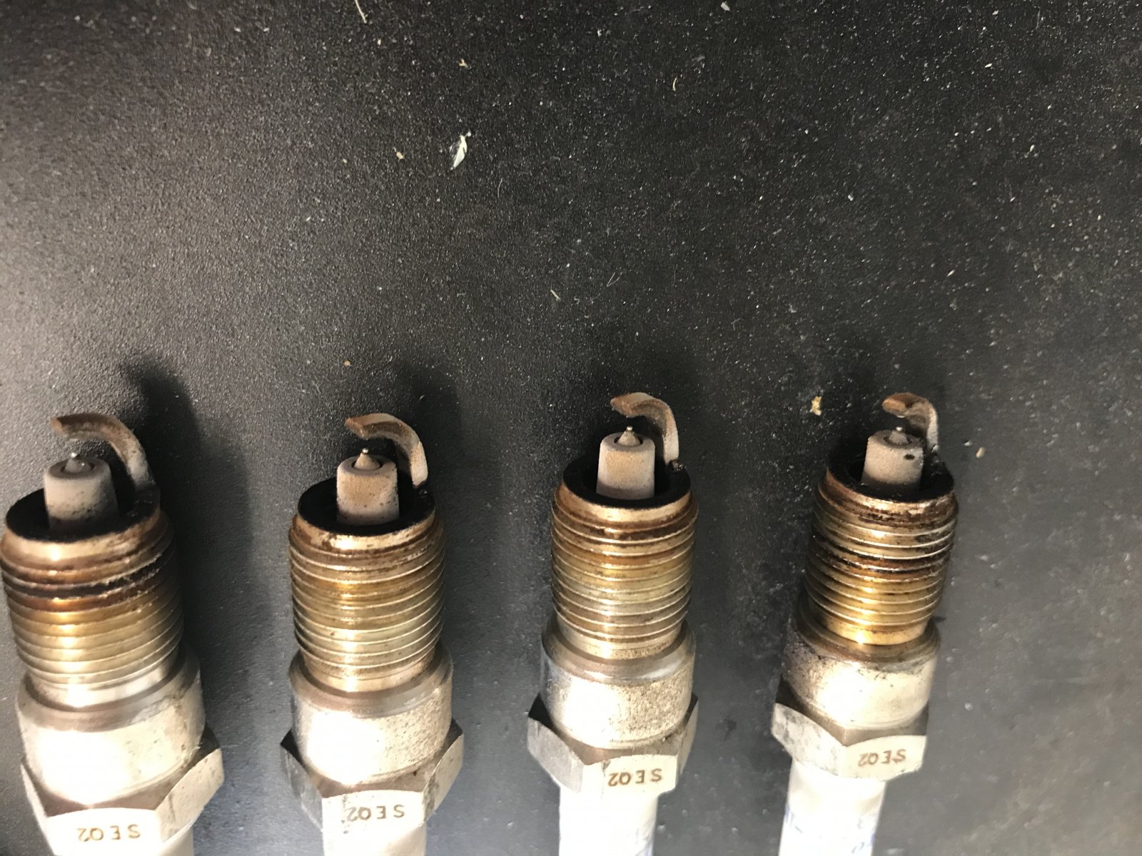

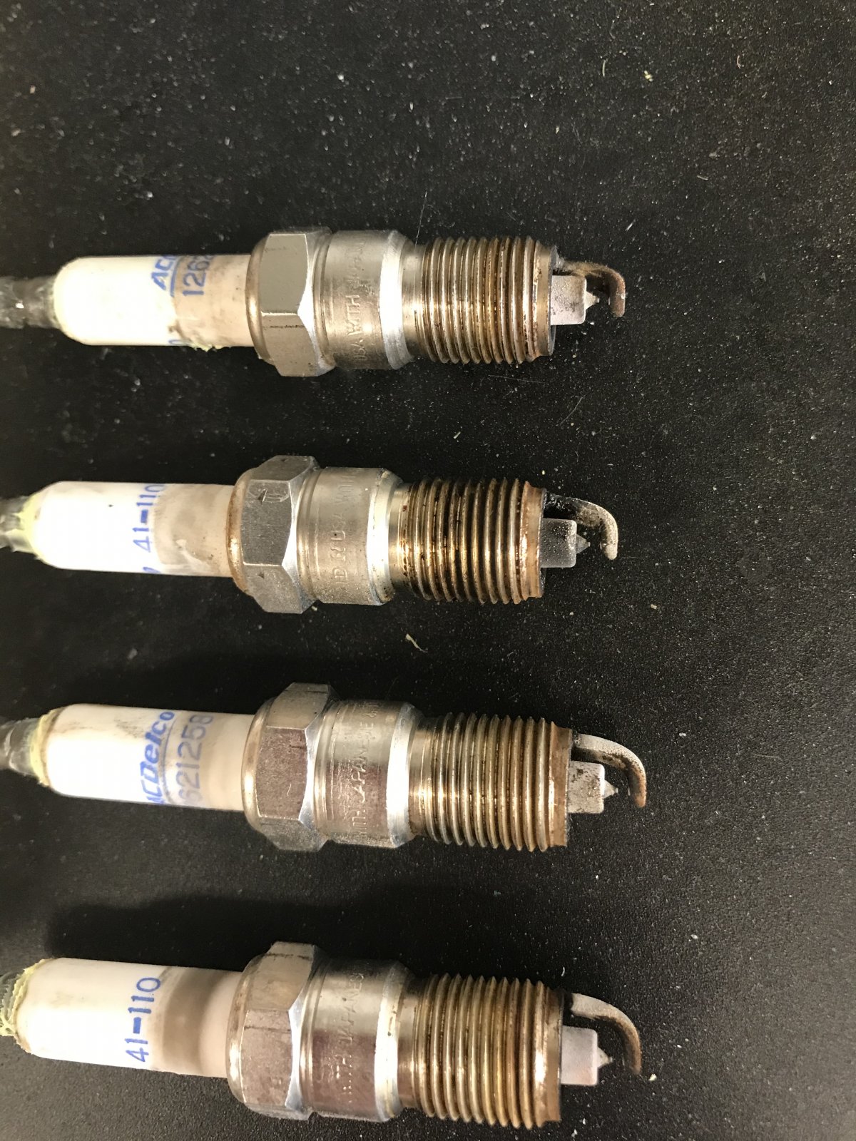

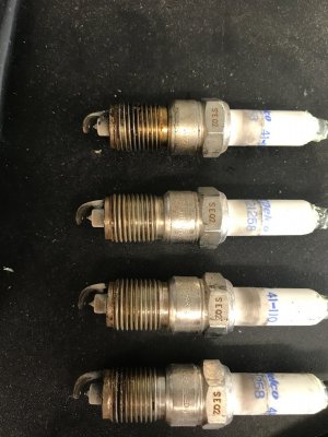

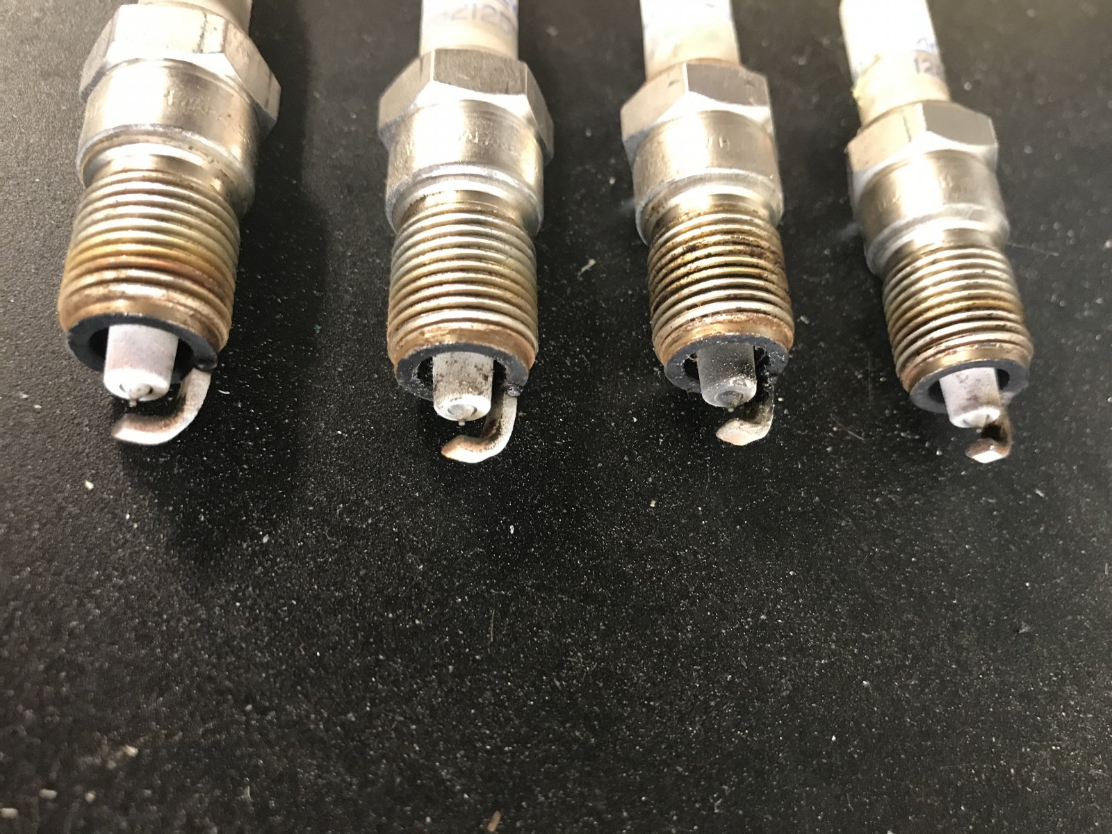

picture of oil and plugs are attached. What’s the thoughts on the look of the plugs? The First plug picture is passenger side in order and second pic is driver side in order. The other two pics are replicated except close up of the spark area.
D89DB2AE-4EE9-4E03-95C8-F6B155D8FB61.jpeg 6181E3D5-CE7E-41B7-87CA-852AA9A4F035.jpeg 0F00390A-F84A-4289-A616-FDD245DE87CA.jpeg C5751F83-306A-430A-99EC-FEA5E6501FC1.jpeg 931B2186-BF09-4AE5-8D7A-206B775ACE84.jpeg
