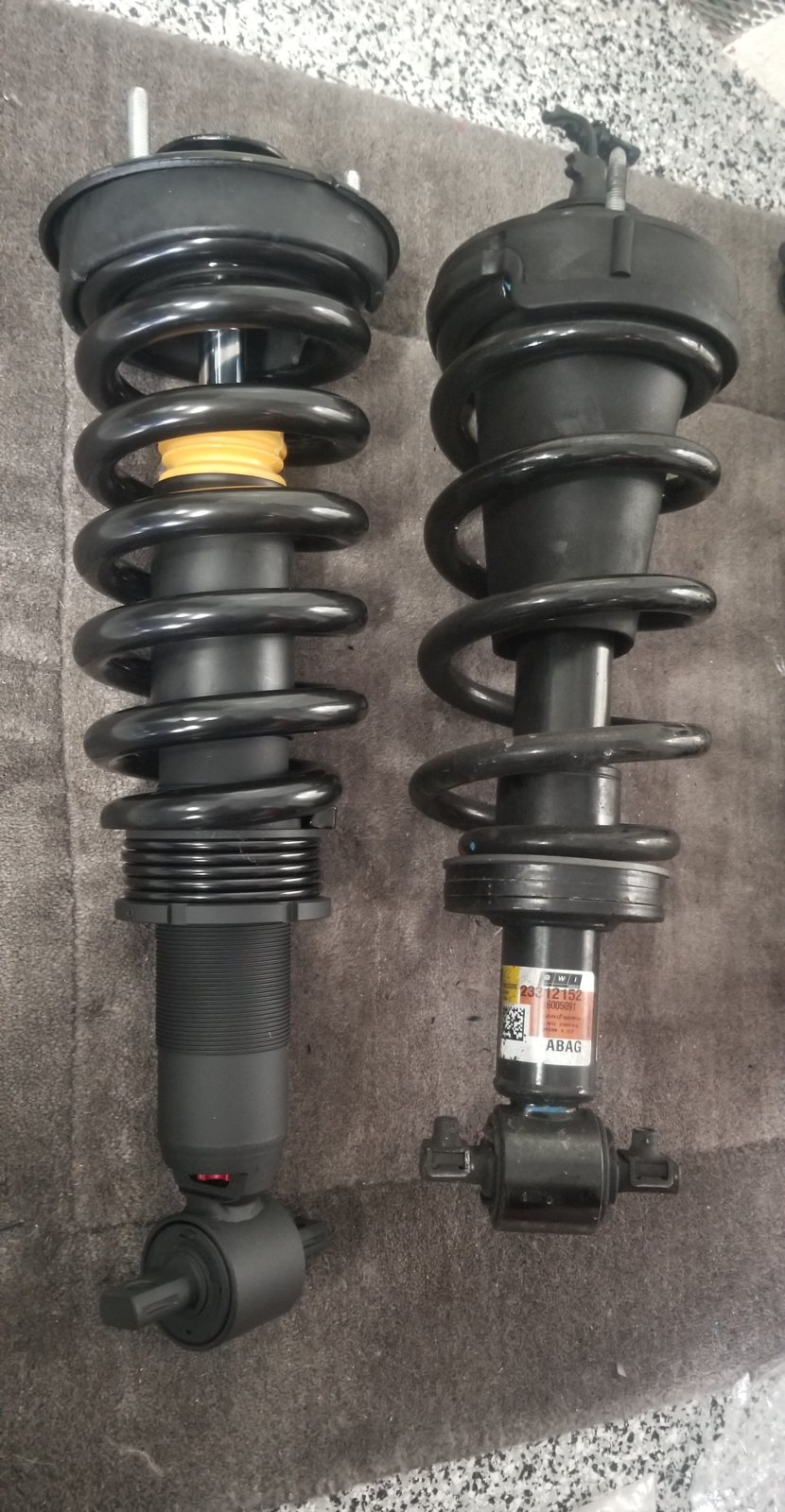

Kw coilover vs the stock magride strut. I adjusted to 11 compression and 7 on rebound. Way better ride. Only thing is that escalade sits about 1.25 inches higher then before. Ill drive about 200 miles and then adjust the height. Its adjustable up to a 3 inch drop
Currently front is only available with rear kit but working with belltech and front i will offer by itself

I like the satin black much better than the original BT color.
not me.... i liked "as finished" look of the KWs, show off them coilovers thru them wheels :Big Laugh:
Tony, are you looking to match an adjustable shock in the rear also?

Belltech is sending me rear shocks in 2 weeks.
