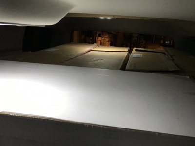

sorry wrong box, have them at the mechanic shop already. So you don't recommend changing them?

Correction, didn't even get them yet. Ordered them last week along with the trays, too much going on at once lol
