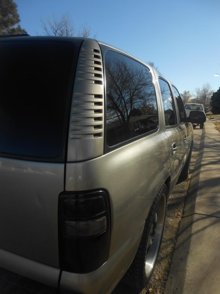

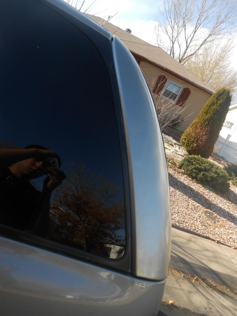

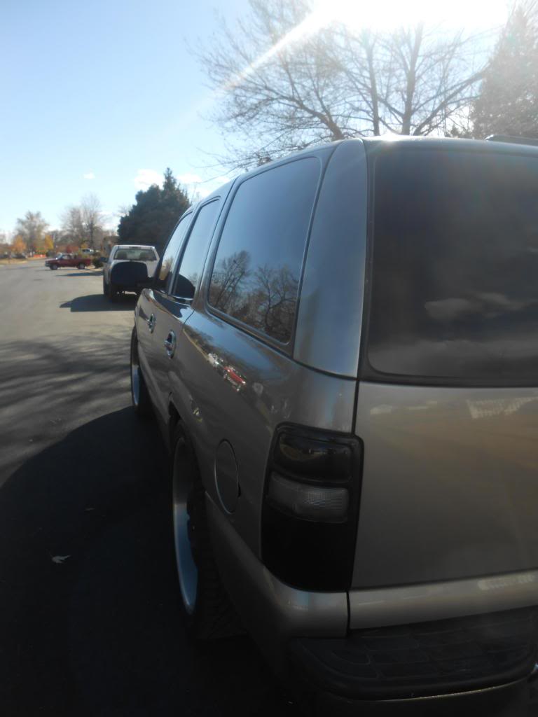

hey guys so i started thinking the other day what ca i do to my tahoe on my own and i thought maybe i can cover the holes on my vent covers and sand em smooth..soo i gave it a try and heres one of them complete i still have to start the other..honestly there not too bad for the price..free..had all the materials already so it couldnt hurt

hey thanks everyone for the compliments now onto how i did it..you will need some body filler for this such as bondo or any others that will harden pretty well..i used an industrial filler that my dad uses at work so that helped me out..now you need to fill in the holes first and take your time on it..after that sand it down with 80 grit sandpaper and add another layer..do this step until you gotten it as smooth as you can it takes patience to do this and dont oversand..when i do the other side il take plenty of pics for you guys
