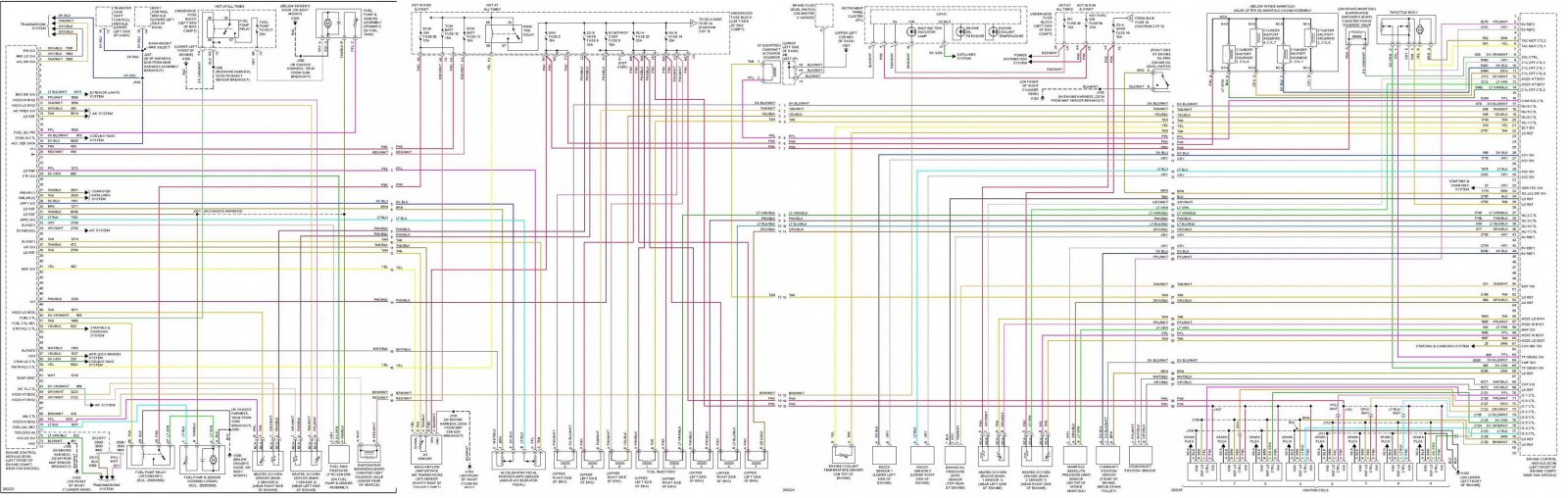

so the engine is installed? im guessing you never opened it up - hence vvt front cover/actuator/position sensor etc?
does it have an E38 pcm? it should all be in there.
i think most people would have ditched the vvt cam before installing the engine, very few people go from not having vvt to putting it in. right now if the pcm doesnt think it has vvt the cam will just stay in its parked position and should run fine.
below should have what youre looking for - not sure if it has to be "activated", or how to do it anyway in the tune.
