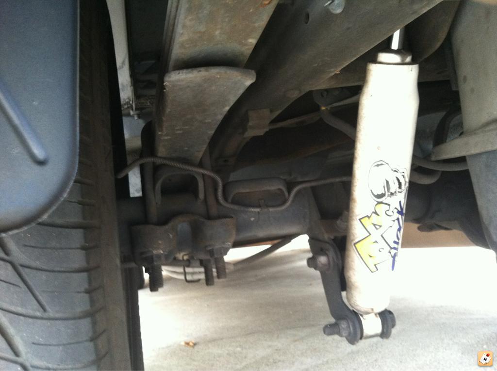

NorcalSS. Here are some pics of my setup. I don't know how low it is. But I want to run 20's with 50 series tires and have no fender gap. Shocks are toxic shocks all the way around. The rear end is super stiff and the front feels like the dash is going to fall off when you hit bumps on the freeway. Maybe I'm just used to the way my 2010 Silverado rode. It had spindles, springs and flip kit.
For this truck I just want a smooth riding truck to sit nice on 20's.

Ok first of all those ride stiff I would get the belltech sp shocks all around. I sell for 230 shipped
in front you can start off with a 3 inch a arm or put stock lowers and use spindle and springs. I just like the djm sojndles with sorings cause rides nice and you dont have the big boxes hanging down.
Looks like 2 inch arms front so you can cut bumostops down and cut spring to get more.
