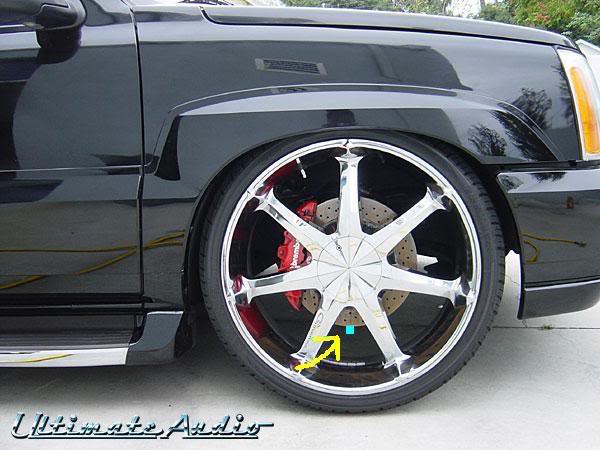

This pic I attached have 26s on. But if you lower your truck on 17s you will have to shave down the bolt with a grinder. VERY easy to do! Just take the wheel off and grind it..
What I did after lowering is put the stock 17" rim on and see where it rubs. You WILL see it! Then use a grinder and shave the bolt until you see clearance, and you will be good to go!
Here is the pic. The light blue color is where the bolt is at! Hope that helps.

no doubt man. its superrrrr close. like less than a quarter away so if your rims bent or anything then it may hit ha.
