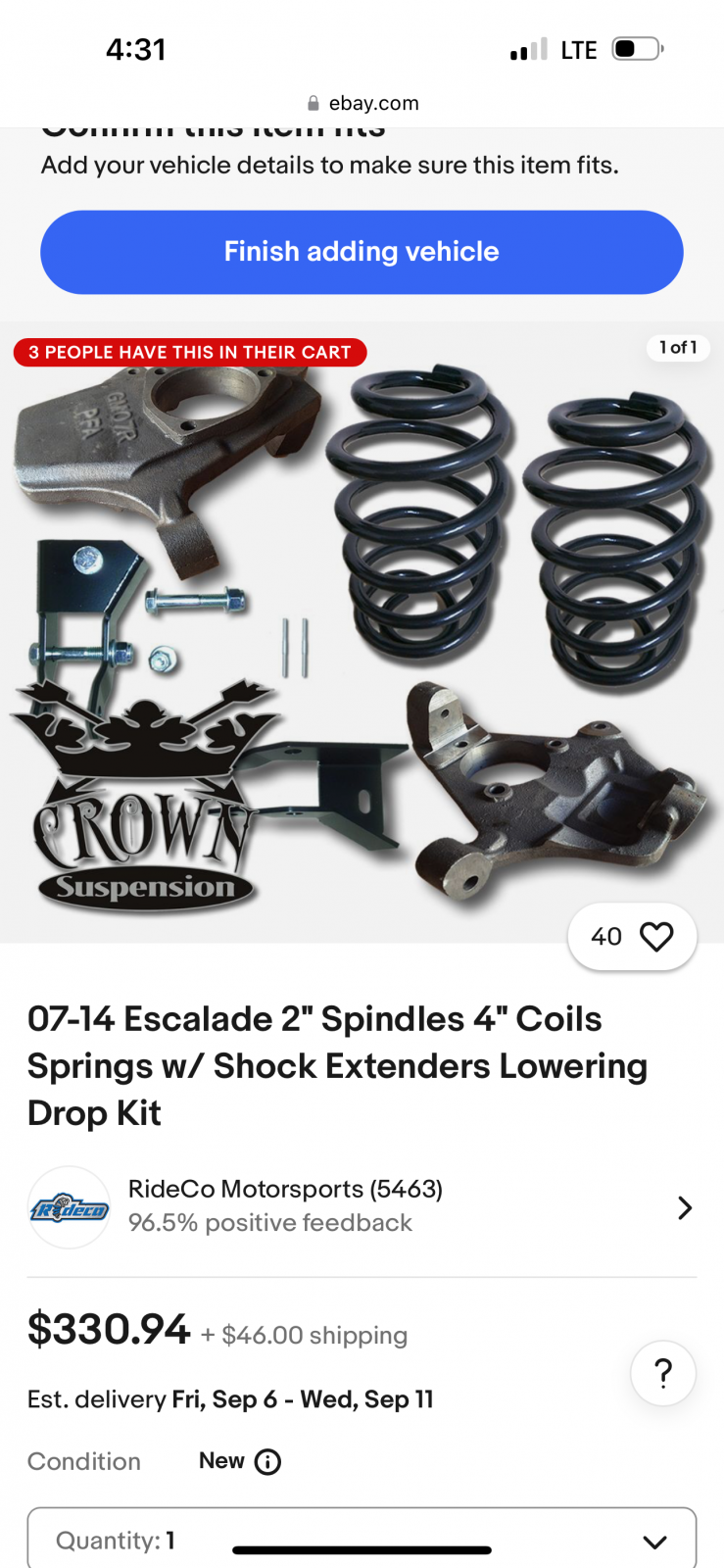

Looking at dropping my Yukon either 2/4 or 3/4 not fully decided yet. But my question, is the belltech or other big known brand kit really any different than the eBay kits ? I’m definitely going drop spindles and don’t care to drop the extra cash on the belltech kit if it’s really a difference in ride quality or parts quality. I’ve owned many belltech kits but never purchased a eBay kit
I’m keeping my autoride shocks and it’s about $300 difference

I don’t have any experience with Crown or Rideco. It looks like they’re saving money on the spindles. Summit has the McGaughy kit for $589. The kit you showed says for an Escalade so check your fit before you order. If the PO didn’t already replace the compressor and shocks be thinking about that.
