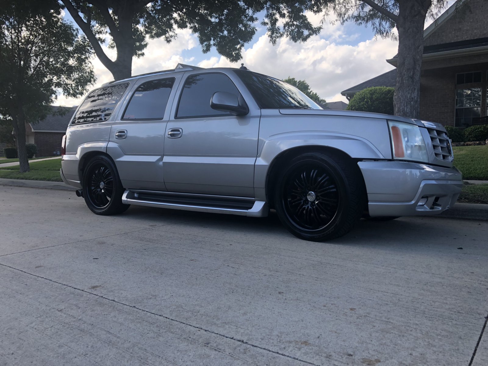

I have the 2/4 drop and still riding w the factory autoride. I have the Beltech 2" spindles and 4" Mcgaughys springs. It rides awesome

The front ones did not change since the spindle relocates the center of the hub, the rear sensors do have to be modified. All you do is shorten the sensor lenght, I don't recall how much. The springs had the instructuions of how much to shorten them.
