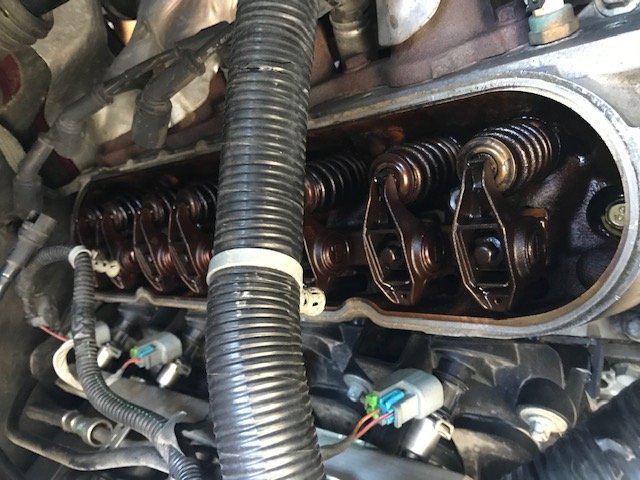

Update: no noticeable improvement after changing from the Fram to an ACDelco oil filter. The fresh synthetic oil seems to have helped the cold start oil pressure a little bit, at least it does not seem to drop below 35 so that should keep the low oil pressure code PO521 from coming back. I guess the old dirty oil and the extreme cold caused a real low pressure on that one day that I remote started it and the PO521 code was set. I have been watching it closely now and it takes it about 5 to 8 minutes idle time to warm up enough to raise the oil pressure up to the normal cold start pressure of +60 then it goes back down to around 40 once fully warmed up. It is to cold to mess with changing out the sending unit/screen right now. That will be the next step though unless it suddenly gets a lot worse. Hopefully I will not have to do another update until around April or May when the weather warms up Hahahaha

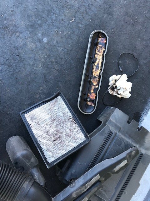

Found another pic of the sludge on the valvetrain, I have no idea what it looks like now as that pic was 60k miles ago and about 3 years hopefully it is a lot better now after regular oil changes. I am super leery of doing a engine flush it would probably plug up everything inside my engine knowing my luck!
