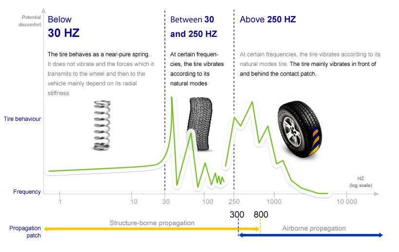

Yesterday in someone else's thread asking about getting an improvement in their sound system, I posted the graph below as an example of how one noise can overpower others. The measurement was taken yesterday in an effort to have some data and a starting point on why my ears ring after even taking a short drive in my 2010. Experience in audio has taught me what various frequencies sound and feel like, and the measurement confirmed my suspicion. I have a lot of LF information being produced by the vehicle. I suffer from tinnitus so I'm especially sensitive to noise. The red line indicates the max level, so the average would be slightly lower. Still bad, though (for my particular ears). This is at 70mph:
At idle the truck is plenty quiet.
So now I'm trying to determine what path to take in order to find a solution. First, I need a root cause. Obviously the problem comes up only when the vehicle is in motion. So that tells me to start with tires and suspension. (outside wind noise isn't at these frequencies). What I don't want to do is go at it without a plan. That's how costs creep up.
