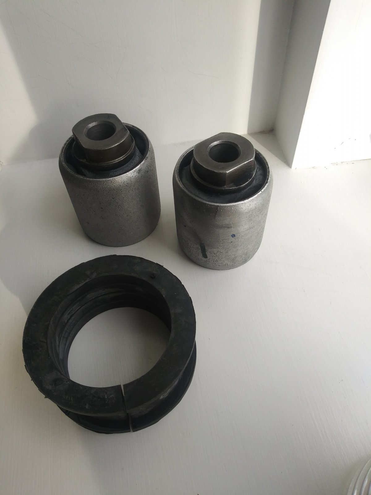

Surprisingly they arrived today haha. This was after they told me I'd receive them Monday.
Well, if anyone is interested, this is what you get and the company that makes them. They are available through that eBay link or they are also available through Amazon. Same price which ever way you go.
I'm trying to figure out the whole pressing situation.
I'd like to get this done asap but I will not rush this and end up screwing it up in the process.
So, bare with me and I'll be back as I progress.

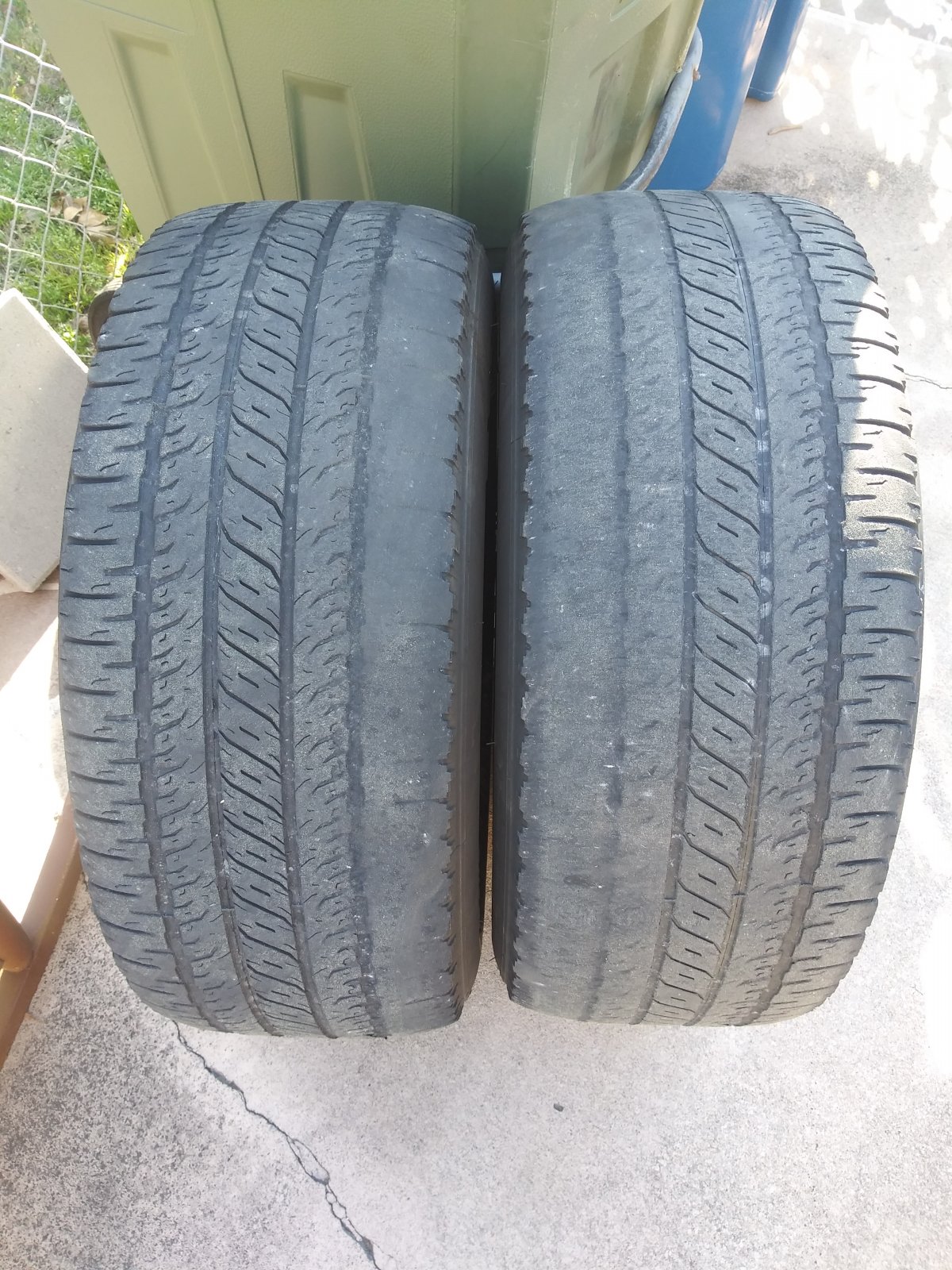

Got it jacked up and wheels off for now.
This is nice.
I'll be calling the shop who did my alignment to discuss some kind of deal. This should have never gotten to this point to begin with. If they do not budge, I'll have to find somewhere else to go.
