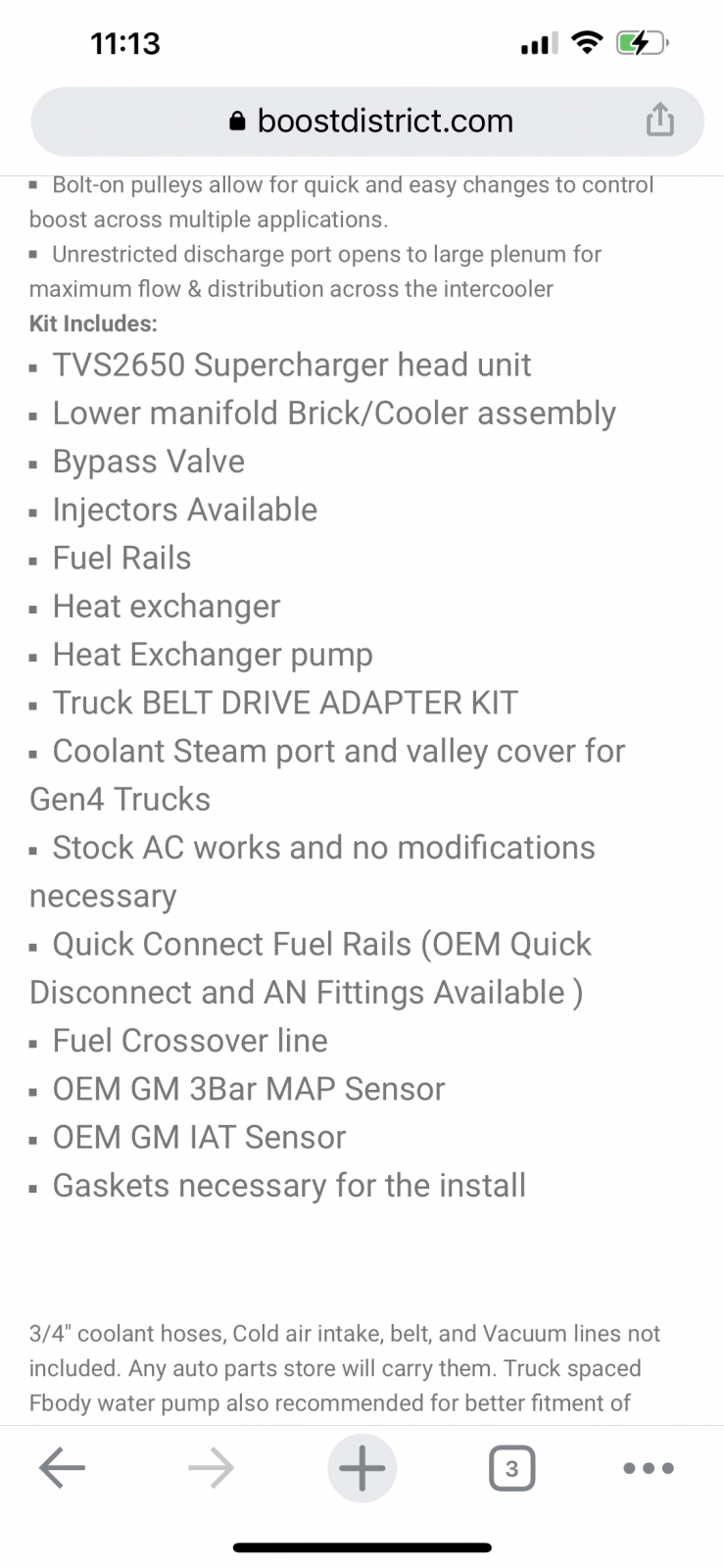

So I’m down to the last decision/purchase I need to make on my upcoming build/upgrades for my 2011 Yukon Denali L94 6.2L.
I’m doing a mild TSP cam swap package and supercharger upgrade. I emailed Magnuson to see if there was any type of retrofit or kit option to get a bigger SC for my L94 since the tvs1900 is their only option currently.
They actually recommended BoostDistrict to me who does a kit using a brand new tvs2650 core. I believe it to be a LSA type kit is using new parts? Just wanting to get some feedback on either SC. Pricing is damn close between both so it’s not a dollars decision for me.
Im kind of leaning towards the tvs1900 for simplicity but I am far from an expert here.
Much appreciate any info and thanks.
Link below to the specific BoostDistrict model
https://boostdistrict.com/collectio...2650-truck-dbw-throttle-body-supercharger-kit
