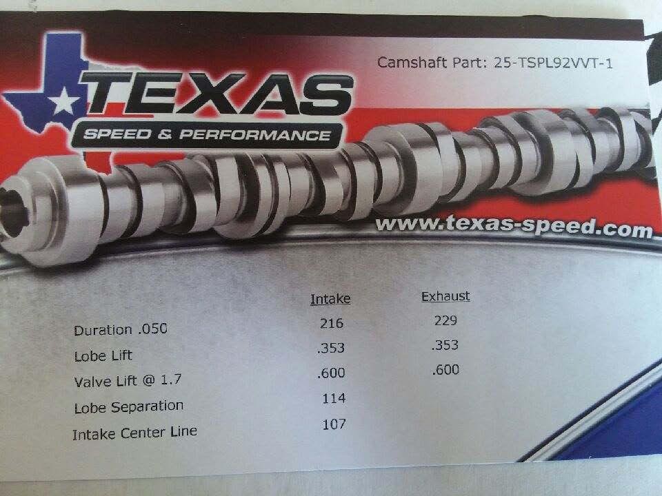

I'm running the TSP VVT stage one and it has a nice lope. To me, this cam is just barely in the realm for a daily driver. I have the L9H 6.2, I love the torque this cam puts out, it never runs out of steam. And after 3500 RPM, it it really flies. I upgraded my springs for the .600 lift.

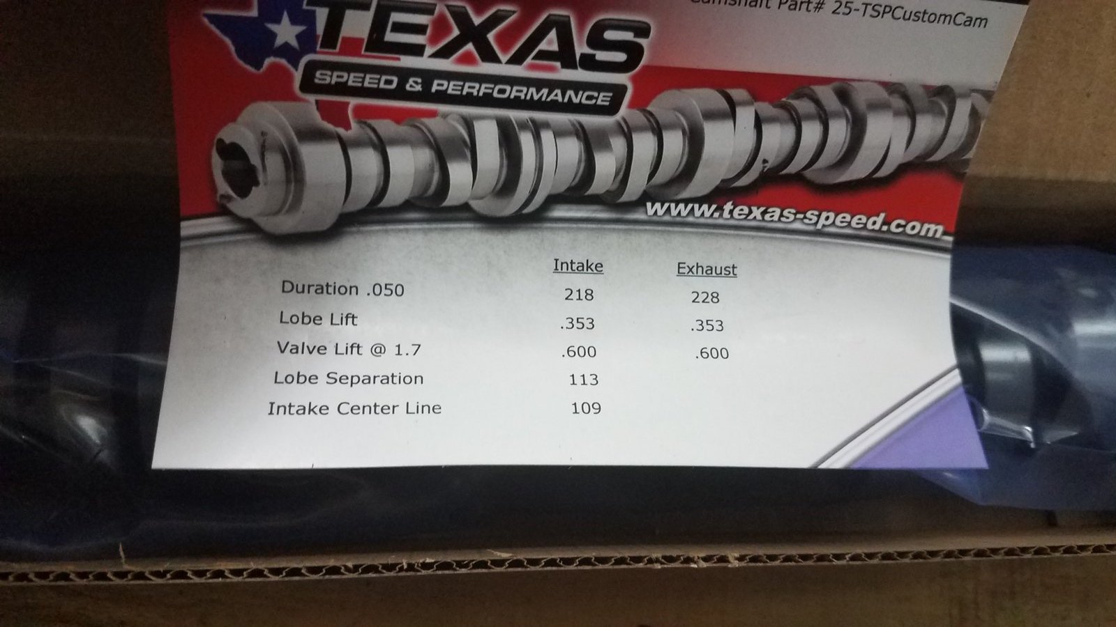

TSP should obviously know better than I, but 227/239 seems like a lot of cam in one of these . i ran a 218/228 iirc vvt cam, .600/.600 lift in mine for 60k+ miles, with upgraded springs.
the only way youre going to stay close to off idle, stock cam power is by increasing the lift
went n found cam card for mine:
