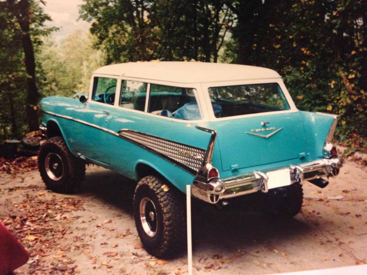

I have shrunkified above vehicle drivetrain/chassis to fit in a '57 chevy wagon ( shortened frame, lowered and pushed back motor, kept dual tanks, dual AC, ect.) and I'm starting the wiring process.

The pic was the wagon before I did a redo with the Yukon. (Drove it like in the pic for 19 years with an old f100 truck four wheel drum chassis)

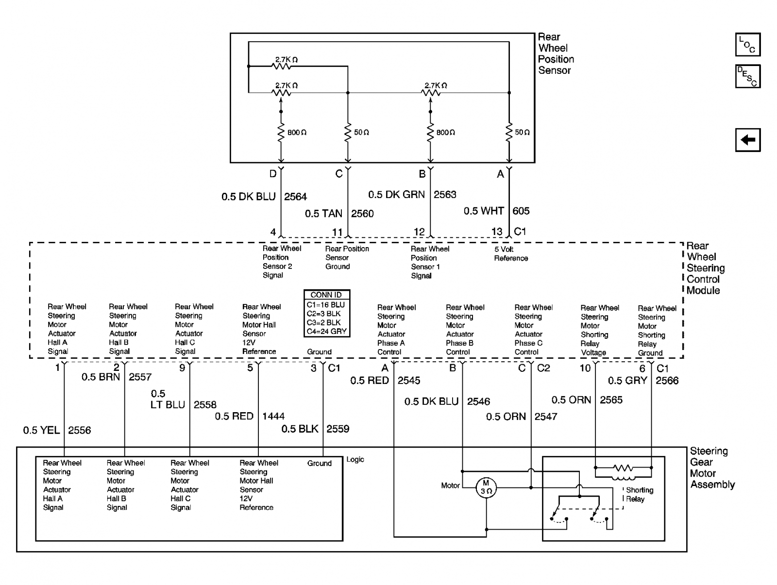

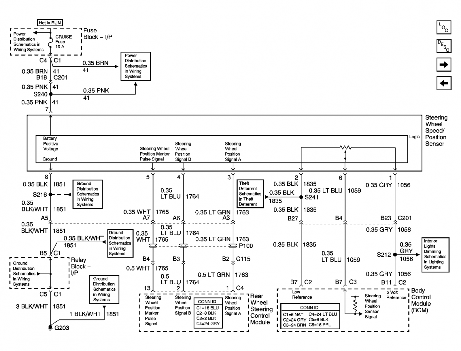

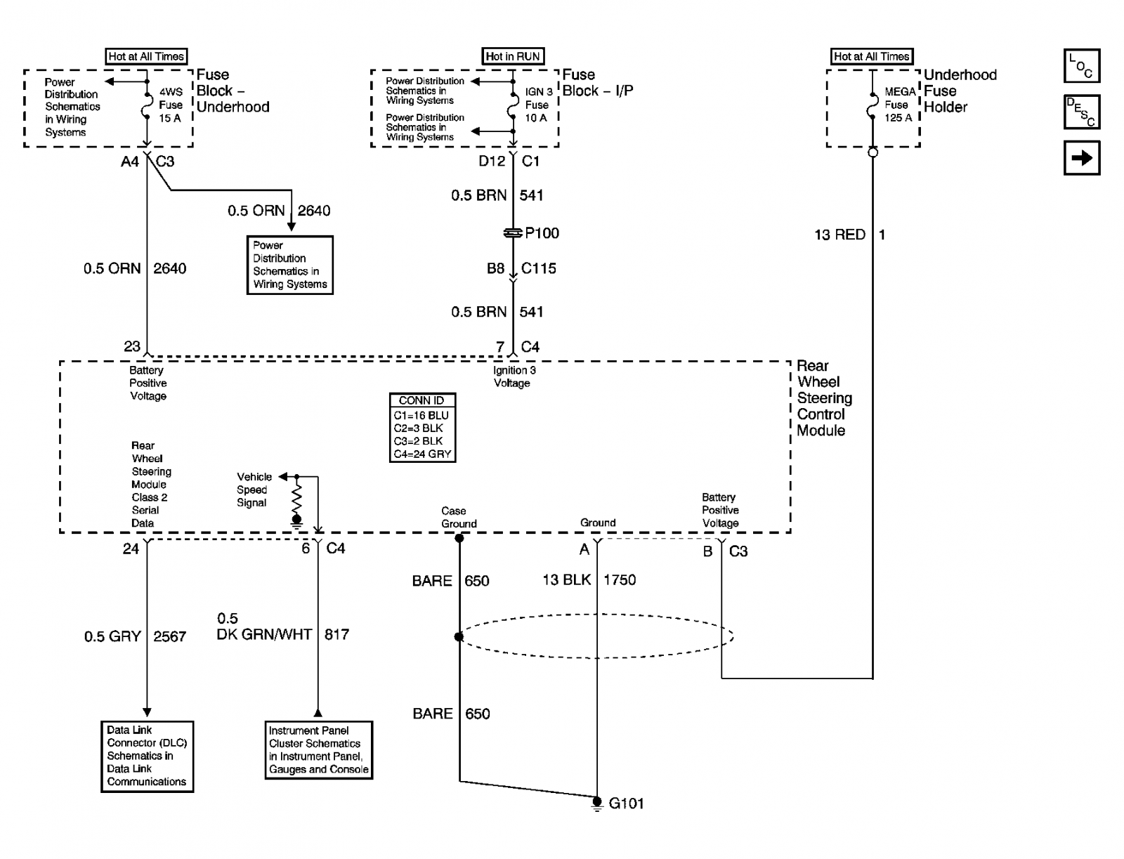

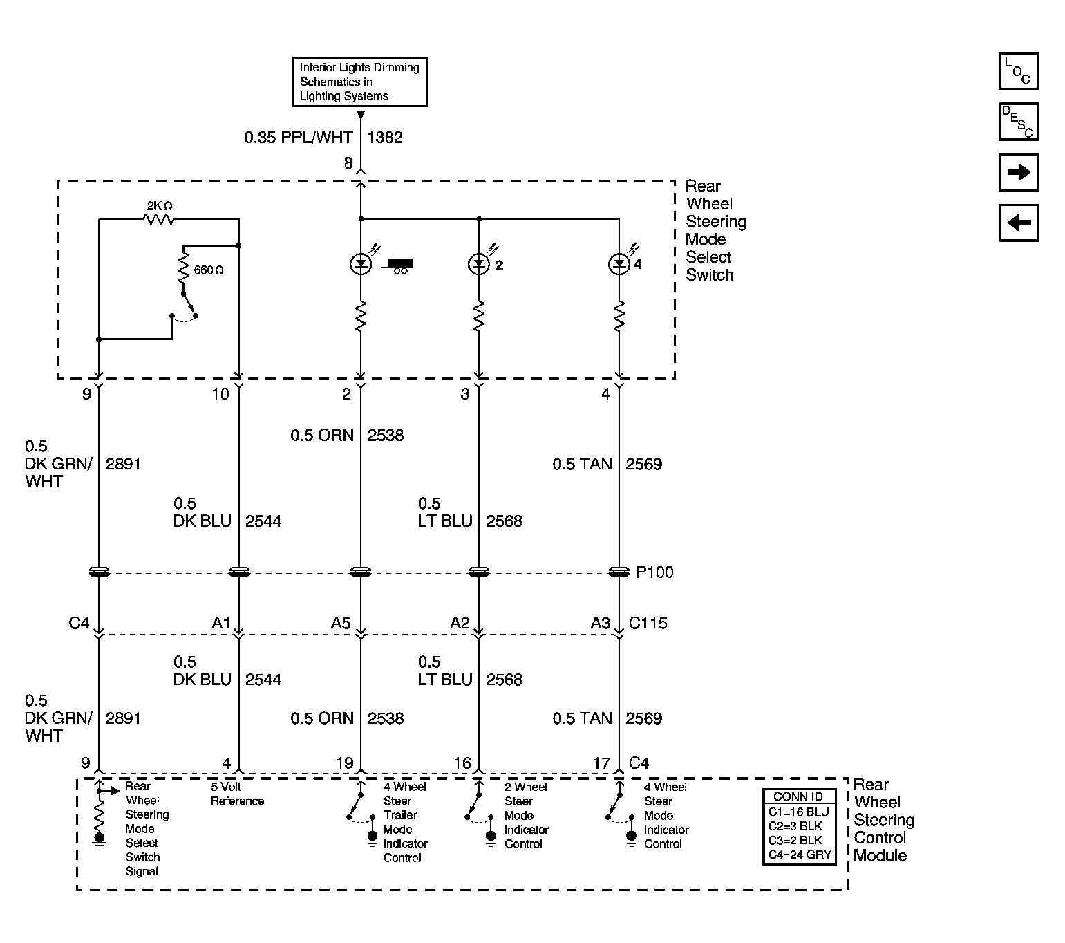

No need, comment what you're looking for and I'll post it for you and anyone else who may need them in the future. @Joe S

Not sure if this is worth a sticky for the QS owners but happy wrenching!

Project Denali,
You must be my guardian angel !
Just last night I got the lions share of the work done to pare down the factory wiring harness to suit my limited needs in the body of my project (not drivetrain yet).
Circuit by circuit I cut out all the stuff I knew I did not need in the body, making sure not to remove anything associated with the NYS option. After I was done I realized I did not encounter much and I worried that maybe I was missing all the NYS stuff.
One look at your images and I freaked out as I had never seen them before !
Frantically I went looking for them in my Service manual and yes indeed I did have them but they were accessed thru the Steering section and not thru the Body Wiring Schematics.
It is with great relief I believe the stripped down harness I have left "should" be functional to go in the project.
I'm wholly uncertain in how the Serial communication Data Link stuff is going to play out, but we'll see.
What A timely response to my inquiry , THANK YOU !!
