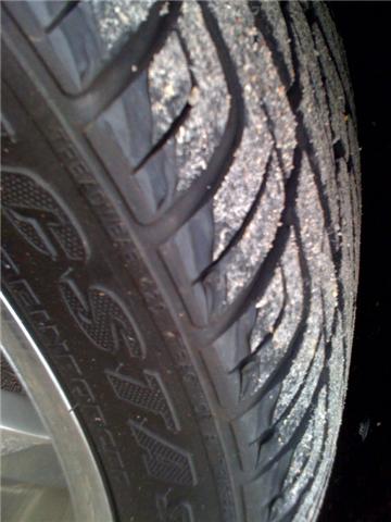

Hey Titanium, was it you that was ripping off the sidewall of your tire due to rubbing?:hands:
Yeah.. notice I said I "tweaked it" to stop the rubbing...
I meant the fender took the rubber off that was causing the problem lol ;)
I took a solid 1/4" off of the very corner or the tire.. all the way around :(
---------- Post added at 02:53 PM ---------- Previous post was at 02:51 PM ----------
and I have pulled the wheel off.. hammered the metal lip up a bit.. modded the plastic fenders.. and called it a day
I've also learned how to slow down and make turns the right way... I rarely hear it rub now.

you're gonna rub at first no matter what.. I had 18's with a beefy tire and they rubbed. You just need to take the time under the truck to make sure the inner plastic fender is cut to the travel of the tire...
where you get in trouble like I did.. is having a big positive offset. look how my tire lines up FLUSH with my fender.. when the suspension compresses.. the tire dosn't quite tuck into the wheel well.. the rubber grabs the fender.. cuts the shit outta the tire.. and pulls the fender out. I've managed to bend mine to where it JUST passes..

Yeah Titanium I was just trying to mess with you!! :mexsmoke:
But I would be pretty mad if I rubbed and took that much rubber off!
