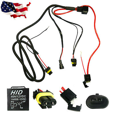

lights>
ballast (excellent quality)
https://www.ebay.com/itm/113685340851
this wiring kit is ok, but change out the relay to a better brand
