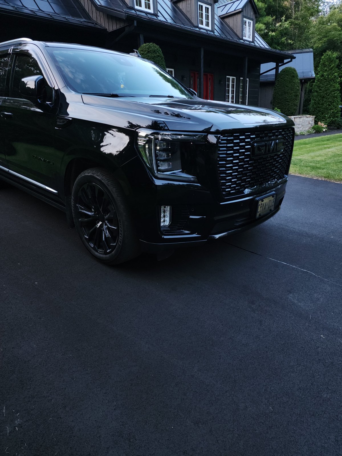

The OEM gloss black 22” wheels are a nice set up. I have them on our 2024 Yukon XL SLT. Put some Michelin Defenders on them and enjoy your smooth as butter ride.
I run the OEM aluminum 20” wheels in the winter with Blizzak DMV-2’s on them.

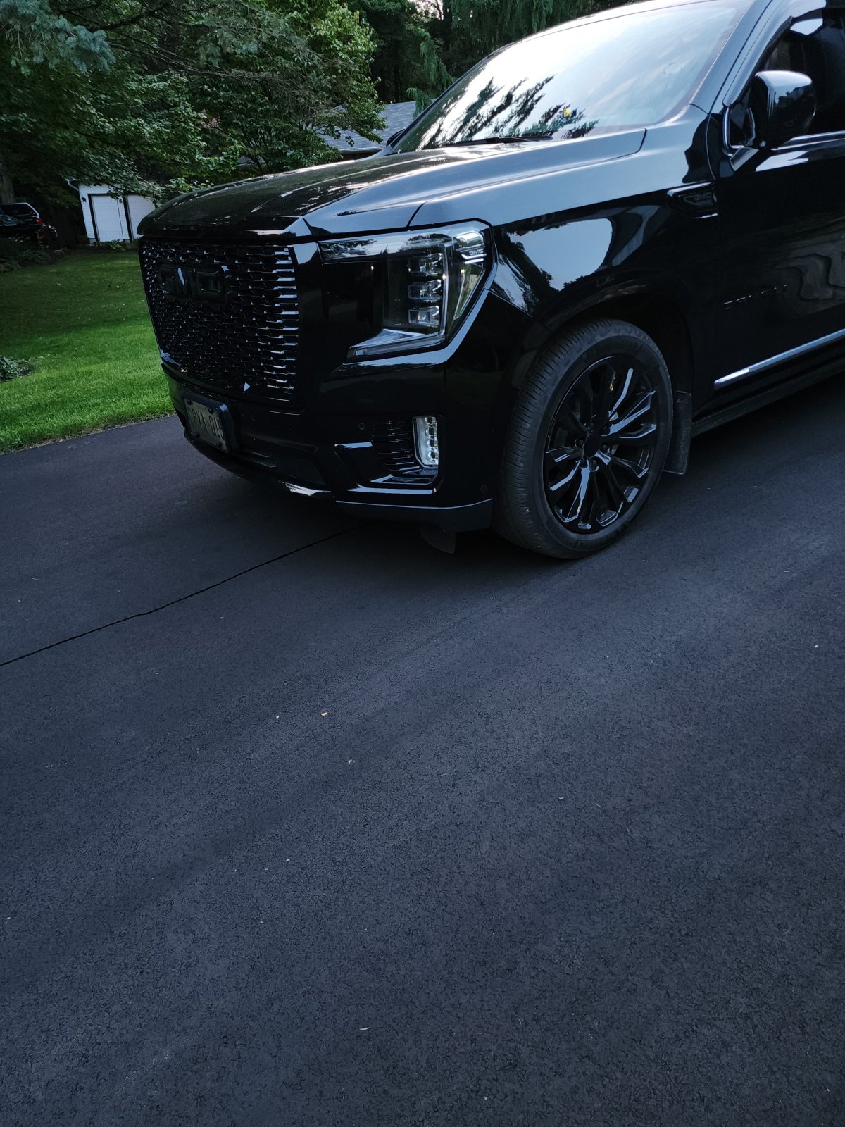

These rims are the stock 20" that I hade powder coated. I think they look great. For winter I have another set of bkack rims
I think im going to risk my lock on 22s (Fuel rims) with a larger tire 285/50/r22. After reading here and having a few private messages wish me luck.

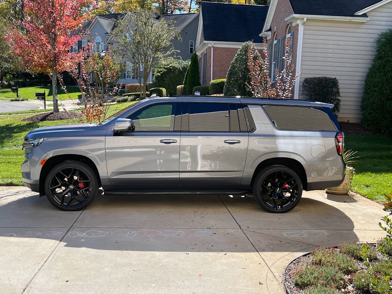

I am guessing from the pic, you are running 285 or 295 35 - 24s as a profile. Your tire size is the problem.
I have had the same 24" wheels on my truck since it had 18k mils on it (107k now) I am running a 305/35 24 to protect the wheels. It is literally only a month ago that I hit a pothole so hard that I need to have a wheel fixed. Otherwise none of them have any bends in them.
Also you could look into what size tire is used on the new 24" wheel coming on the Esky's. That will give you a good idea of what tire size to run as Caddy will not want to be replacing a lot of 24" wheels on leased vehicles for those who purchase the wheel insurance.
If your heart is set on the 20's or 22s, I say go for it. However, its a lot cheaper to just get different tires then replace the wheels. Just my 2¢.
