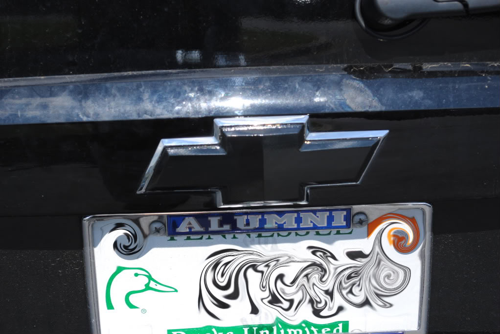

here are some pictures of the completion. the rear didnt turn out like i wanted because some of the material ripped, but i have plenty more and im going to work on it sometime later, but for now it looks fine...
