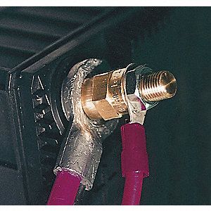

the ground cable could be shot. the wiggle can make em work for a short time. if you see bare copper at either end of the ground replace it. its likely got dry wire and is no longer a good ground.
you can also run another ground cable engine to battery, this way you know the engine is fully grounded. as the starter has no ground, bolting it to the engine is its ground.
you'll need to change the battery bolt in the stock cable to add another cable. one like this works. that pic the plastic shield is off the cable, you push out the stock bolt and push this new one on its place.
