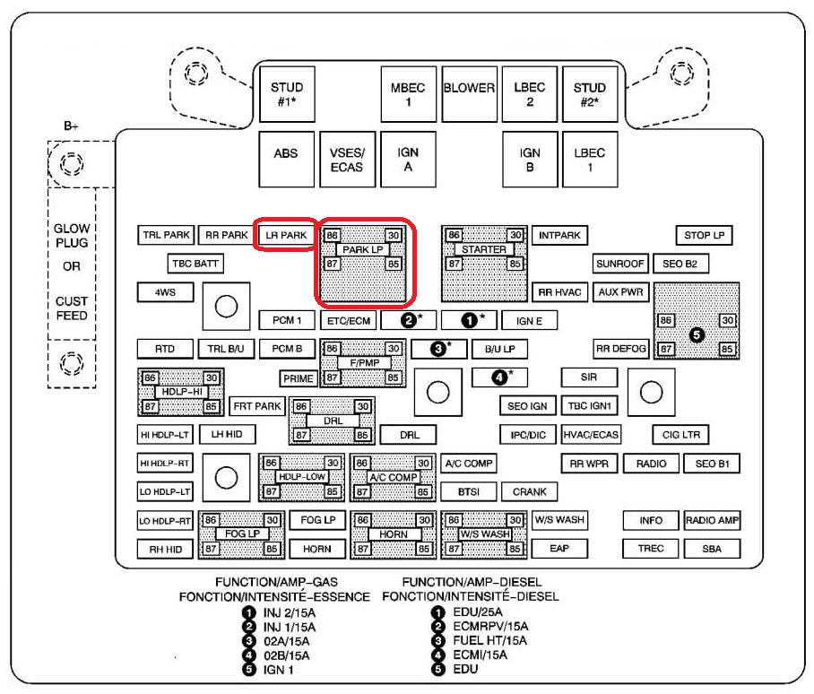

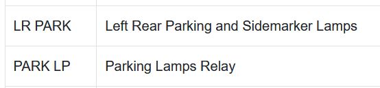

All of my bulbs on my 05 Tahoe work except the driver side rear running light. The brake works though even though they're the same bulb. Does that mean wiring is loose or something like that? I pulled the housing and even changed out the bulb and saw no issues yet no change.
Moderator
16,281
33,654
People's Republic of Colorado
Check the LR park lamp fuse, and if that's good check the relay next to it. Check voltage (+ & -) at the bulb connector. Download the owner's manual.
30,514
47,934
also try cleaning the metal contacts where the bulb goes in, get a small piece of sandpaper or a small flathead screwdriver and scuff the metal tabs, overtime the buildup can make a poor electrical contact, do it even IF IT LOOKS OK. sometimes the buildup is invisible to the eye.
perhaps even give it a little twist from the backside so the metal tab is making a better contact with the bulb legs.
