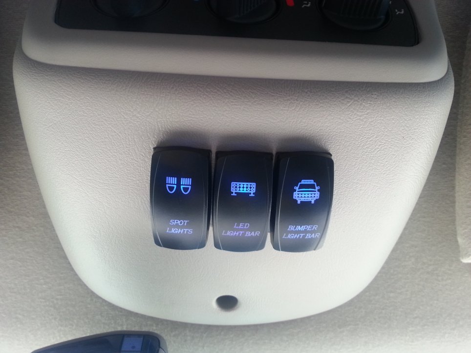

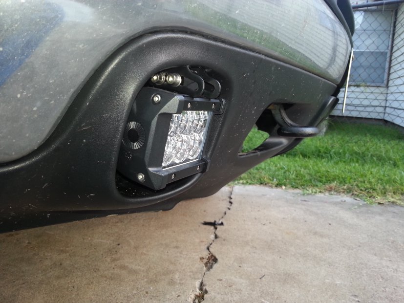

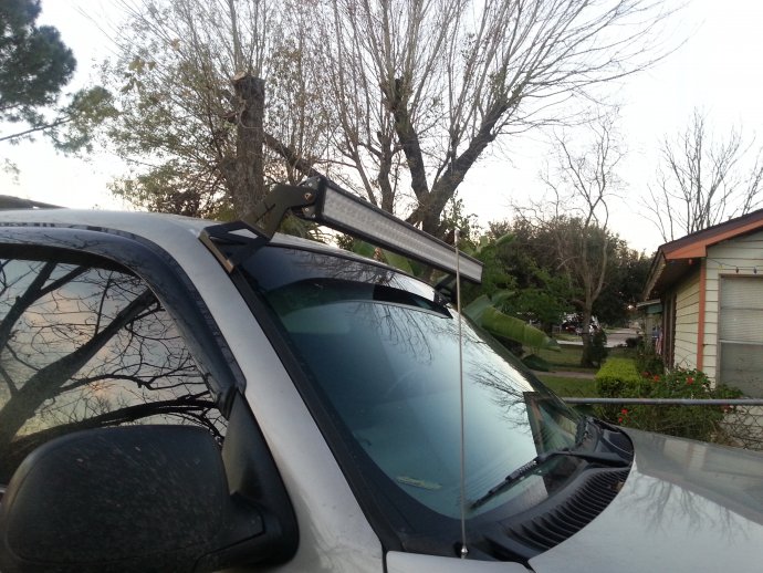

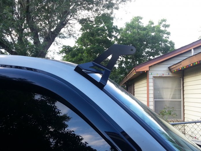

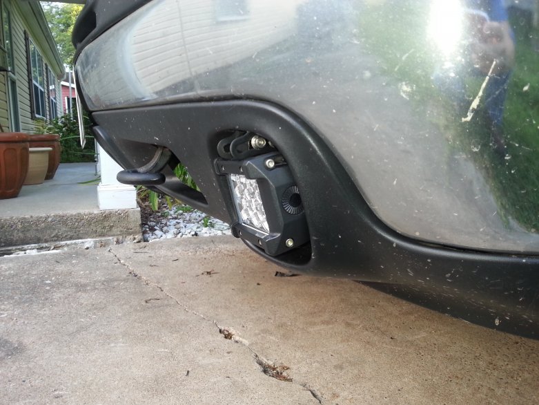

I've got a 52" mounted up top and 4" led fogs mounted in a Z71 valence. No issues with either one. I have the fogs connected to the factory wires and work off the original fog light switch or an aftermarket one I put so I turn them on whenever. The brackets for my 52" I got off ebay for $85 bucks and they've worked fine for me. Easy install and they seem to be pretty secure, 6 screws on each side. I mounted my switches on the overhead console. Nice tahoe by the way and welcome to the site!

I got the 4" led lights off ebay, like $40/pr, same for the brackets. Got those off ebay for like $85. The ones I got were listed for both the 50" and 52". Once they're mounted to the vehicle they can be bent inward to the light, I had to do that to mine but only about an inch or so. You can pick up a new overhead console for cheap and replace your broken one.
